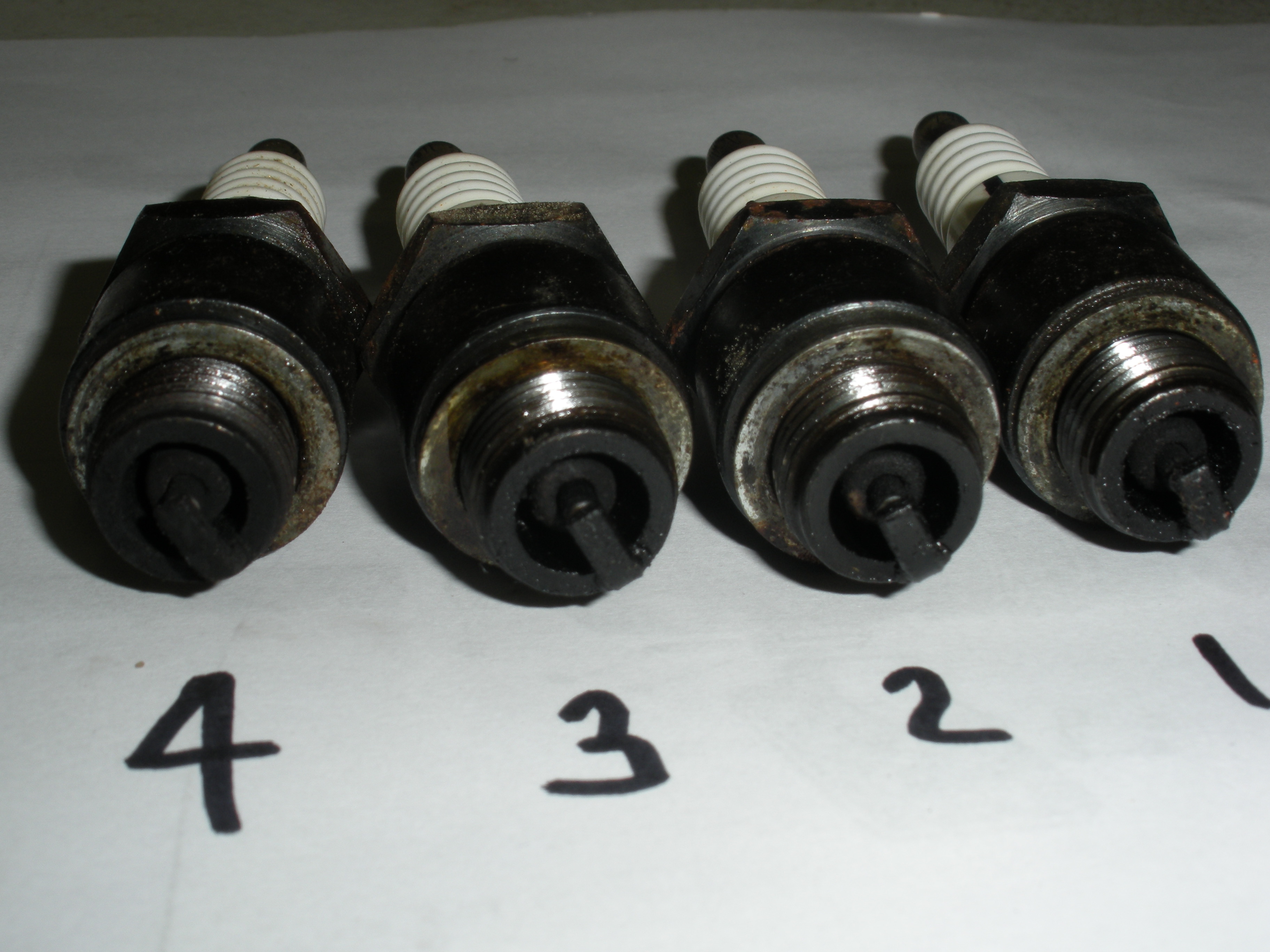

1948 C wide front. I pulled the plugs and took a group picture.
Tractor starts right up, but after getting hot it starts smoking.
Two years ago it (mostly) stopped smoking, now is back to smoking.
Worse at lower rpm. The last time I checked compression, it was
100-105.
I would like opinions on what the plugs tell me.
It is full size image so you can zoom around.
Magneto. MS tsx154 carb.

What color is the smoke? Blue smoke comes from burning oil, black smoke from having too rich a mixture from the carburetor. Oil gets burned when the piston rings are worn and not sealing well or the intake valve stems are worn and not sealed. Rich mixture comes from multiple possible sources. An air hose from air cleaner to carburetor with a loose lining when warm will act like a choke. A choke cable not anchored near the carburetor can let the choke close from vacuum and intake air flow. A dirty air cleaner can begin to plug and restrict air into the carburetor. Mud dauber's or wasp nests in the air intake plumbing restrict air flow like a partially closed choke.
The main jet adjustment in the carburetor can be set rich. On my gas MF135 I found it plowed better when running slightly rich at full throttle. In gas power aircraft when wanting full power for take off they run full rich, then when at cruising altitude the pilot has a knob that can lean the mixture considerably for significantly improved fuel economy. Besides exhaust gas temperature (running lean makes for hot exhaust) their is a fuel flow gauge to show the effect of the mixture adjustment.

OK, those plugs look real OILY to me ( shiny black = oil ),probably bluish smoke out the stack....reminds me of 'Paris' here.... it needs rings and valve seals and some TLC.
I've got a B&S in a rider...same thing, start great ,runs OK, then 10-15 minutes later it's killing all the skeeters in the field ! Rings I figure....

Oil gets thinner as it warms up. Thinner oil can sneak past the rings and valve guides. You can try thicker oil as a stopgap in the summer months. 20w-50 perhaps.

Pictures of plugs tell little to a person that knows nothing about what the tractor is doing or how long the plugs  have been in service but things look pretty oily and rich. Tractors that are started and stopped a lot and just putter around are not going to have brown plug colors  as will one that is warmed up and worked, in good shape mechanically and in good state of tune..  Id guess you have both an oiling issue and a rich condition but that's just a guess.  Knowing what color the smoke is would help.

Those plugs are the Autolite 295. I bet they have about just 12 hours operating time.
The smoke is not black. It looks whitish or light grey. I really can't see blue in there.
The coolant is steady in level, green and clean, I see no oil on top, even after months of resting.
Same with the oil level it, is not rising. Last year I changed the oil cold after it was sitting all winter. I wanted to see if the first fluid out would be water. It was not, just oil.
I remember my dad would pull the head and grind in the valves. The original tank was rusty and he would be fiddling with the fuel bowl, take apart the carb, blow out junk.
I had the carb rebuilt and an inline fuel filter installed. And the current tank is from a CA, less rusty and lined. He used to change plugs often. The original FB magneto was replaced with American Bosch, I have a new Wico on it now.
So with rebuilt carb and new magneto, it starts with just a stab of the starter rod.
 I have to let off the choke pretty quickly or it will stumble and make black smoke.
The choke rod is flimsy but works.
Hard to tell which parts are original or not. But one issue is the carb air inlet does not exactly match (concentric) to the oil filter outlet. I would have to add about 1/4" spacer
between the carb and intake manifold to get them lined up. So the mismatch is bridged
awkwardly with the intake hose. The oil filter is bolted to the block with 4 bolts, I guess that has to be original and it ain't going anywhere.
Was the Marvel tsx154 offered on the 1948 C? If yes, is there a 1/4" or so thick spacer I am missing? Or maybe a different oil filter housing for Zenith vs MS carbs.
My guess is the intake valves guides are leaking as the primary smoke issue. But the engine is worn, I have bad crankshaft end play for one thing. 70 years old now.
Thanks for you help.

Brian in my opinion which is always wrong as far as the wife is concerned, I would run it with heavier oil this summer and then consider a rebuild next winter.  I would also try leaning it out some this summer, maybe a quarter or half turn on the main jet at a time and see if things improve.

A cold running engine will foul the plugs even when everything else is correct. If it doesn't  have, put a 195 degree thermostat in it and get the engine hot. A hot engine will like a leaner carburetor setting. A leaner mixture will burn cleaner.

If it were mine, I would make it work(plowing would be WORK) with some Sea Foam in the gas for at least several hours and go to the next hotter plug. My CA(which had sat in the shed at Dad's for 10 years) started fouling #1 plug after just a few hours of mowing with the L59. I went to a hotter plug and ran some Sea Foam in it and mowed for 2 years without a hickup.

I replaced the plugs with a set of NGK B4. However I don't know if the B4 is considered
hotter of colder than the Autolite 295.
The Marvel Schebler TSX154 I have is the fixed jet (Type A). So no opportunity to
adjust mixture. In general, when a carb starts to accumulate dirt at the main jet/needle, it goes towards a lean mixture?  How about a fixed jet?  I can see dirt at the float needle causing either rich or lean condition. It is now 7 1/2 years since it was worked on, by Denny's carb shop, if I remember correct. That could be long enough for the E10 gas
to start crapping up the carb?

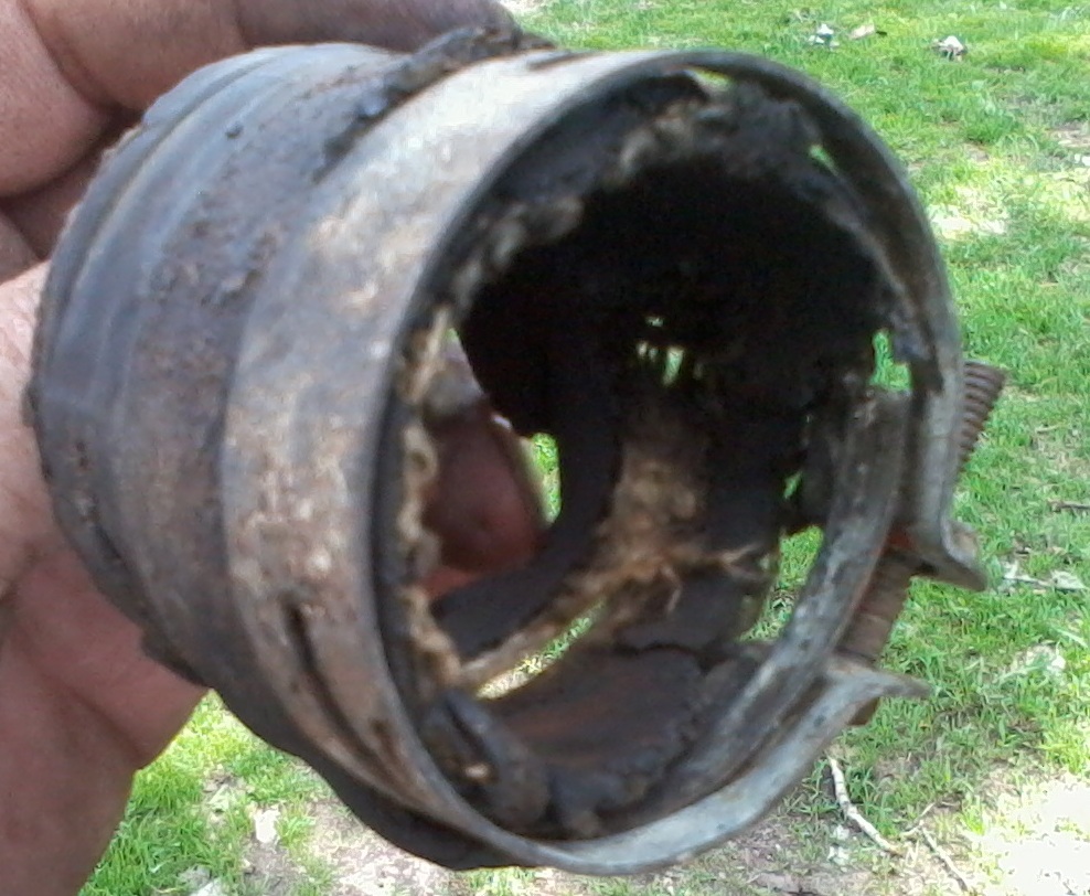

When you see plugs like these...
and then discover a intake hose looking like this....
You can guess what caused the plugs to look like they do....
 But I think your plugs look like just to rich of fuel setting.
 Check your jet number and see if it is the correct jet and then see if somebody reamed it out or got high altitude jet in it....

Wow those plugs look even worse than mine, yuk.
Air filter hose, yes I seem to have an issue surrounding my air filter hose setup.
Maybe I will build a spacer before whacking away metal. Or look for dimensions
on MS carbs. Could I have a Frankenstein carburetor. Something is not right.
