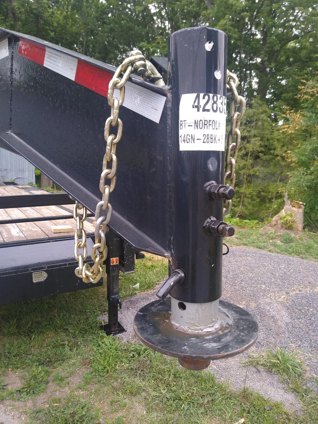

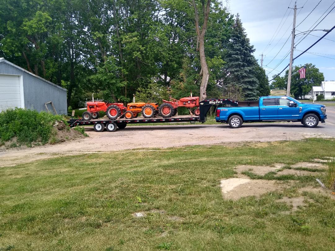

I recently bought a used 33' 14K gooseneck deckover trailer (28' flat and 5' beavertail). We also have a fifth wheel camper with a CURT 24K puck fifth wheel hitch.
I hated the gooseneck hitch. My truck (Ford F-350) is tall enough that it required me climbing into the truck box every time I hooked or unhooked.
I had a fifth wheel pin from a stock trailer I had several years ago, so I decided to change the gooseneck hitch to the fifth wheel pin hitch. The fifth wheel arrangement is a little higher than the gooseneck was. I just measured the deck height at the center of the axles, which is 32.5 inches. At the very front of the trailer, the deck height is 34.75 inches for a difference of 2.25 inches. Both of these measurements were with the trailer empty.
I am thinking that loaded (2 or 3 tractors), the back of the truck will drop a couple inches. It doesn't look like the front is too high. Do you think the front being a little high will be a problem?

2 1/4 inches over that many feet doesn't seem like a problem, I've seen a lot worse than that going down the road.  But maybe someone knows some exact rules or whatever.

To get the weight transfer the trailer will have to be overloaded to the front, not a good choice.  How did you afix the pin insert?  Did you install it as far inside the neck tube as possible?  On my own Gooseneck I had to adjust the hitch when bought as would not ride flat to any degree of sensible.

WF, you want the front higher but not a large amount above "level".
I haul for a living and just turned 150K miles on a new 30' flat deck PJ gooseneck that went on the road early July of last year.
I sometimes return from checking in on a load pickup to find someone has already placed the load on my trailer and 99% of the time it has to be moved for the reasons you mention. I am very specific on what/where weight is placed as it not only affects the handling of the truck (steer axle light for handling) but also having "enough" just forward of center on my trailer axles. Rule of thumb for me is getting enough on rear of truck without overloading truck axle, plus trying to keep both trailer axles in play to do their job. (I also have to scale at weigh stations so watch each axle weight)
Newer gooseneck trailers are now being made with holes for a good size pin through the telescoping hitch sleeve, and the old style jam nuts are still included.
My 4WD Ram "Highboy" sits pretty high on stock rims with TransForce tires and believe me, having oil changes done on the road with an Easy Turn pan valve makes it where I do not even drop my trailer most times as they can slide right under the truck to drop my oil. Good for me as I also hate climbing up into the bed to hitch/unhook.
Factory coil springs lasted about 90 days so I installed a Firestone Air Ride System and have never run over 45# in it as it get's down to how the trailer is loaded as mentioned.
My loads vary, sometimes all of my 30' deck is used and sometimes I will have a 10K load that is only 8' in length so it can get critical when my trips are sometimes 2-3 days long.
Empty, my trailer sits higher in the front by about 2  to 2-1/2" so I estimate the position of the load as above, then adjust the air bags after loading to "level up".
I have hauled tractors, hay, etc. for years with the 21' PJ farm trailer and just used a tape measure at the bottom of the truck bumper before loading and believe me, a tractor being moved forward or backwards on the trailer just 4" can make all the difference in the world.
You will be fine with front of trailer slightly higher, just adjust how far forward the weight is loaded. If filling the trailer, you can always adjust the trailer neck for that heavy load, tape measure will tell the tale. And don't forget the tires . . . . .

Tim, my pin did have the predrilled holes. I wasn't able to get the pin in the bottom hole, but the measurements were done with it in the second hole. The silver at the bottom of the pin is antiseize.
I think it sits ok loaded. It goes down the road nice.

WF, curious am I...
what are the square headed bolts, and nuts on the  'king post ?) for ??

You can adjust the height/ length of the hitch, my Anderson conversion has the same set up.

So is My gooseneck, No cross pin on mine either just the square headed lock bolts.

Jam bolts so you can tighten everything up. Without the pin though some have slid down. Problem with leveling trailers as has been talked about before, especially on some newer trucks that sit up higher, is when you try to level the trailer you get closer to your tailgate and sides.
