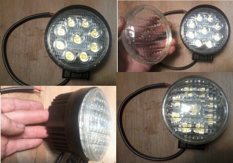

So I got to thinking that these LED lights look goofie and started experimenting how to put an old glass lens on them... So I cut the glass reflector back off of the lens of a sealed beam light, and that almost fits inside the LED rim.
  But it is to thick yet to look decent. Thus on my next try, I will try cutting the lens off at the groove where it dimples in on the very edge of the light element, (if I am so lucky not to break it) and then sand off the edge about .1 inches and put some clear silicon around the edge for glue and push into housing... Hopefully it will look nice. Next question is, will they work good at night with the glass in front?  We will find out some dayErmm ah ... some night.Wink  LOL
  This lens above will work in another application where it is mounted back in the light bucket on the tractor and the Led snugged up from the back side against it.
 Well, this being my first try to retain some resemblance of the original look with the LED lights, there might be a chance it won't look to bad with the lens on front and just having the led original back left as it is. They do not seem to get warm.
  I do have a few of these LED lights where the plastic lens has been exposed to the elements for several years, and they do discolor, Maybe with the glass lens in front, the led lens won't discolor so fast...?  Looked to see if there was a chance to remove the plastic lense from the led but appears that is all made in one unit and only about 1/2 inch thick total.

your light pattern is going to be crap putting another lens in front of the led
CrestonM View Drop Down
Joined: 08 Sep 2014
Points: 8459
Post Options Post Options   Thanks (0) Thanks(0)   Quote CrestonM Quote  Post ReplyReply Direct Link To This Post Posted: 16 May 2019 at 9:30am
Larsen did it.
coggonobrien View Drop Down
Joined: 14 Nov 2010
Location: Eastern Iowa
Points: 1867
Post Options Post Options   Thanks (0) Thanks(0)   Quote coggonobrien Quote  Post ReplyReply Direct Link To This Post Posted: 16 May 2019 at 11:25am
Larsen is not running 2 lenses
Larsen is not using a lense designed for the light of a single pint incandescent to distribute the light of multiple led's.
Don't go into engineering, it won't be successful.
