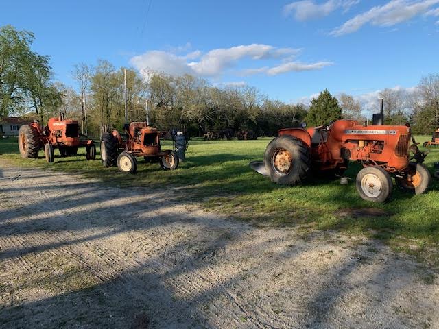

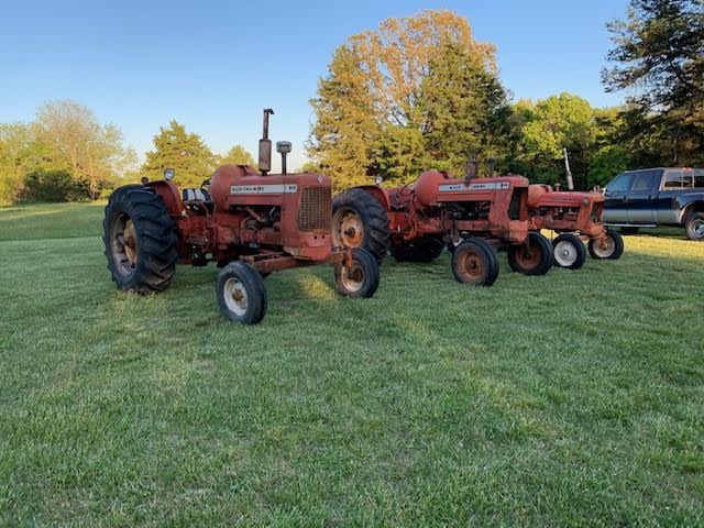

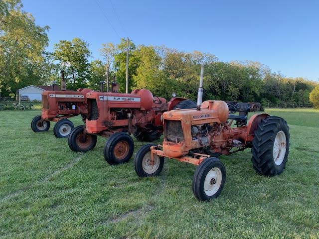

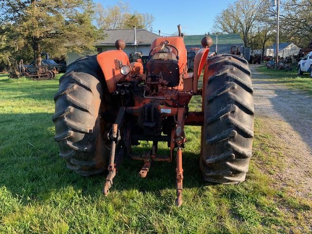

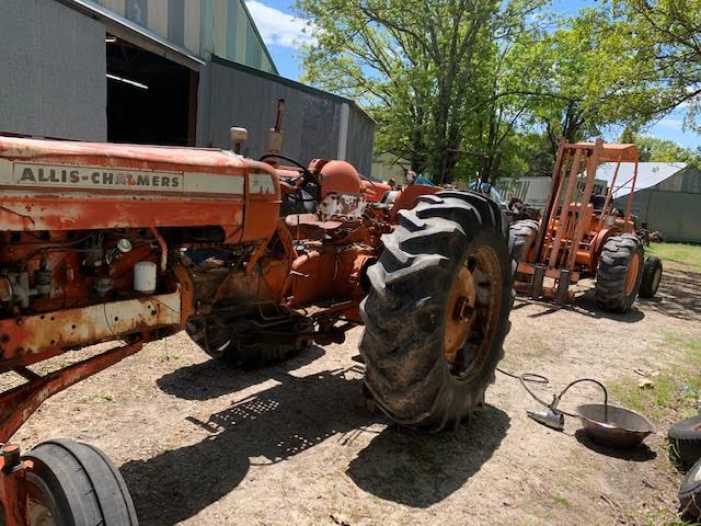

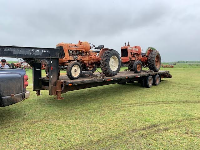

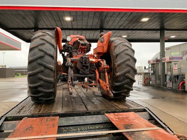

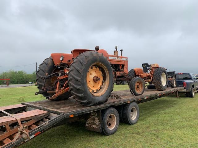

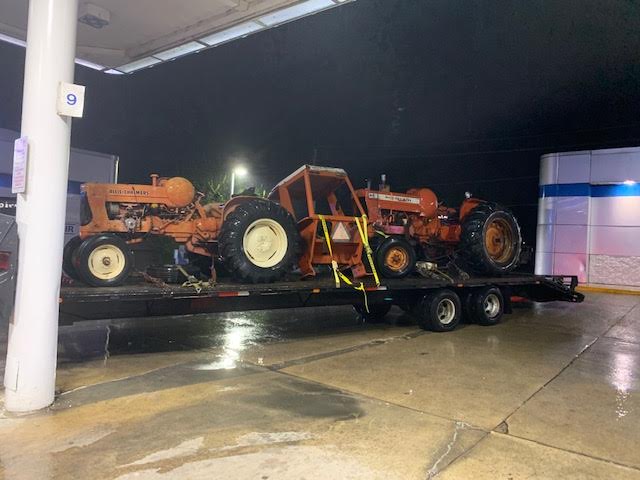

Yesterday stop at 3 different places to pick up tractors and a canopy.
about 1000 miles round trip to OK.
Thanks to Adam for loading me at 9:00 pm.
Some of the trip in the rain was not fun driving.
Will get better pictures still raining here today.
D 14 propane
D 19 Propane

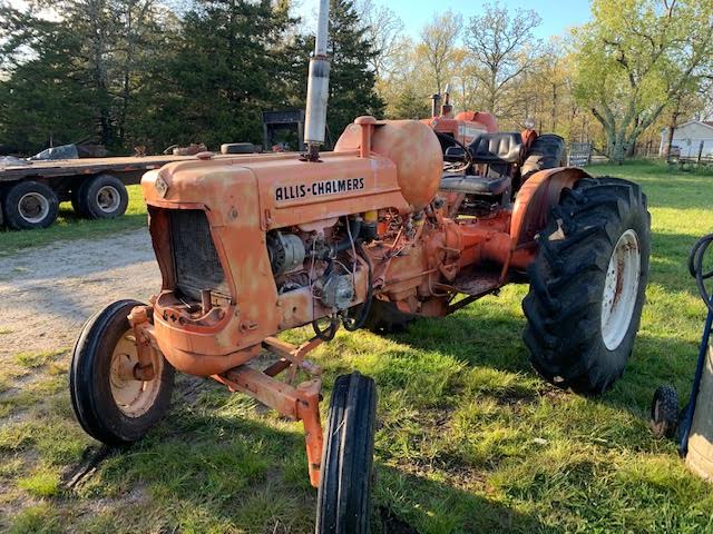

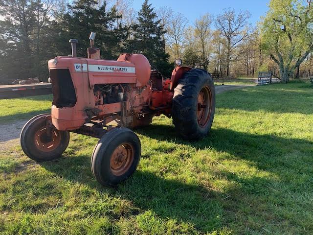

Might use the canopy for my 7020 High crop.

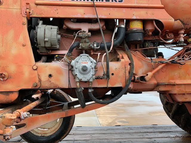

Work on the D 14LP yesterday.
Had to change out the Coil as it was bad. also they had the polarity wrong for way the battery was connected.
Also put about 30% Propane in the tank.
Last few D 14 tractors I have bought, had the missing tube out of the oil filter.
This one did also.
Pull one from a parts tractor, oil pressure is at 23lb.
Also changed out the starter.
Has power steering and need to work on all the leaks.
Still need to spend time on the D 19. The Propane gauge gasket does leak found that out yesterday.
Pull the tractors off the trailer using my D 15 Propane.

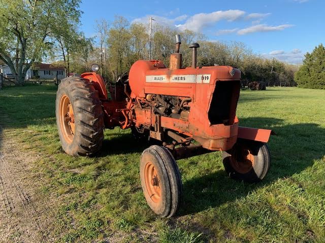

work on the D 19LP yesterday put a new gasket on the LP fuel gauge was leaking.
It needs all the belts they had been removed.

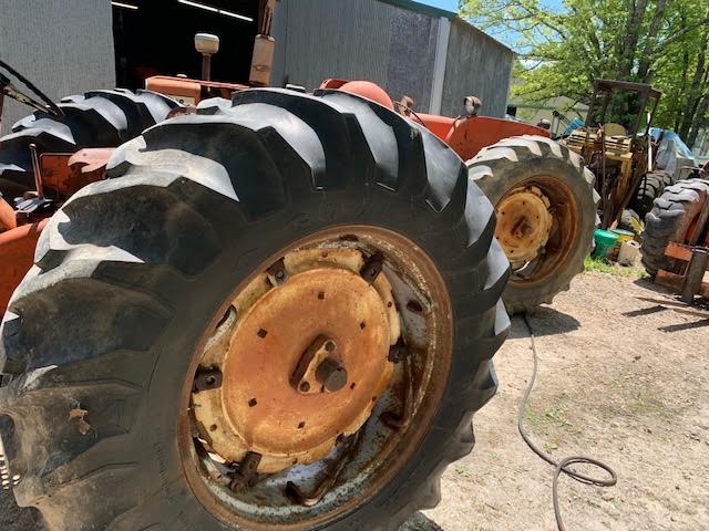

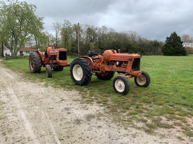

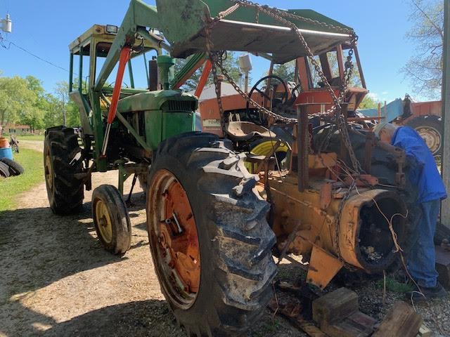

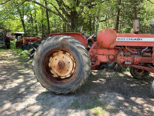

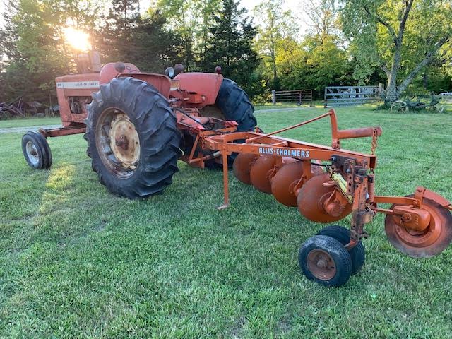

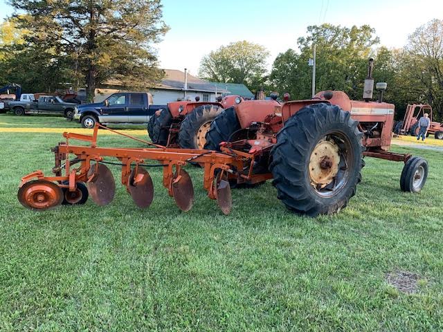

I had bought this other D 19 LP early before the swap meet and this weekend we spent time changing tires from a parts tractor that had bought some time ago.
Tires off both tractors where loaded with calcium.
Also removed the wheels off the parts U moline, we had removed the motor out of that for the UTC high crop.

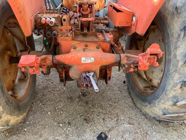

Also installed set of NOS set of Snap couplers on the tractor, had bought these at the last swap meet.

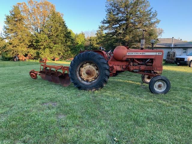

Hook the 4 bottom disc plow on the tractor.
Still have to figure why the Snap coupler lift hydraulics will not hold.
2nd radiator for the D 19LP with 3pt seems to holding water!.
Had put all new belts on that tractor,ordered new radiator hoses this morning.
