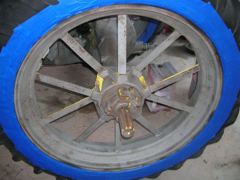

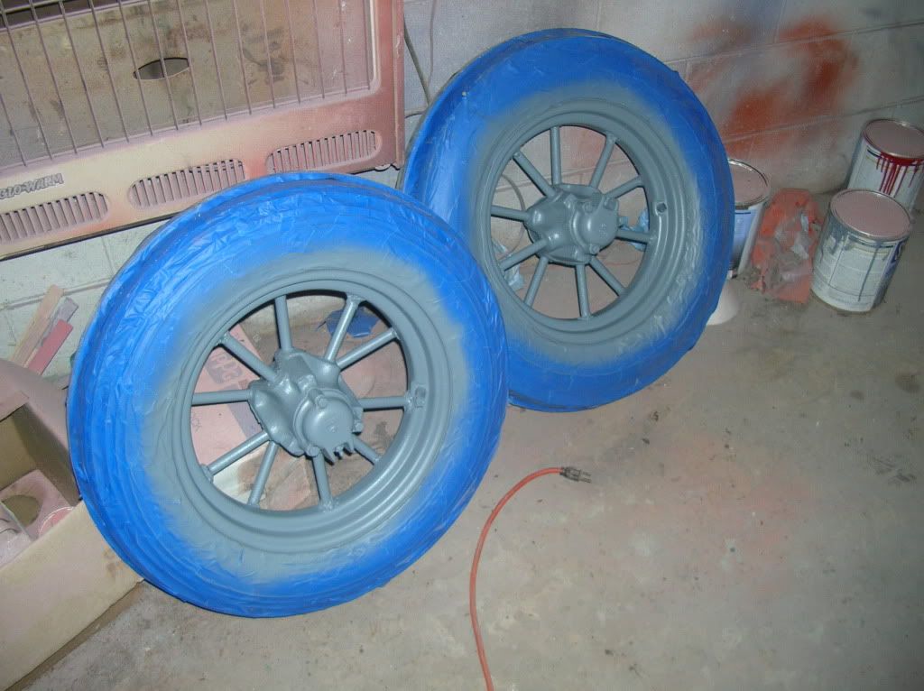

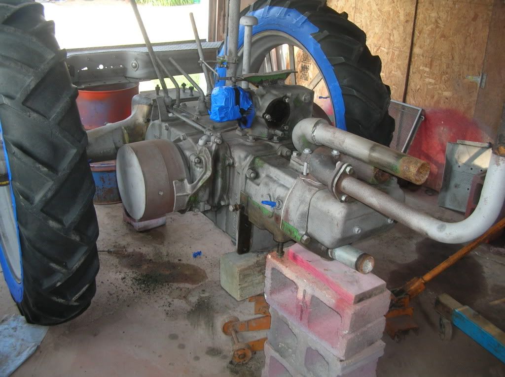

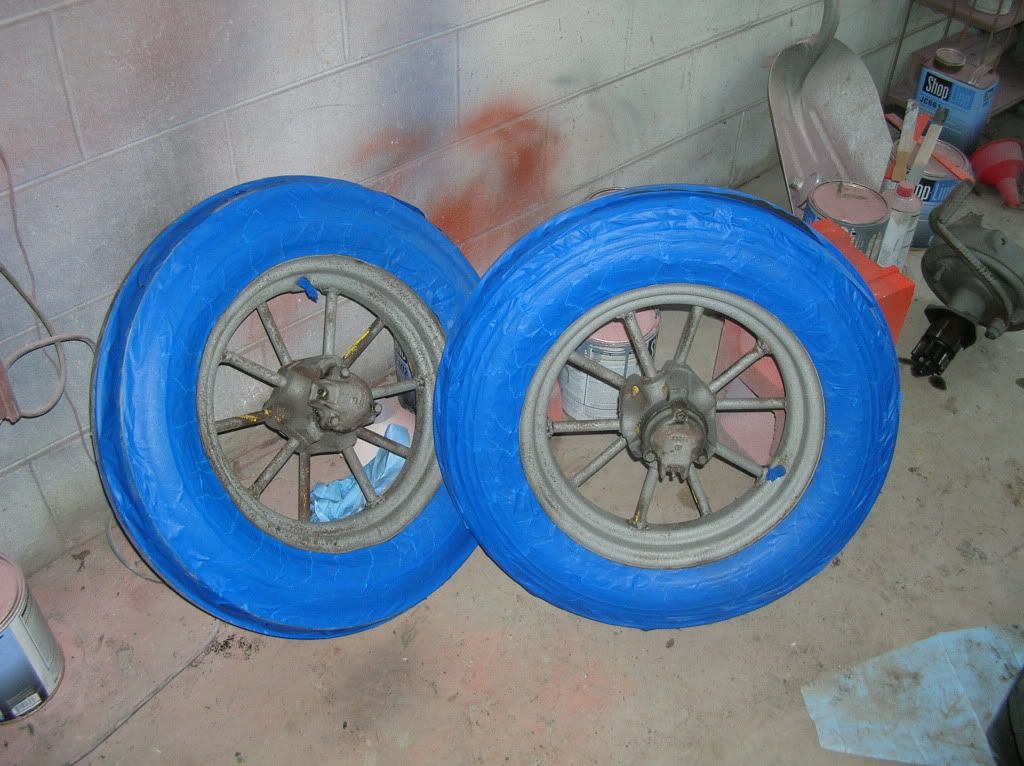

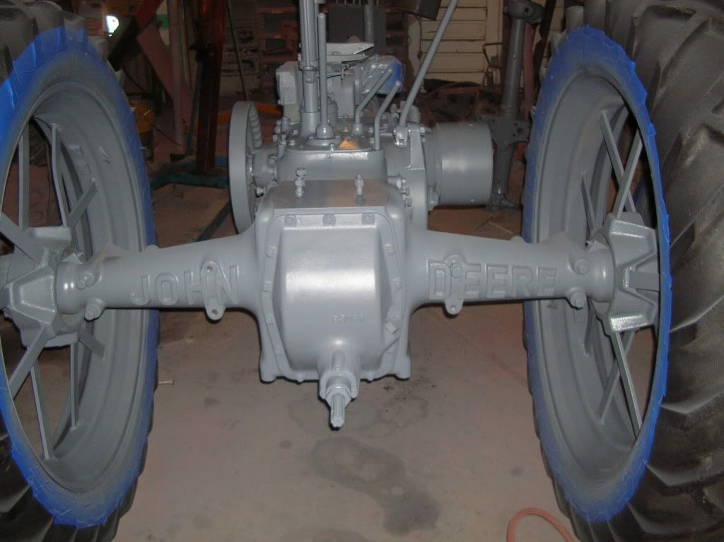

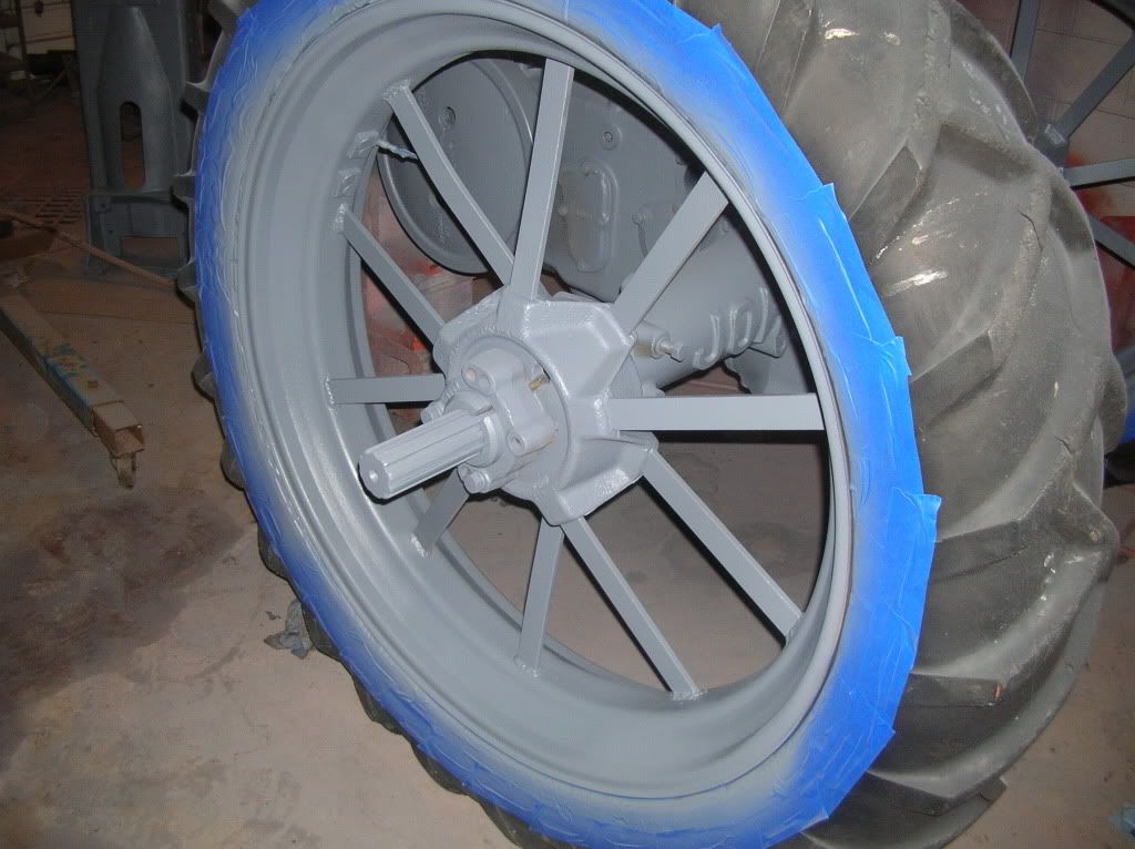

I got the John Deere B (unstyled) back from the sandblaster about a week ago and finally got it disassembled far enough to suit me.  So last night I went ahead and shot some primer on it (Shopline JP375- PPG brand).  Tonight I will go back and shoot the second coat of primer on (Shopline JP202 surfacing/filler primer) then wait a day and start shooting color and clear.  I really wanted to remove the rear wheels, but I can not get them to budge, so I will carefully mask them off instead.  The front frame wasn't too bad to get off, but it is HEAVY!  I will keep updating as I go along.
Adam
Sandblasted Pics

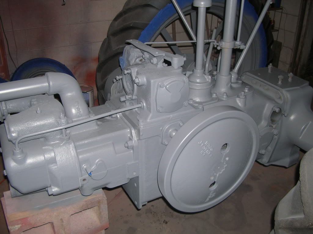

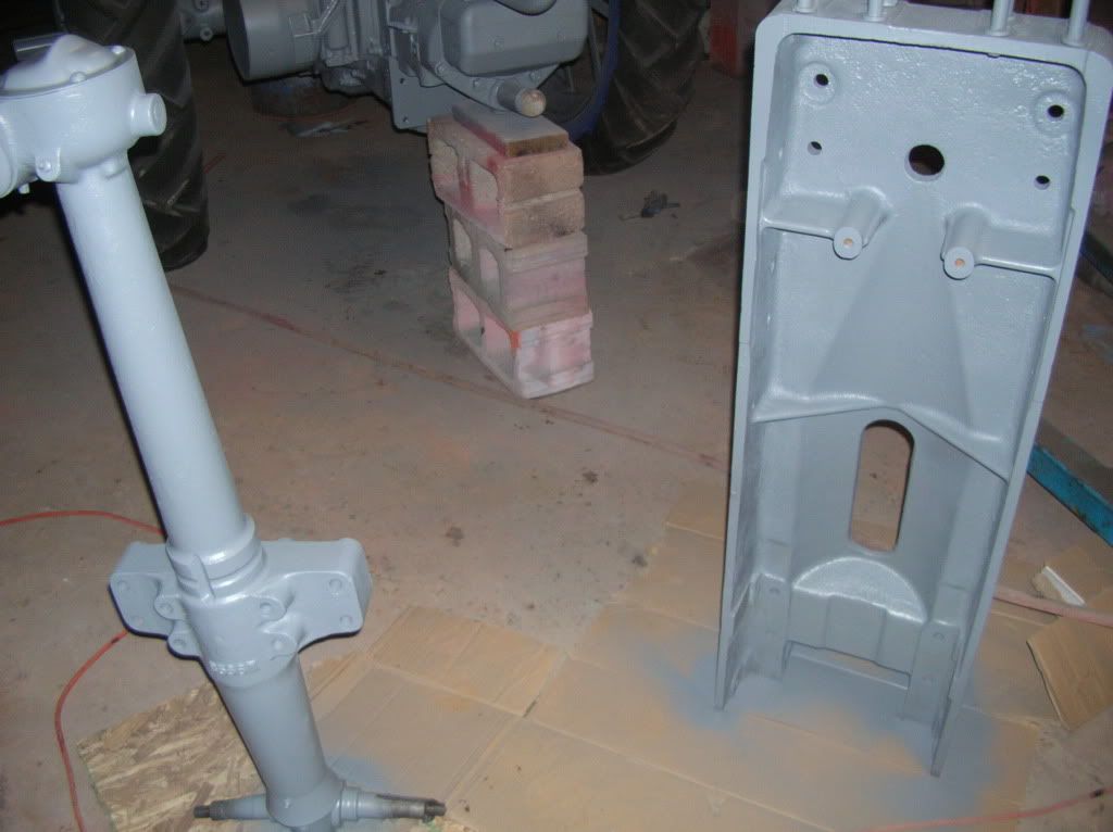

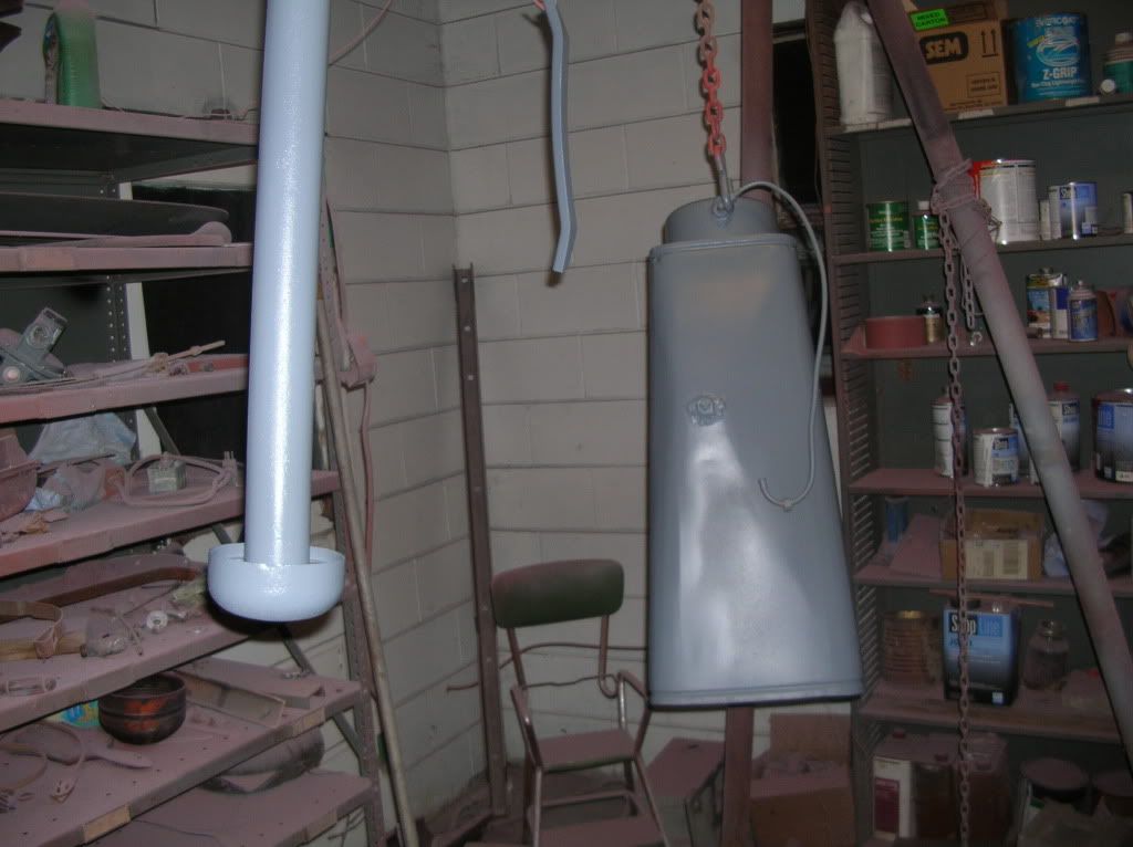

Primered pics
