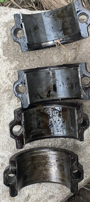

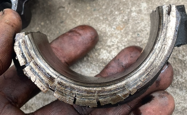

Post Options Post Options   Thanks (0) Thanks(0)   Quote 55allis Quote  Post ReplyReply Direct Link To This Post Posted: 14 Oct 2025 at 12:02pm
Got the oil pan off today and figured out why it was parked, it had spun a rod bearing…
1955 AC WD45 diesel with D262 repower, 1949 AC WD45

Post Options Post Options   Thanks (0) Thanks(0)   Quote scott Quote  Post ReplyReply Direct Link To This Post Posted: 21 hours 33 minutes ago at 9:30am
Is the spun rod bearing on one of the good cylinders?
55allis View Drop Down
Joined: 30 Jun 2020
Location: Griswold Iowa
Points: 1086
Post Options Post Options   Thanks (0) Thanks(0)   Quote 55allis Quote  Post ReplyReply Direct Link To This Post Posted: 21 hours 23 minutes ago at 9:40am
Yes, it was number 4.
1 and 4 has good sleeves but 2 and 3 sleeves are junk.
Got all the pistons and sleeves out and the pistons look all good. Even the rings don’t look too bad.
