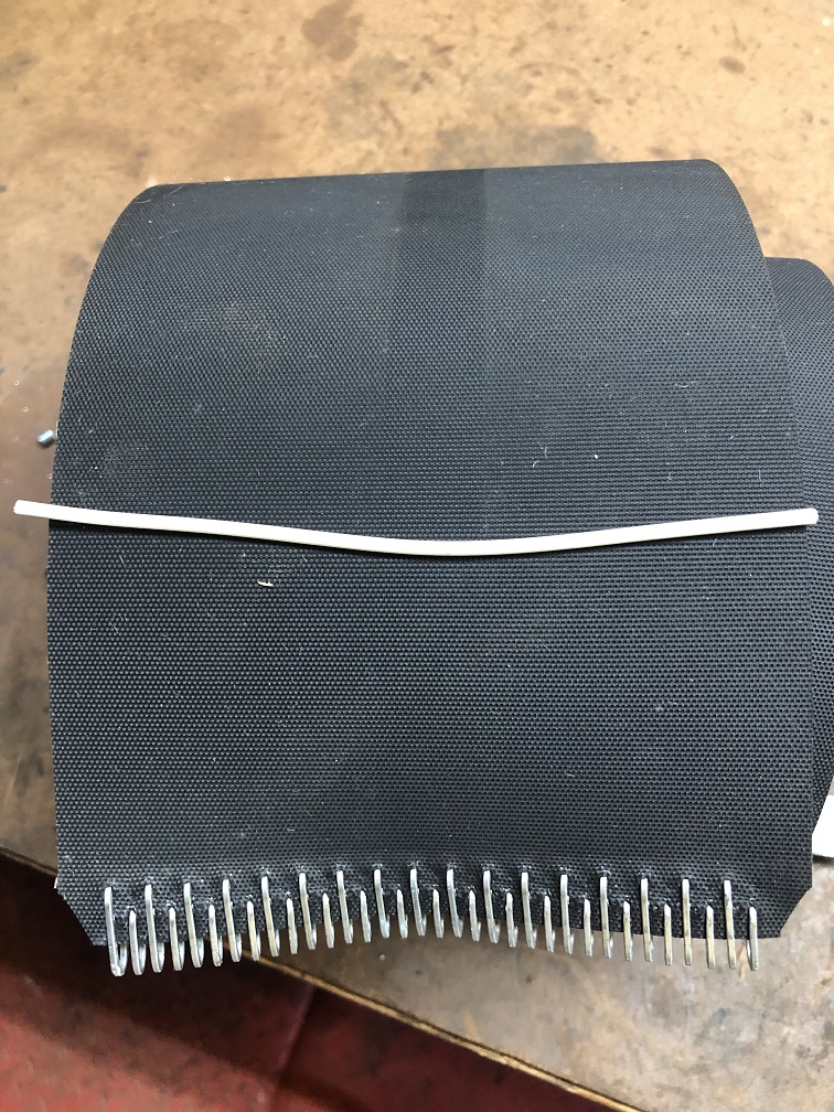

So I called Ex-Cel (now owned by someone else) to get educated on stitching together the belts. Here's what I learned...this length of "electric wire" was included with each belt - it's actually .09x cable with a nylon coating.
So put the belt in place, line up the lacings, insert the cable, bend the ends over and insert into the lacing.
