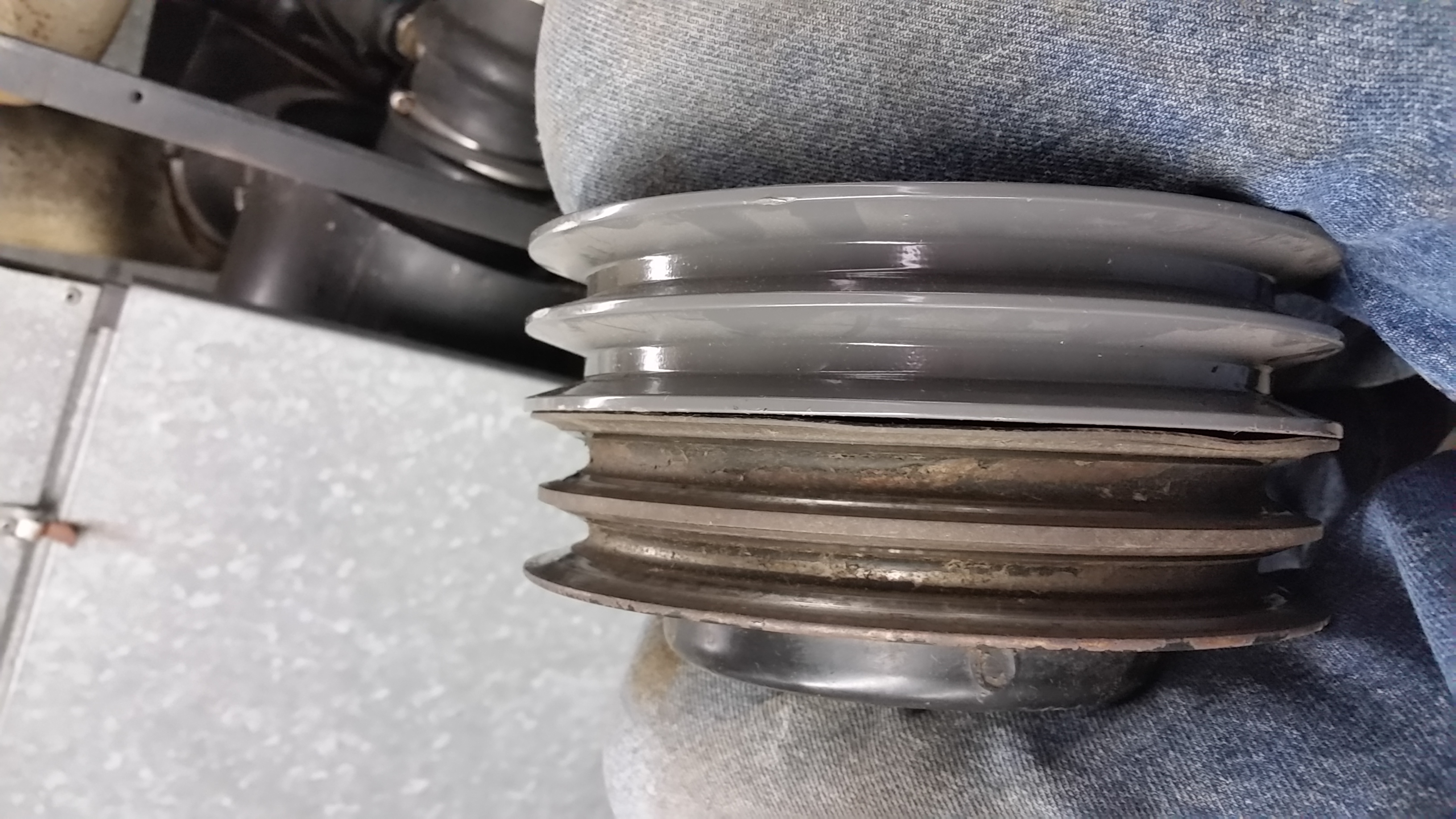

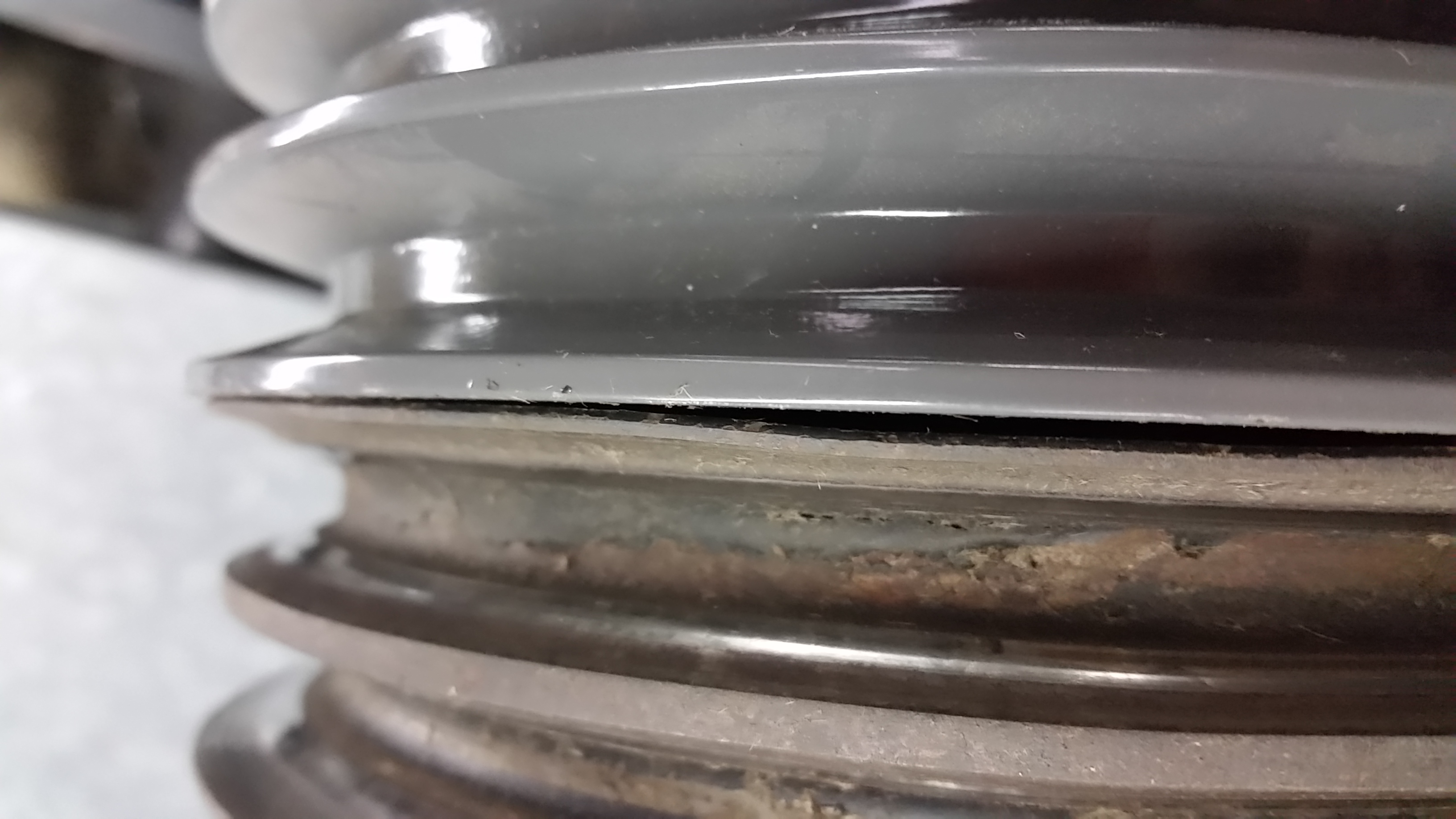

Post Options Post Options   Thanks (0) Thanks(0)   Quote fastallis Quote  Post ReplyReply Direct Link To This Post Posted: 09 Sep 2017 at 7:23pm
I pressure washed my radiator out with water form the hot water heater it is set at 125degrees for about an hour today. Wow I got alot of stuff out of it. I also replaced the water pump pulley. It was very worn. I took some pictures of thme so you can see the wear. I will see if I remember how to post pictures.
