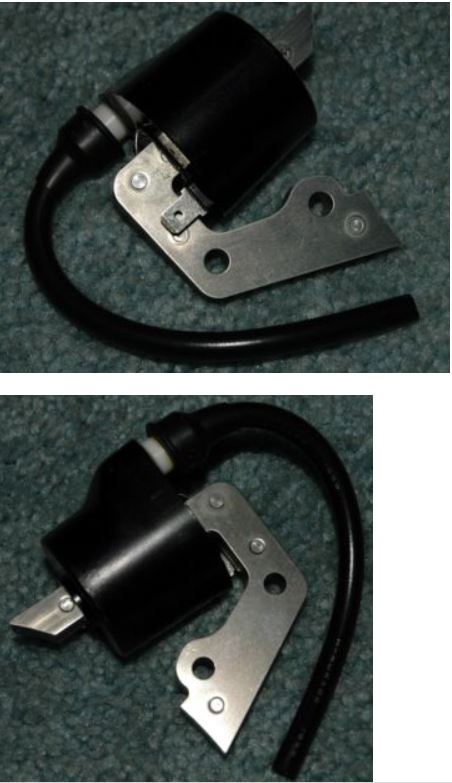

dose it look like this
       B:-)     Dnoym

  Hey Dnoym,,,that pic is what most of the coils look like but the one for this engine is different,,you see where the bolt holes are kinda centered or square to the contact faces,,? well,,the bolt holes on this  one are offset. I've looked at a whole bunch of them but no dice yet. Thanks,,Clap

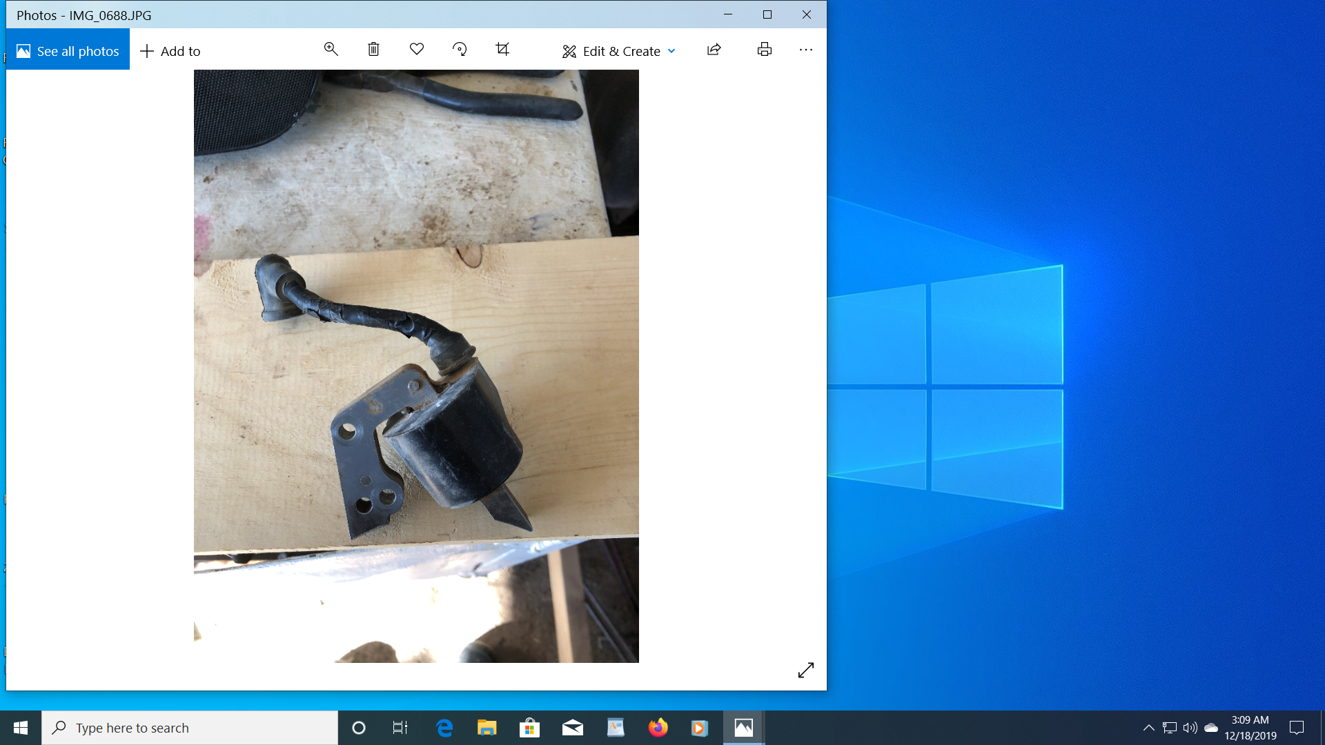

 Well,,I'ma try this one more time,,,I been finaglin with Win10 on transferrin pics but ,,,,aw chit it did not resize,,,!!!!WTF,,??
 well,,at least you can see what the friggin coil looks like,,,,,WinkWink
 Strange lookin one huh,,???

Found this but its for a FA210D HS05 & FA210D-258X Kawi. I found some old parts books and coils that looked like yours in their diagram drawings. The part#'s were 315470-8123A, and one had this part# 21171-2120. I think your motor is no longer made a long time ago and numbers have been superseded. Contacting a Authorized Kawasaki place my be able to cross reference this for you. Maybe this would still work, but no returns. Could not find anything for the other part#.

 And them coils do look almost identical... the center lug looks longer on yours though... might be able to file slots for adjustments if that's the case.
