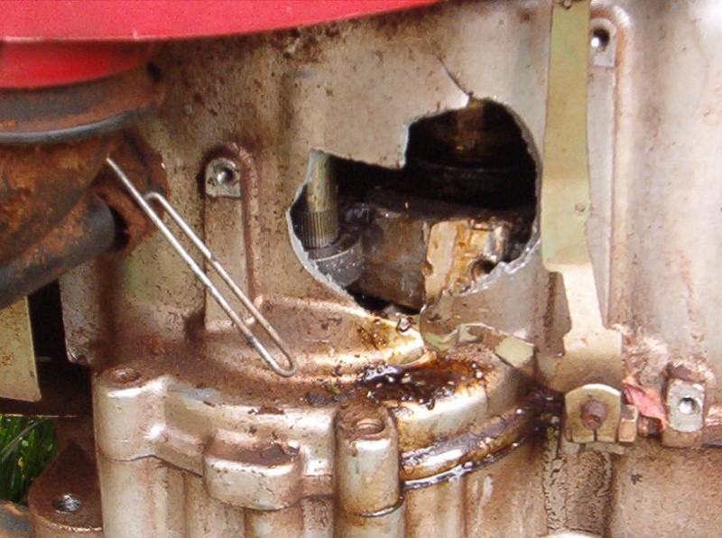

My riding mower blew up last week.  Now I have a new inspection window on the motor.
I don't really understand this failure, I changed the oil every two or three years,  only mowed my 45degree sideways hill twice per week,  only towed my AC B to the sandblast area on nice days, only hit a couple of rocks ....

There is a engine my barn like that, except the block doesn't have the hole in it!. I don't know what happened to this engine, someone said the OHV parts sometimes would fall off, and was a easy fix, fellow I got it from thought it had a more serious problem.

That looks a lot like the 17 horse motor I just changed the oil in on my neighbors Craftsman 42" mower.  At least without the after picture. While reading your post I was going to ask if there were unusual signs before it happened but I guess you already answered the question. LOL

Only changed the oil once every 2 or 3 years? I never let the oil in mine get dark. B&S last I knew recommends change oil every 25 hrs. When you figure how much oil it takes to fill one, it just doesn't make sense to let it get dirty...

A friend used to have a mower repair service.  At least once a year he would go on repair calls because "my mower just quit"  He'd check the oil, empty.  Ask, "when did you last check the oil?"  "Oh, you have to put oil in it?"

Well least on my cast iron block Techumsa first time it siezed up when kid was mowing without checking oil I was able to etch the stuck rod material off the crank with caustic soda. crank was not hurt. Rod was rough so took a brake hone and smoothed it out then I miked it , took a little off the lower cap and ran hone again until I got oil clearance right. ran for two more seasons before it gave out.

Many years ago when I worked in a lawnmower shop, at least twice a year someone would bring a new big box store mower in that "Just quit". It was always obvious, no oil before it quit. Oil was then added after the fact. Nice clean oil and a blue crank pin = no warranty.

the 16 hp kohler in my 716 did that once.  I had just bought it used from a dealer, and it suddenly started not running worth a hoot . I loaded it up an took it to dealer. next day he calls me up an told me he thought he had it fixed and took it out to run it around the building and it blew up... cracked like a shot.  it looked about like that.  I never did know what exactly happened

I just picked up a used mower with a blown 25hp Kolher.No holes but both rods are sheared off against cyl wall after they burt/broke off the throw and it came back around.Drain plug hasn't been out and there was about a cup of oil inside.It too came from the"get on and go!" crowd.
