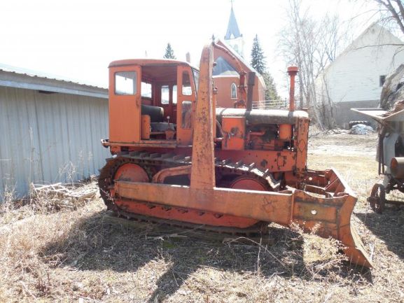

I picked up this machine at an auction last fall, and it was a fun winter/spring project. It had a fully enclosed wood cab (which I have since removed for restoration). The cab leads me to believe that it was a snow cat at one time, with a V plow and possibly wings.  I think the current blade started its life on an HD7, and was added sometime later. This is when it was welded straight, and the hard bar was added under the machine. If you look closely at the steel tube running over the top, you'll see a piece has been welded in. I believe that was to make up the difference in width between an HD7, and a Wide gauge K. Quality workmanship all around. Merely speculation, and would love to hear opinions.  Anyways, here is a video of my first time pushing with it after I got it back together this spring.  https://www.youtube.com/watch?v=_TUOQrOG8Yo

Are these both the same machine?  They sure look similar, with that welded in piece, on top of the baker blade.  Was the video I posted your's, under a different user name, on youtube?  Sure looks to be a small world...Wink

Squatch in the video says gas engine, Is there a gas engine version of the K? Or not being a AC guy did he just get confused by the fact it has spark plugs to help lite the diesel.
There were a fair number of K's to farm with in my part of the world and 90% of them had been converted to run butane or propane.

K was gas version and KO was oil engine (diesel).  many were converted back to gas i hear.  dont see an injection pump on this one, looks like plastic bag over magneto.

Squatch had it right, its gas. I had it out at a local show a few weeks ago, and that is when he did the walk around.
