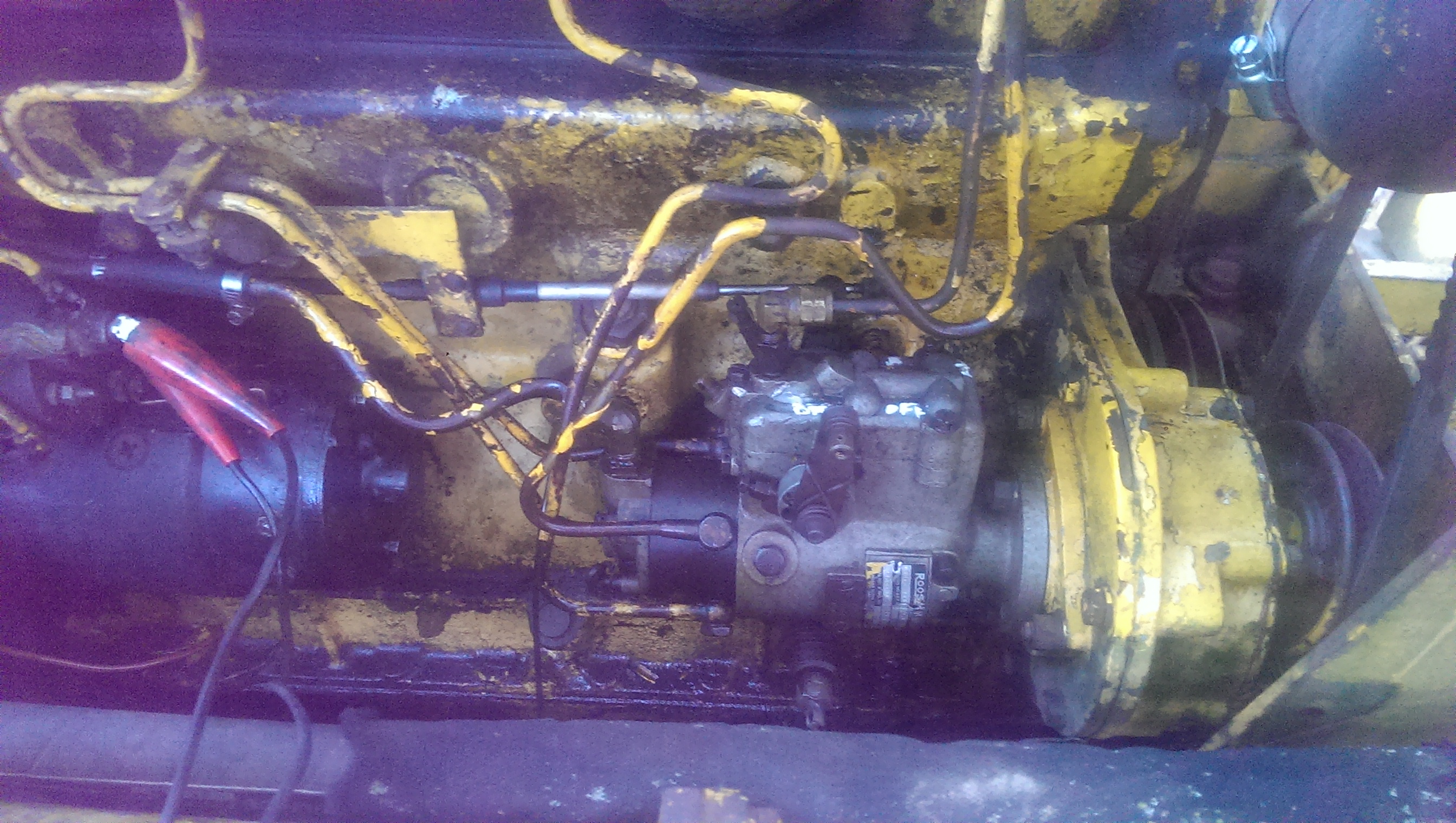

   I got a cranking over in the motor sounds great but the injection pump is absolutely not putting out any fuel I took the top cover off it looks very Rusty in there I'm trying to soak it in some PB Blaster looks like the pump was new at one time don't think this machine ran in a long time I don't have any information on it pump could be even installed wrong but it's not pumping fuel

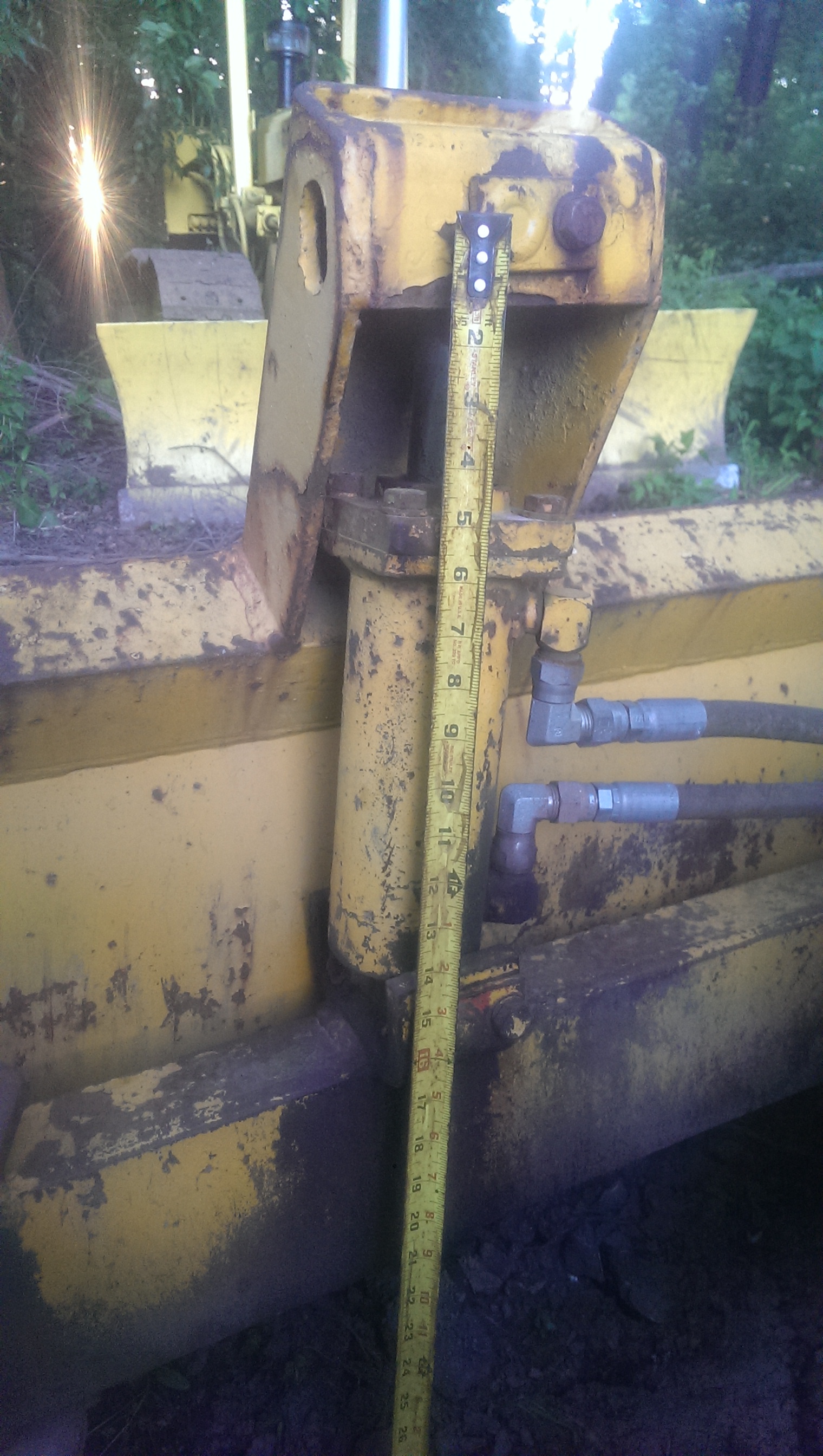

here is a picture of the Tilt cylinder with a tape measure next to it

CC it looks like someone added the grouser bars seeing how square they are cut. You need to cut or round the corners taking off around 3/4 of an inch or whatever looks good to you. This will help the machine turn much easier, not tear up the ground as bad, and also not get stuck as easy. Looks good.

The injector pump is probably why it made its way to scrap. Will need bring the engine up on time, drag the pump off and have it gone thru. Most likely sheared the internal coupler.
Cannoncollector View Drop Down
Joined: 14 Jun 2017
Location: Pa
Points: 37
Post Options Post Options   Thanks (0) Thanks(0)   Quote Cannoncollector Quote  Post ReplyReply Direct Link To This Post Posted: 16 Jun 2017 at 4:34pm
Yes I'm just not getting fuel to run through the pump or pump fuel, I see things rotating through the timing window and an injector line port, could something be stuck that could be freed up?

You can take the top cover off and see if the shut off lever is stuck inside..
 and the lever there on the outside of pump I believe needs to be towards the operator to run.
 Does the fuel run out of the line from the fuel tank fast?
Did you bleed everything?
  Taken the lines loose at the injectors to see if fuel is even trying to flow?

Yes, good fuel flow with full tank of fuel, and fuel is just not filling the pump..it should fill it and even run out top return line right?

Ok thanks, I pulled it apart, with instructions I found on the net, and the only thing I may see wrong is these rollers won't rotate dues to rust

most likely the pumping plungers are stuck. I don't mind adding some advice here and there, but these do-it-your-self pump rebuilds rarely go good. You can piece it together enough to make it run, then maybe give it a proper rebuild, the injectors too. If it's all full of rust and corrosion, you certainly don't want to seize the pump because it will try pumping to stuck closed injectors. Good luck!

Those blocks the rollers are in, they need to be free too... as well as the plungers below the blocks.
You probably already seen this vid... Look at about 7:12 mark
[TUBE]DCPWHv2jJZE[/TUBE]
another vid...
[TUBE]veEONfhL3Uk[/TUBE]

thank you Ed, Yes they were stuck, the only corrosion seemed to be in this area. Wish me luck😀

JC, thanks again for the tips, I saw the first video, but not the second, you were correct plungers ,rollers and blocks stuck
..THE JOB IS DONE AND SUCESSFULL!..it was still hard getting to to fire for the first time, but running better and better!

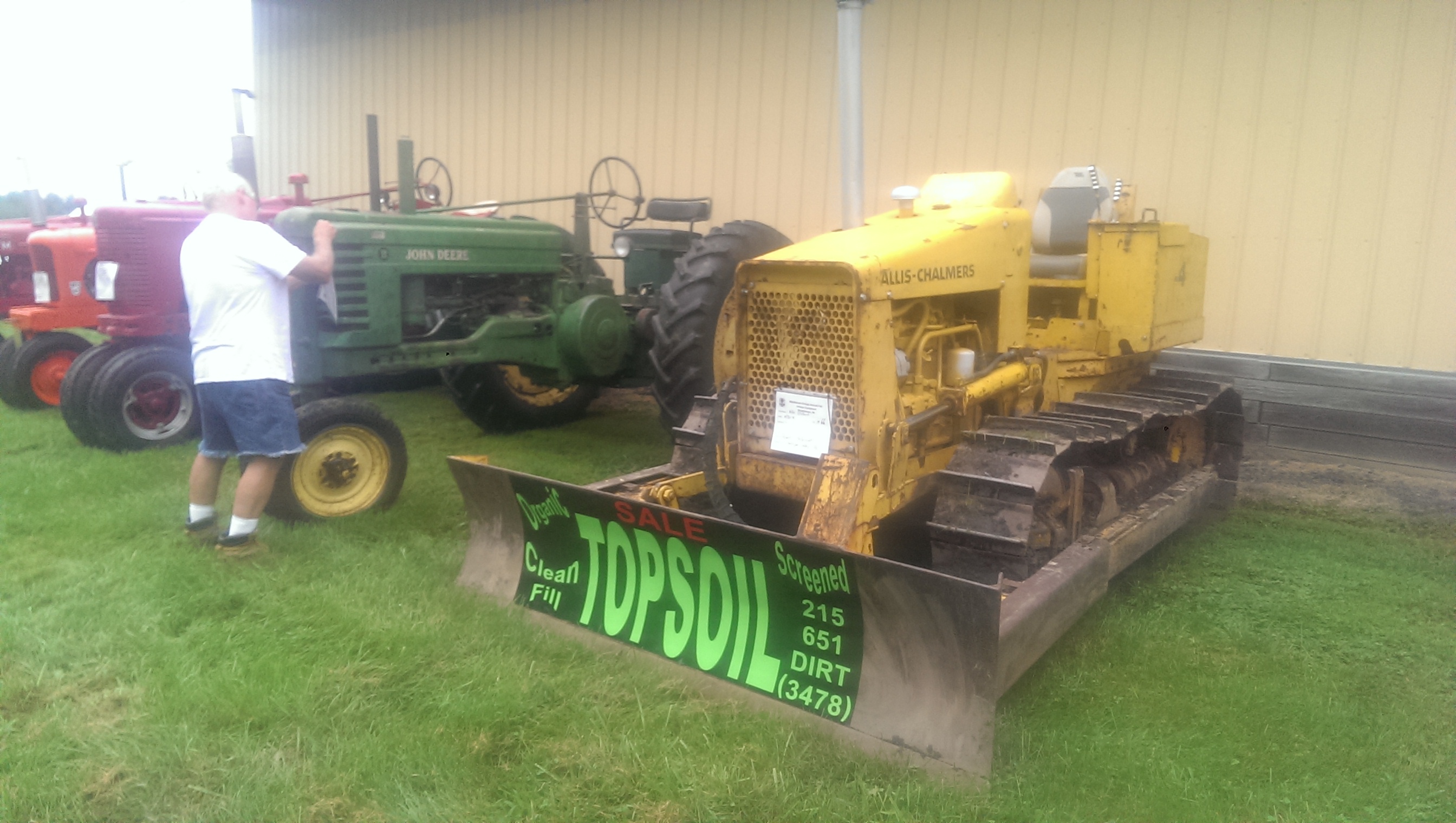

Looks like the rig I need or the back 40 here. I need some paths made in the overgrown huntin pasture. Bring it to Illinois and I'll tell you how good it works Wink
dadsdozerhd5b View Drop Down
Joined: 27 Sep 2009
Location: lansdale pa.
Points: 537
Post Options Post Options   Thanks (0) Thanks(0)   Quote dadsdozerhd5b Quote  Post ReplyReply Direct Link To This Post Posted: 27 Aug 2017 at 6:36am
Nice save! Is that at the Middletown Grange fair? I am not far from that, live in Lansdale but have all my dozer goodies in Jamison. Where are you located? Always nice to find another Allis guy close by.
HD5B, HD5G, (2) FARMALL A's, CUB. DO IT RIGHT THE FIRST TIME, IGNORE THE LAUGHTER. FLANNEL IS ALWAYS IN STYLE.
Joined: 14 Jun 2017
Location: Pa
Points: 37
Post Options Post Options   Thanks (0) Thanks(0)   Quote Cannoncollector Quote  Post ReplyReply Direct Link To This Post Posted: 27 Aug 2017 at 7:33am
Yes Sir the Grange Fair in Wrightstown. I live in Huntingdon Valley now, grew up on a farm in Buckingham..I used to have an AC 7GB loader , I miss it and would like to find another.
