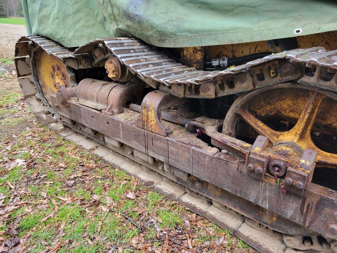

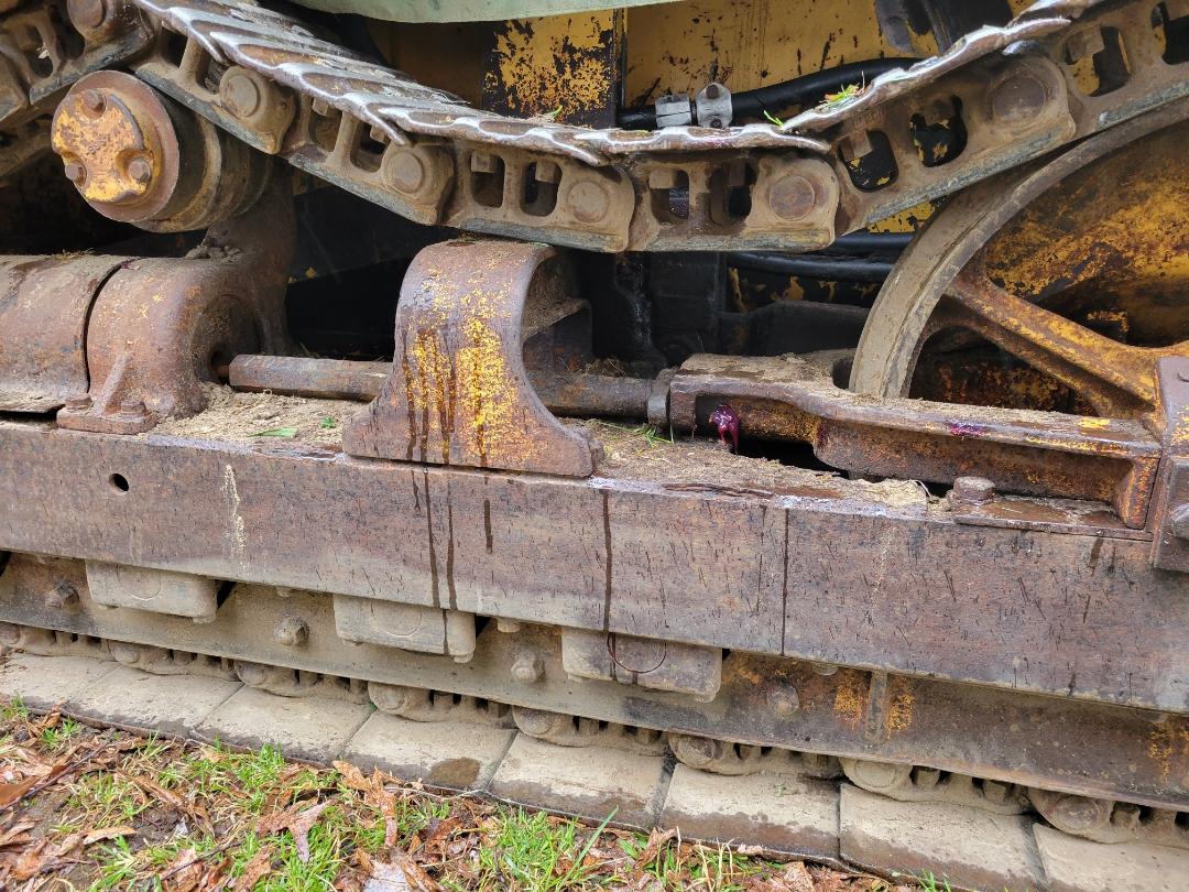

 Just to show what I'm dealing with, I turned the tensioner into the yoke about 1" to the end. At this point I don't think I have any choice but removing a link if I want to use the Dozer.
Points: 90327
Post Options Post Options   Thanks (0) Thanks(0)   Quote steve(ill) Quote  Post ReplyReply Direct Link To This Post Posted: 03 May 2022 at 4:24pm
I think removing a link, or maybe lengthen the adjuster rod a couple inches is a good SHORT TERM SOLUTION for a TEST. ..( im not sure there is enought LENGTH to remove 1 link and still FIT).... You just got the tractor, so you may want to RUN IT a little before you get in deeper..
I have heard of some that use "OTHER CHAINS" not built for the HD 3-4.. You need to change the sprockets to match the NEW CHAIN PITCH, and make sure the top rollers can fit inside the rails, and the bottom rollers fit outside... Some modifications may be needed.......... i thought the CASE 450  was "close"... but you need to adapt the sprockets to the Allis machine.
Edited by steve(ill) - 03 May 2022 at 5:50pm

some more data.......
 Thanks Steve, great information!

You should turned the rod adjuster on the other side and maybe  the tread in yoke are no more good and if the adjuster rod tread are in good condition  you need to turning the nut until the track are oké and dont forget to lock the nut with the 2 bolts.

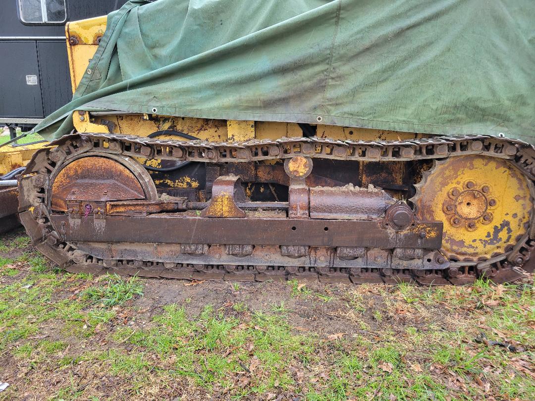

This is a pic of the left side I have adjusted to the factory 1 1/2" of sag. The tensioner rod is adjusted completely out of the yoke and only grabbing on the lock plate. Notice the front of the slide is completely forward, even the front bolts were removed on the shims to allow it to move further forward. So even if I shimmed the tensioner rod there is only about 1/4" the idler wheel could go further forward, but then the issue of the tensioner rod allowing the yoke to move around would still be a problem.

The rode adjustement right side is adjusted correct and we can see the tread on rod but the left sde we can't se any traid he is complet desajusted we should see the tread on rod .

Originally posted by Codger Codger wrote:
Is the parts wear pretty even side to side on the undercarriage, or is the right worse than the left? From your first photo it looks as you may have a skipping problem with the chain and sprocket wear once the track is tightened up. I'm not certain you will be able to fit the track with a link removed as Steve pointed out also. Thinking I would fabricate another adjusting rod of additional length to tighten them up and prove the tractor worthy of further investment?
As a pushing dozer, worn out street pads will do you no favors and it looks like the track pad capscrews are just about the same height as the pads from wear.
Yes, the wear is even on each side.
The little bit I drove it, the sprocket didn't skip.
And yes, even the capscrews are worn. The problem with making an extended tensioner,is there is no more forward adjustment, it's maxed out now.
So really, the cheapest alternative right now is remove a link. There's plenty of slop right now that removing a link should be no problem.
Points: 90327
Post Options Post Options   Thanks (0) Thanks(0)   Quote steve(ill) Quote  Post ReplyReply Direct Link To This Post Posted: 04 May 2022 at 8:54am
It may work Vetter.... but each link is 7-8 inches between the pins ?  That seems like a lot to make up..... But you dont know till you try........
You have one side stretched out to the proper adjustment... When you relax that side, does the front idler move back ( or can it move back ) 7-8 inches as needed ?? ...... or maybe you only need 4 inches as you gain length on the TOP chain and the BOTTOM chain going around the  idler.....
Edited by steve(ill) - 04 May 2022 at 8:55am
Vetter View Drop Down
Joined: 28 Apr 2022
Points: 20
Post Options Post Options   Thanks (0) Thanks(0)   Quote Vetter Quote  Post ReplyReply Direct Link To This Post Posted: 04 May 2022 at 9:05am
Yes, when I take tension off the yoke by threading the tensioner all the way into the yoke, the idler moves back 6" no problem. I'm hoping that is enough, since these links are 6" pin to pin.
I'm working on getting the pads off now, not bad just going slow because the bolts are worn. Atleast there isn't much corrosion seizing everything together with this machine. Trying to look at the bright side!
Coke-in-MN View Drop Down
Location: Afton MN
Points: 42231
Post Options Post Options   Thanks (0) Thanks(0)   Quote Coke-in-MN Quote  Post ReplyReply Direct Link To This Post Posted: 04 May 2022 at 1:52pm
Your left side track is facing the wrong way - and also it looks like sprocket teeth are SHARP and worn beyond limit .
 Track pads are loader pads not dozer -
Kind of a point where it might be a time to find another owner rather than chase good money into something - One reason my H4 got traded off - became anothers problem and not mine
Joined: 28 Apr 2022
Points: 20
Post Options Post Options   Thanks (0) Thanks(0)   Quote Vetter Quote  Post ReplyReply Direct Link To This Post Posted: 04 May 2022 at 3:10pm
 Thanks about the track info, I didn't even notice that. I did know about the loader tracks, I assumed that was original because it was setup for a backhoe too? My initial intent was to weld on some grousers eventually, but with all the wear that isn't going to happen.
 I just bought this thing, looking back at things when I bought it, that's exactly what they did I think.
 I couldn't consciously sell this to someone knowing the issues, and if I was upfront with them I certainly could never get close to my money back.
 This is my mistake at this point, so I'm committed to get it running as it should. I've done dumber things in the past, but not willing to give up just yet.
 Anyone know a set of tracks and sprockets for sale?LOLLOLLOL
