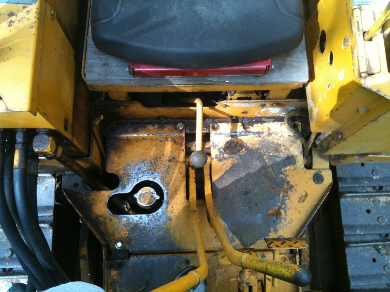

i wire wheeled it to the bare metal, no serial #.  is there any other way to tell?  so whats the biggest issue with not knowing the serial #?  i already ordered the 3000+ service manual.  what is the difference?
i think that the torque converter is slipping and i checked and it is low on fluid. (i think it is the dipstick by my right foot when siting on the seat).  although i could have sworn that the previous owner said that was the hydraulic fluid.  so im wondering if i should drain it and refill with new ATF.  btw, anyone know how much it holds?
thanks
shawn

Post Options Post Options   Thanks (0) Thanks(0)   Quote Coke-in-MN Quote  Post ReplyReply Direct Link To This Post Posted: 14 Sep 2010 at 8:44am
It needs to be checked while running .
Also add a metal plate over the fill cap as it will be kicked loose and left open when you are using machine. I put a plate with one bolt in it there so i could swing out of way . Believe the cap is little higher than floor pan so had to bend plate a little to clear
