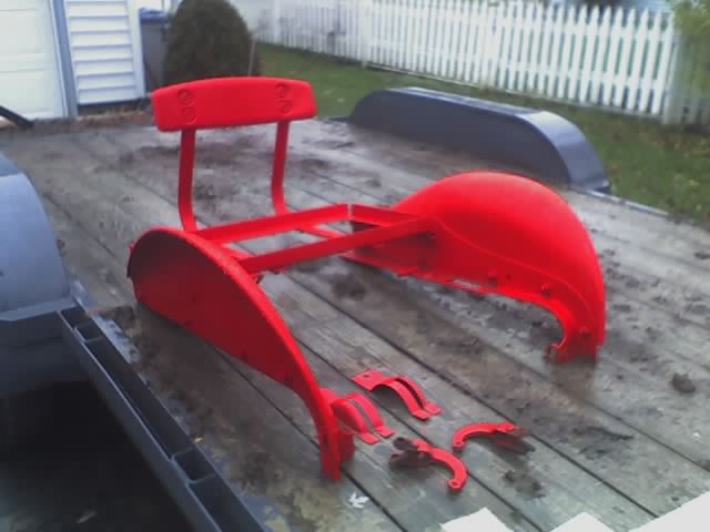

Just did a brake conversion this past winter. Besides the pedals and linkage to the brake bands, you need the foot brake style fender brackets. These could be fabricated fairly easily as ACJohn mentioned above.  The seat pan sits higher as well, so that you don't have to do crunches every time you want to push the brakes.
The worst part of the entire process was getting the pins out that hold the hand brake levers in place. I couldn't get one of them out so I sawed it off and used a bolt to press out the pieces stuck in the casting.  Knew I was in for it when the first one pushed out with my pinky.....
