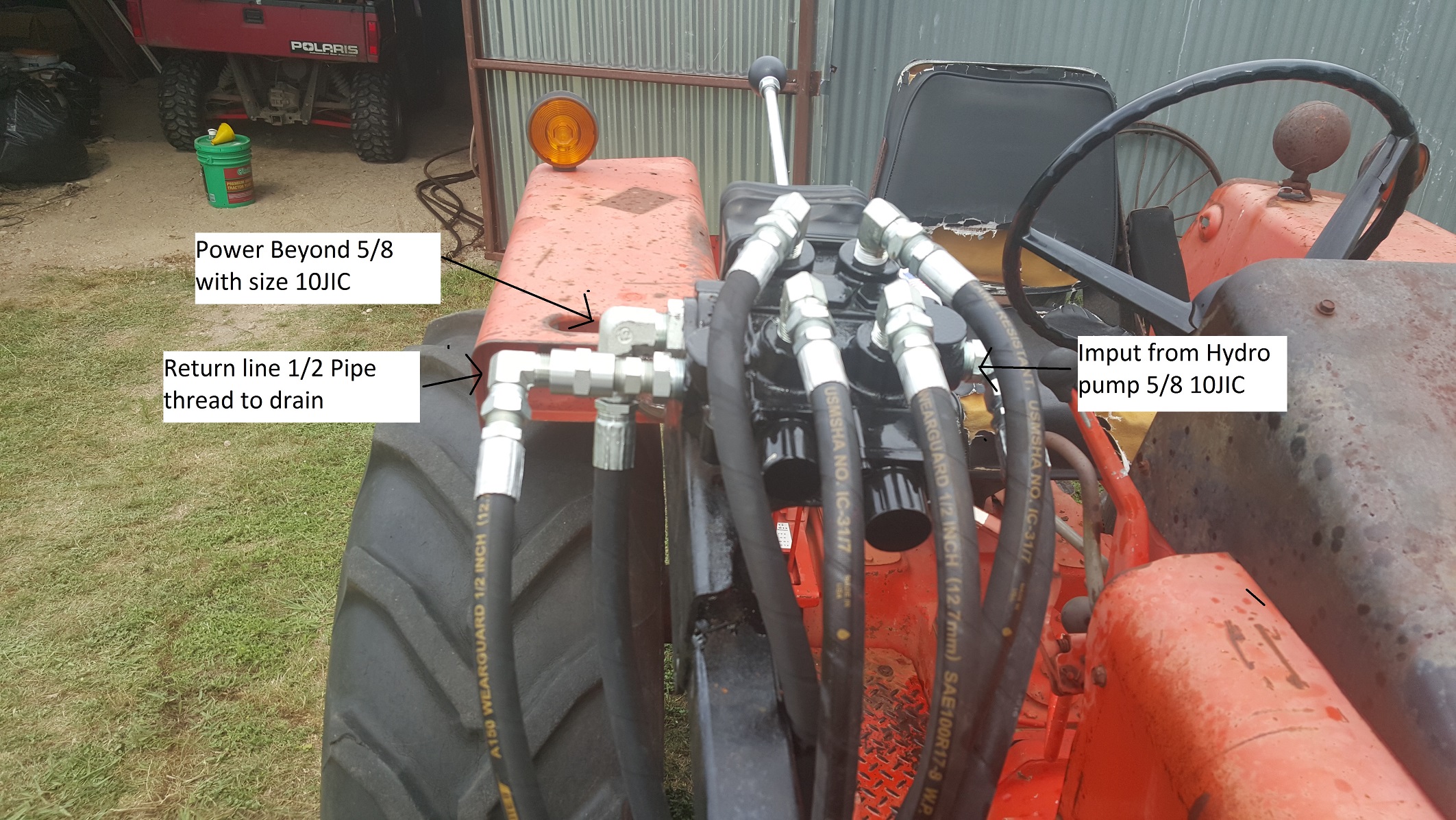

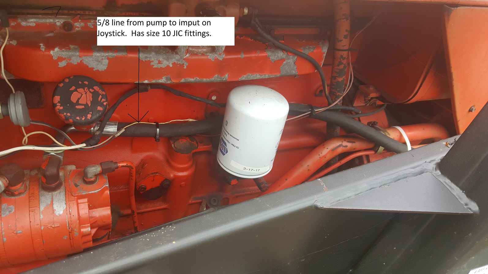

It's probably never happened here before but this project went over budget and twice as long.  Loader works great and is nice to free up the rear outlets.   Went ahead and replaced all the lines on the loader.   The seat is next.

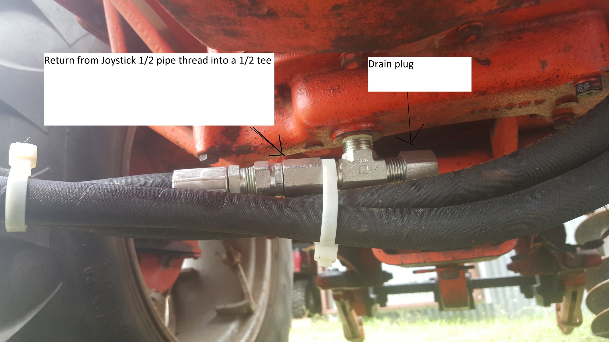

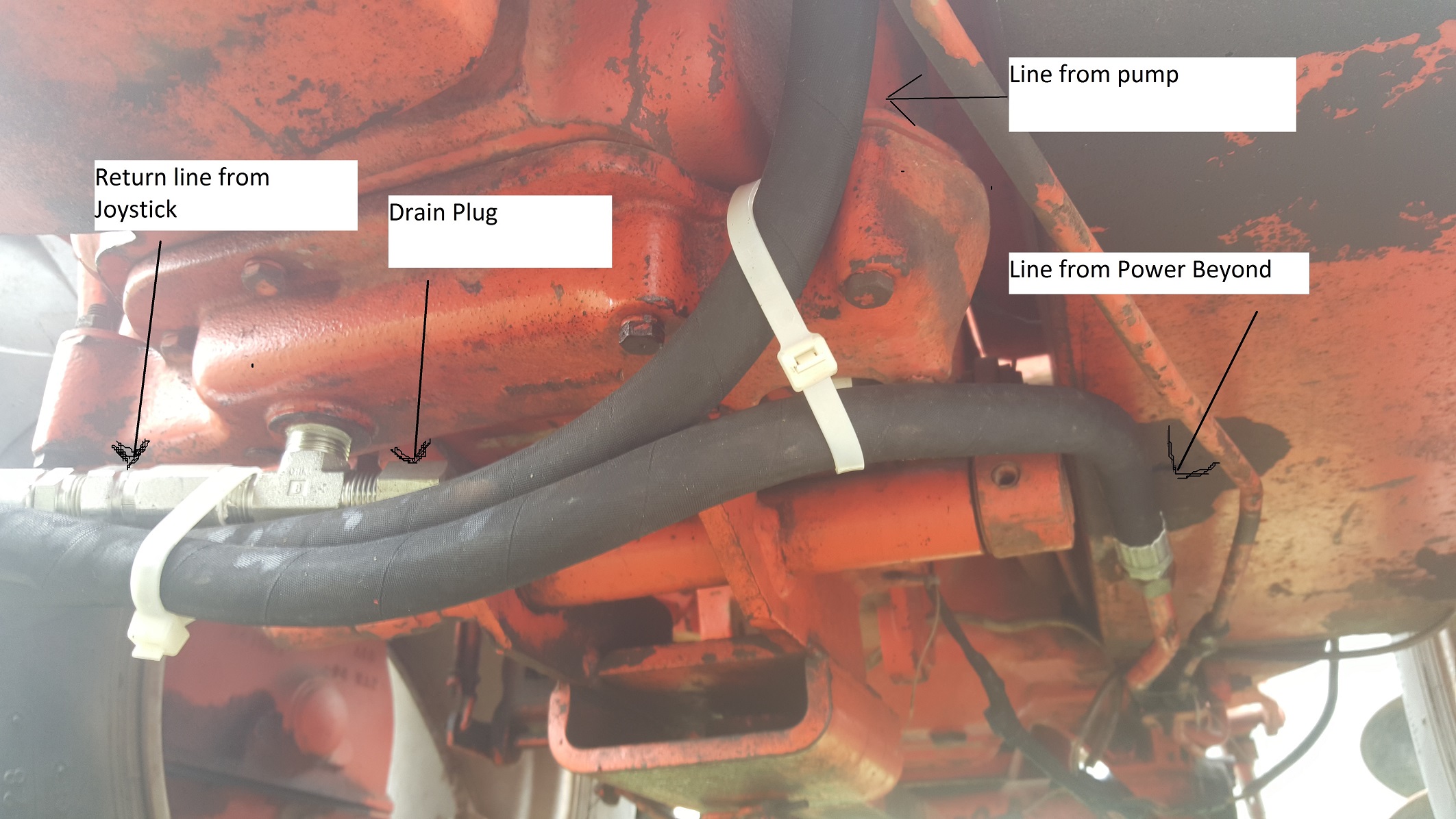

Could the drain plug "T" be turned downward making it easier to drain?
(easier to hit a pail)

I rigged my return to go through the filter by putting a tee fitting in the lift valve return line.

Post Options Post Options   Thanks (0) Thanks(0)   Quote TimZ(TX) Quote  Post ReplyReply Direct Link To This Post Posted: 23 May 2017 at 7:58am
I tried the tee down, but it lowered the clearance an inch and a half.  We use the tractor every once and awhile to clear brush.   Just thought tucking it higher would be safer.

On my 180 I split the joint connection under the floor next to the battery box and plumbed to the spool and back to the steel tube. Works like a champ.

Post Options Post Options   Thanks (0) Thanks(0)   Quote Blue Bear Quote  Post ReplyReply Direct Link To This Post Posted: 23 Jun 2025 at 9:01pm
was wanting to know the thread size of the hydralic drain plug where the return line goes in 1/2 ip or what is it please!
Points: 22760
Post Options Post Options   Thanks (0) Thanks(0)   Quote DrAllis Quote  Post ReplyReply Direct Link To This Post Posted: 23 Jun 2025 at 9:15pm
1/2" pipe thread.
