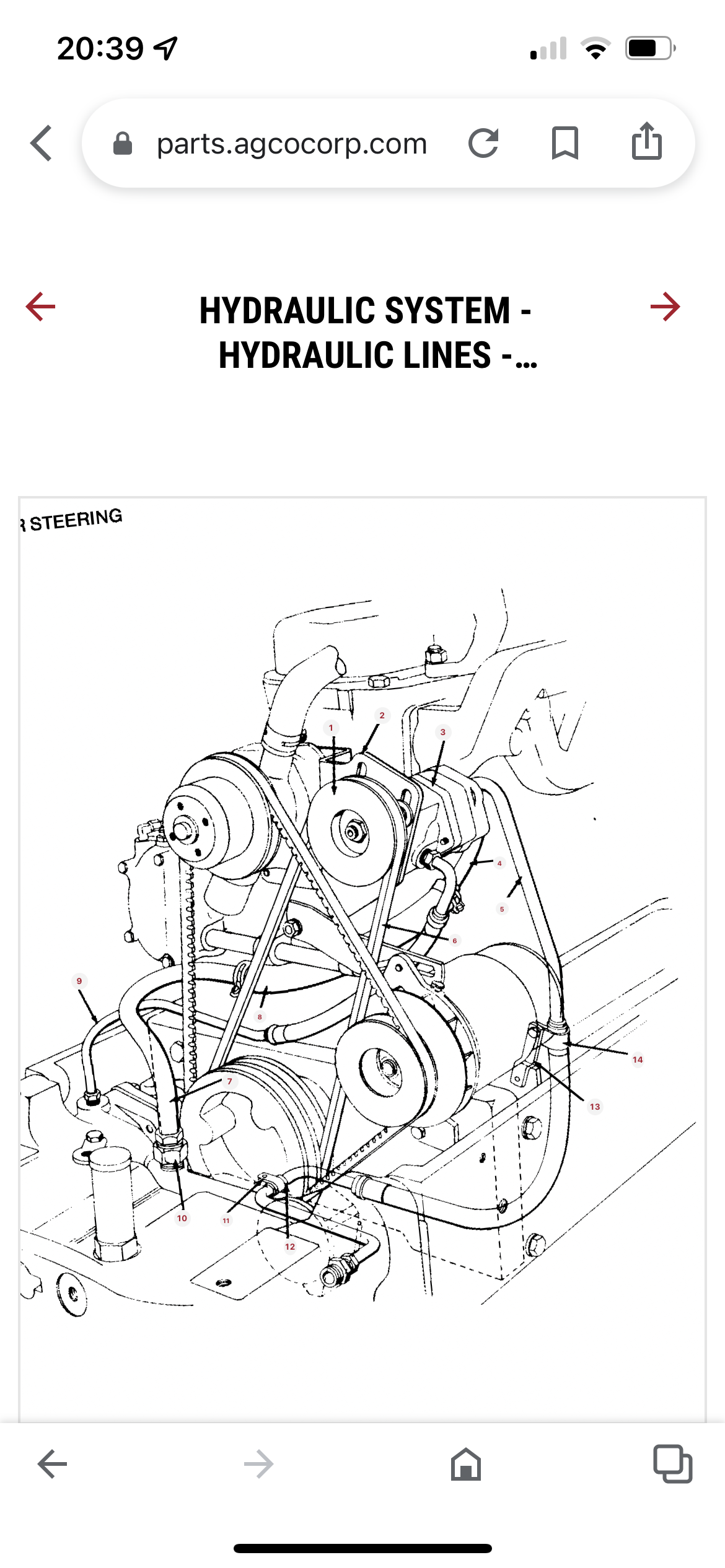

Looking for power steering line for D17 Series IV. If sitting on tractor it is the small line on the left side. Runs from pump to left side of reservoir on from of tractor.

Yes Sir. You are correct and thank you for the response. If I were to try and build a line myself. Would you know the size of the line # 5 and fittings?
Points: 22757
Post Options Post Options   Thanks (0) Thanks(0)   Quote DrAllis Quote  Post ReplyReply Direct Link To This Post Posted: 12 Aug 2022 at 6:33am
That's the pressure line, so it must be good enough for 1600 psi. If you don't have your old one for a pattern, that will be a challenge to make one identical. The pump hole is "inverted flare" which is kind of odd. The bottom is too, but you could make it into JIC connections.
