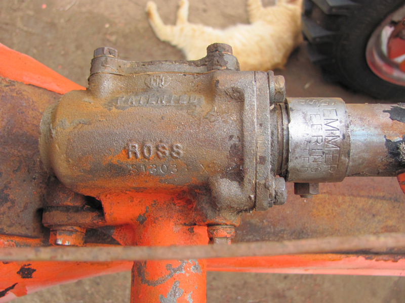

How do you tell which one you have? Ross or Gemmer?

Post Options Post Options   Thanks (0) Thanks(0)   Quote WF owner Quote  Post ReplyReply Direct Link To This Post Posted: 12 Sep 2018 at 8:20pm
Not 100% sure about the B, but my WF has the word ROSS in raised letters on the outside of the box.

Post Options Post Options   Thanks (0) Thanks(0)   Quote CrestonM Quote  Post ReplyReply Direct Link To This Post Posted: 12 Sep 2018 at 8:24pm
I know my Super 100 combines has ROSS on it, but it's clearly visible. The box on the B is nestled inside the toolbox, so I'm unable to get a good look at it. Either way, I know mine is messed up. It steers fairly hard. I drove a B at Hutch, and that opened my eyes. I could easily turn the wheel with just 1 finger. It was like having power steering!

Post Options Post Options   Thanks (0) Thanks(0)   Quote WF owner Quote  Post ReplyReply Direct Link To This Post Posted: 12 Sep 2018 at 8:25pm
Like this (not my tractor but  photo I found on the internet.
