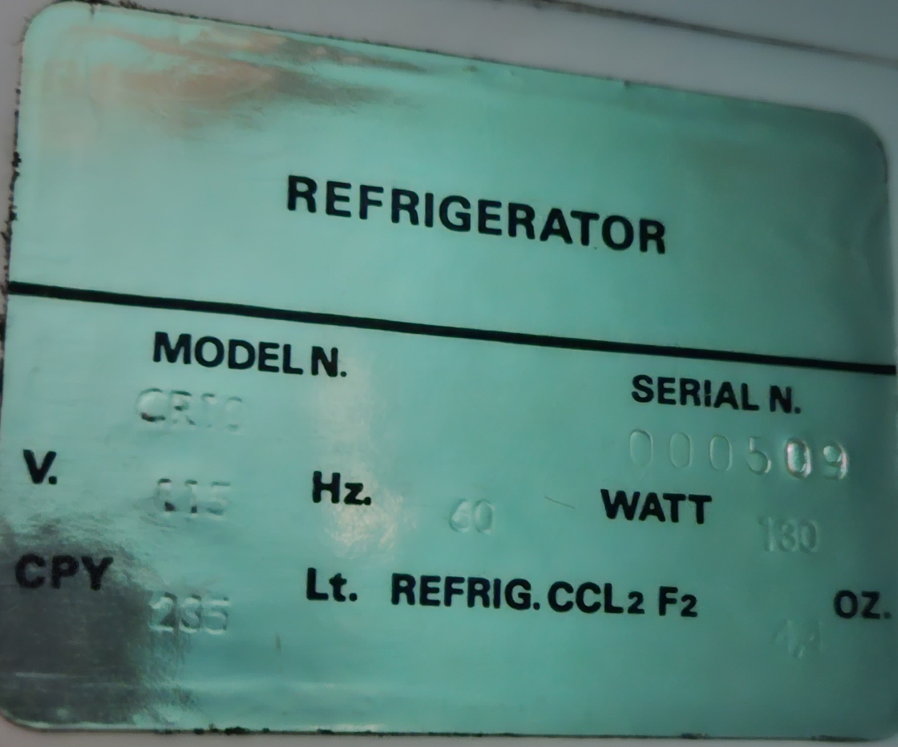

Post Options Post Options   Thanks (0) Thanks(0)   Quote bleeds orange Quote  Post ReplyReply Direct Link To This Post Posted: 30 Oct 2023 at 6:19pm
bleeds orange View Drop Down
Joined: 11 Sep 2012
Location: mt. vision, ny
Points: 707
Post Options Post Options   Thanks (0) Thanks(0)   Quote bleeds orange Quote  Post ReplyReply Direct Link To This Post Posted: 30 Oct 2023 at 6:20pm
That's all the info I have on fridge. I've tried T7 and T8 bulbs. They are slightly bigger than my socket in said fridge
