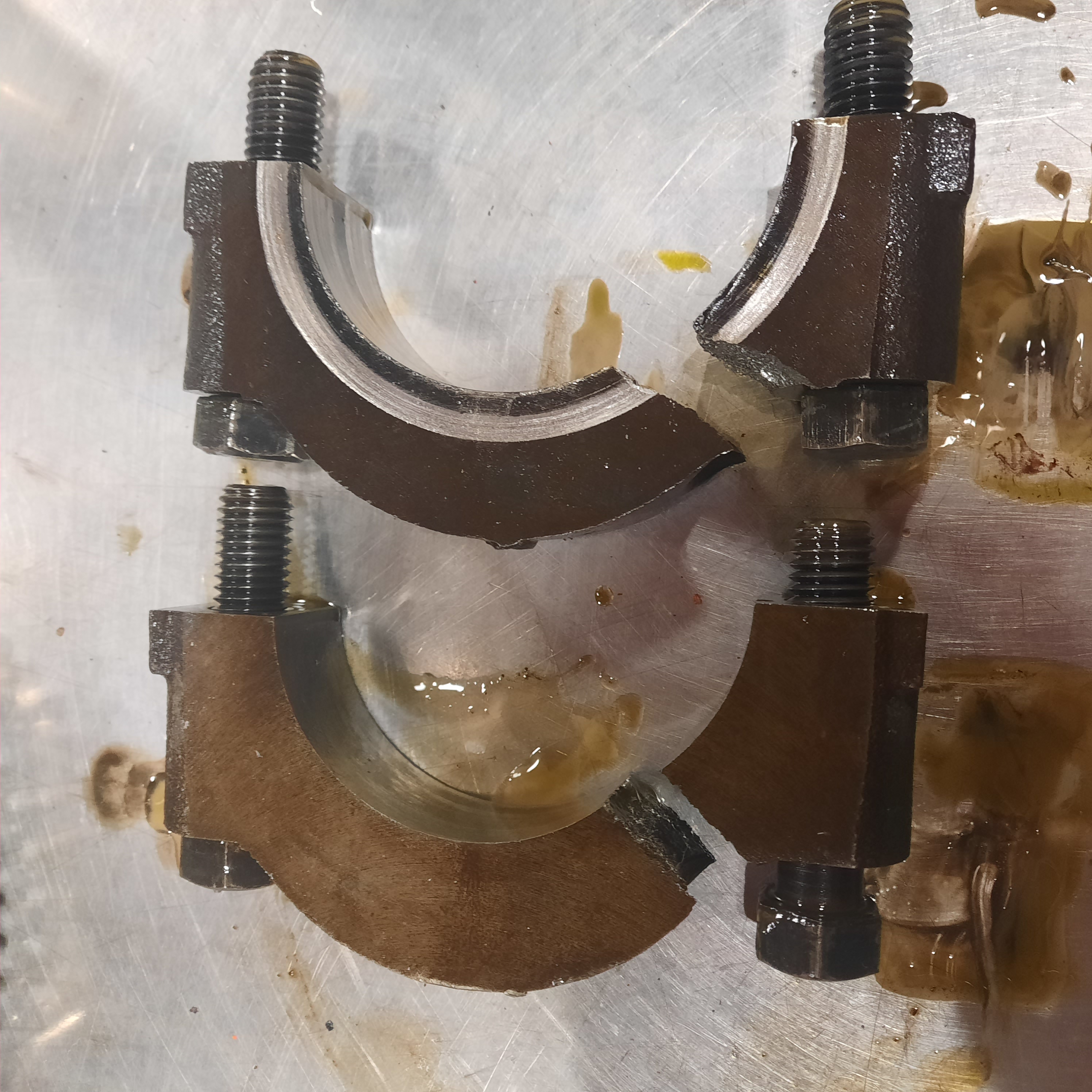

Had a little mishap the other weekend. Broke #1 and #2 main caps and split the block from the main saddle to the deck. This was on a D17 block. So if anyone would have a good block they are willing to part with please let me know. Closer to Wis the better. Thanks.

I've seen a number of 226 engines break those main caps. More than likely you block isn't damaged. If not, Get a machine shop to make a new set (all 3) from solid steel and then line bore them to match the block. We had to do that on a 226 that was turboed a few years ago. We also made them thicker and used studs.
OUCH... that aint good ..
