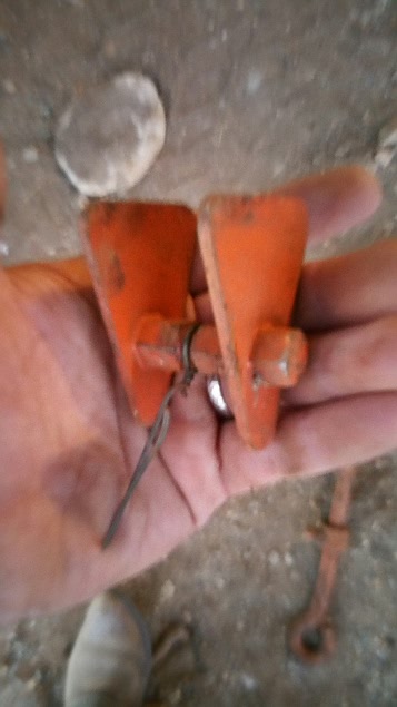

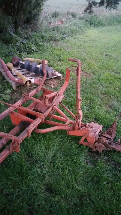

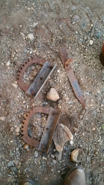

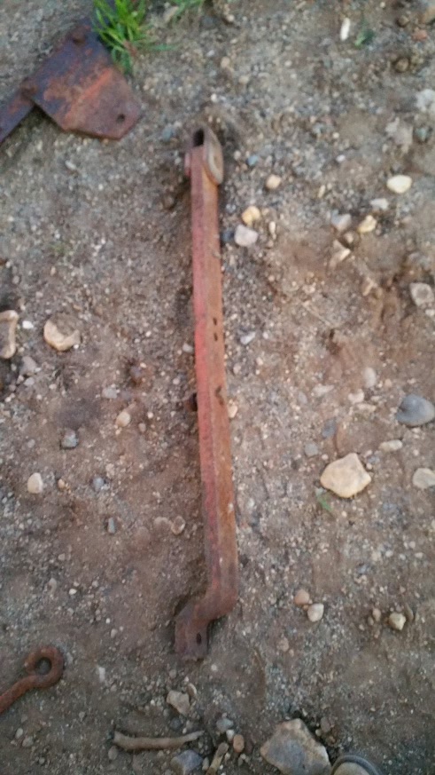

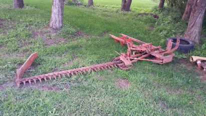

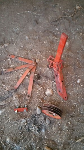

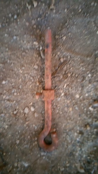

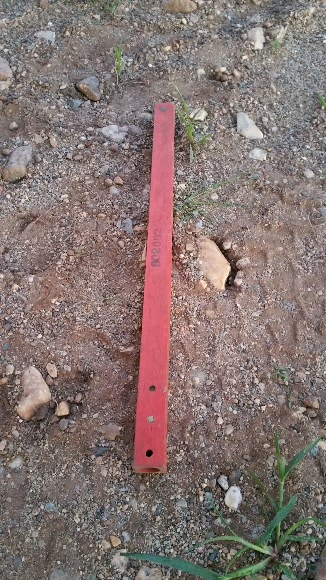

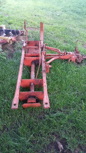

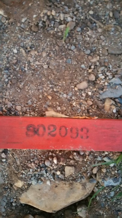

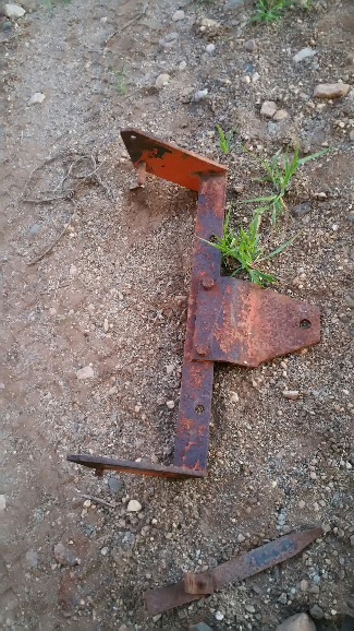

Ok...These are the loose items i got w the mower. If anyone can help identify that would be helpful. Also...hopefully some of these go towards mower mounting.
DakotaSteve View Drop Down
Joined: 26 Apr 2017
Location: SD
Points: 717
Post Options Post Options   Thanks (0) Thanks(0)   Quote DakotaSteve Quote  Post ReplyReply Direct Link To This Post Posted: 22 Aug 2017 at 8:47pm
Picture 1

Picture 2

Picture 3

Picture 4

Picture 5

Picture 6
Post Options Post Options   Thanks (0) Thanks(0)   Quote CTuckerNWIL Quote  Post ReplyReply Direct Link To This Post Posted: 22 Aug 2017 at 10:34pm
http://www.allischalmers.com/forum/uploads/16988/2017-08-22_20.37.04.jpg
I think this is what my book shows as an adapter for the Snap Couple CA.

Post Options Post Options   Thanks (0) Thanks(0)   Quote Bill Long Quote  Post ReplyReply Direct Link To This Post Posted: 23 Aug 2017 at 7:43pm
The triangle item is used on the pitman rod end that connects to the sickle bar blade.  You would have a special wrench that was used to release the tension on the sickle blade ball hook up and a wide other end that would spread the pitman rod ends so the pitman rod could be removed.
You have your twin belt pulley and the mounting brackets for a Snap Coupler CA.  The other items I am not certain what they do.
I do not see the attaching bolts for the rear draw-bar.  They came with a lot of heavy washers that could be added or removed to increase tension on the drive belt.
Send us pictures when you get it hooked up.  We sold a lot of the B-C mowers.  And since the Number 3 rear mounted mower and the number 7 came out we used them on the CA.
