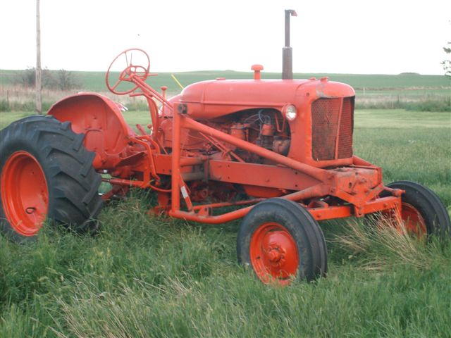

Hi Guy's, New to your forum and need your help already! Just bought my first Allis. I bought it as a 1949 wd.  I was pretty positive it wasn't a 49 ( I could see 50 and 51 dates), but to further confuse the situation, I went to pick up a loader for it today and the fellow had 6-7 wd's and wd-45's and 60 years of knowledge about them. While looking around at his piles of treasure's I started to wonder about the exact model I had purchased. The serial # on the rear end is WD47054 but the engine doesn't have the large plate on the side of the block like his WD's . Mine also has a distributor whereas his WD's were all mag's. His WD-45's looked like the exact engine, had a distributor.  How can I tell what I have? The only part I got for it so far was a starter drive which should be interchangeable...
Any help in deciphering this conundrum would be great!

WD  with an engine change.  The  45's had a gear shifter that was curved.

the curved shifter is not 100% proof.
This DOES have the straight shifter, and looks like it has the shorter head, so best guess is that this is a WD.
Get the serial number and google it online, and that will tell you for sure.
Now, looking at the oil filter canister, this also looks like it has the Leroi engine in it.
Its a little bit different than the Allis engine.
Good Luck.

You have a WD with a 201 Leroy engine in it.

Don, what gives it away as a LeRoi engine? There is a pair of them in some Bantom draglines at my local salvage yard. They look like AC's to me.

 Two of the things that tell me Leroy are the canister oil filter  and the timing cover.
This tractor has a WD45 gov and dist in it too.

Don't mean to sound like the correct police, but that loader frame is mounted about a foot too far forward.  No big deal unless you are lifting real heavy stuff or have short arms as you'll have a hard time reaching the trip lever.  Also, if thats the stock oil pressure gauge location, it's darn near worthless.  Would that engine have originally been on a power unit?

The Leroi engines have that canister oil filter, and alot of them don't have a thermostat, or even the location for a thermostat. The water manifold is just a straight shot up to the radiator hose.
There are also no markings on the block like the AC blocks have.
I had one in a WD45, and was NOT impressed with it. It had no power.
It was a 201 with the shorter head, and it did not do well on the dyno.

WD47054 is a 1949 WD, the straight shifter is always a WD. It also has had an engine swap and combine wheels put on it.

Leroi engine?  Never heard of such a thing.  When did A-C use them, for how long and what models?  Also noticed the rain cover on the exhaust is the opposite of mine.  Never noticed one installed like that.  Anyway, interesting pictures and post.  Going orange is going great!

1. AC never used the engine in their tractors. As mentioned before, this tractor has had an engine swap.
2. The rain flap won't catch on low hanging tree branches this way. And if you drive into a rain real fast it won't flood the engine through the exhaustLOL

Like CTucker said, that is how I was taught to put a rain cap on. Put one on backwards and a tree branch will bend or break it, put it on the right way and a tree branch just closes it till you're past it.

I went this last weekend and picked up a loaderforr it. It took less than 2 minutes to figure out the frame was way to far forward! The mount that's on it has been butchered in the front mounting plate area. The loader came as a complete assm. but I didn't put the new mount on yet. Didn't know which holes in the frame were the correct ones. Oh ya and the way it's cobbled on it would have taken all day just to knock the welds off!
Post Options Post Options   Thanks (0) Thanks(0)   Quote CTuckerNWIL Quote  Post ReplyReply Direct Link To This Post Posted: 24 Jul 2012 at 7:21am
That loader frame should bolt on with no welding if done properly.
