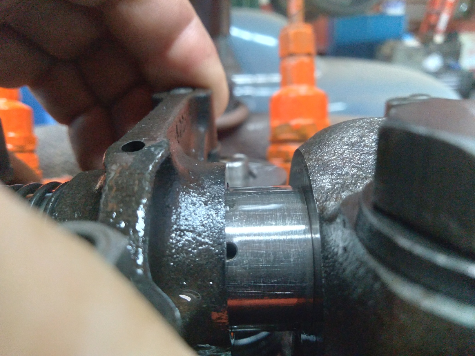

Is the oil hole in the rocker shaft oriented correctly? I put it together as taken apart but I don't know if the last guy who had it apart put it together right. This is the engine that had the valves in the wrong locations so I don't trust anything. Any help is appreciated.

I would think the hole should oriented toward the bottom as that would be the wear will occur.

does the oil come up thru an oil passage in the block and thru a hollow cam shaft holder and then into the hollow cam shaft ?? .... I think the hole in the cam shaft INSIDE the tower should line up to get max oil into the camshaft ???   Then see how to FOLLOWERS fit ?

The engine is a d2800 in my 180. According to the service manual the shaft should have camshaft side etched into it but I can't see it. As it is there isn't much oil moving around in the top end. The tappet cover is dry. I would think more oil should be flying around up there.

If I remember correctly, it is right.
The reason for a return tube was to return oil down front push rod  hole to keep from fluding top of head.                     MACK

The rocker shaft is in right. I found the cam side etching where the book shows it. Very faint but it's there.
I am going to change the rocker shaft plugs and restrict the drain line. Hopefully that will help with oiling.
