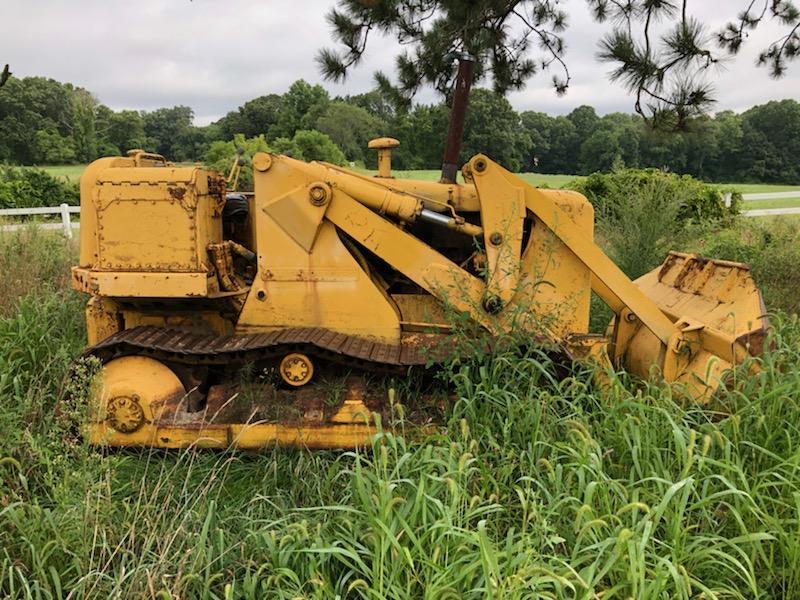

Dear Friends,  I'm new here and hoping for some help.  I'm looking to purchse a Allis Chalmers crawler loader but don't know the year and model.  I have yet to see it in person and would like to do some research ahead of time.  It looks like it could/might be a model HD-6G?  Besides some painted decals or insignias, which I think are gone,  will there be any other identification numbers that will positively ID this machine and the year it was made?  Supposedly it runs and drives fine.   Whats the most I should pay?  What major things should I be concerned about and be looking for when the time comes?  Thank you in advance,  Steve

yes late 6g by late design tilt linkage.

Thank you CAL,  any way to nail down the year?   Thanks.  Steve

Post Options Post Options   Thanks (0) Thanks(0)   Quote CAL(KS) Quote  Post ReplyReply Direct Link To This Post Posted: 11 Sep 2019 at 10:00am
serial # on dash plaque

Ok.  Thanks.  If dash plaque and serial number are present, is DOM encoded within or is there a listing somewhere that shows DOM by serial #.  Thanks.

Post Options Post Options   Thanks (0) Thanks(0)   Quote CAL(KS) Quote  Post ReplyReply Direct Link To This Post Posted: 11 Sep 2019 at 10:55am
its not encoded the serial # list will tell what year depending on number.  you wont know without the list.

Post Options Post Options   Thanks (0) Thanks(0)   Quote Ray54 Quote  Post ReplyReply Direct Link To This Post Posted: 11 Sep 2019 at 11:34am
If it runs and operates the next thing is undercarriage condtion. Good tractor but parts will take hunting for so ................ look close at condition.

Post Options Post Options   Thanks (0) Thanks(0)   Quote CAL(KS) Quote  Post ReplyReply Direct Link To This Post Posted: 12 Sep 2019 at 8:37am
OK, i brought my books with me today.  That machine has the second type of shovel frame which started at serial #11094,  third type was introduced at #15791.  that should put this machine at mid 59'-mid 62'.  should have energy cell head (injector goes in side of head) as the direct inject engines were phased in in 1963.

Post Options Post Options   Thanks (0) Thanks(0)   Quote HD6 Merv Quote  Post ReplyReply Direct Link To This Post Posted: 13 Sep 2019 at 12:24am
6000 motor was fitted at 13322. In 1960.
tits tyres and tracks
they all cost you money

Post Options Post Options   Thanks (0) Thanks(0)   Quote CAL(KS) Quote  Post ReplyReply Direct Link To This Post Posted: 13 Sep 2019 at 7:13am
Hmm. It appears Terry Dean is incorrect then!LOL   i should have double checked the parts book
