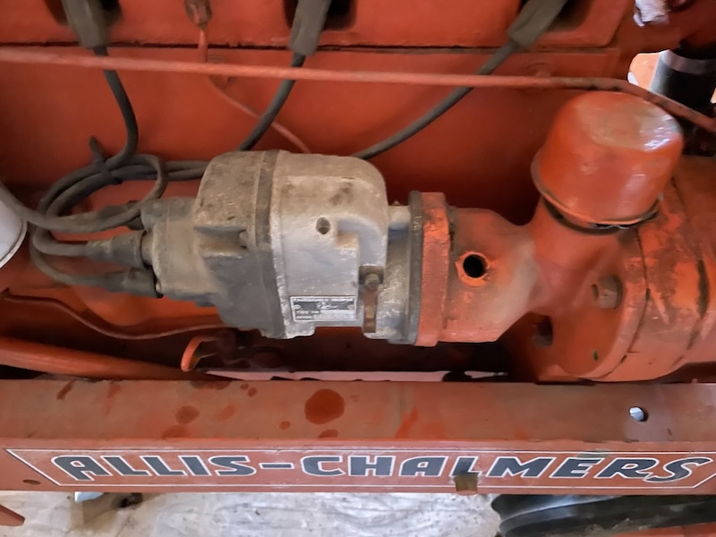

I recently acquired my WC after my older brother passed. The tractor was restored about 15 years ago by the local FFA chapter (my brother actually won it on a raffle). He drove it in a parade or two before shed storing in 2015 (ish). I've cleaned the fuel tank, replaced the fuel filter, fuel line, and carburetor, along with using new premium gasoline.
However, I cannot get any ignition of the fuel. I sprayed a little starting fluid into the intake manifold, and I get "no joy".
I assume the issue is with the magneto, condenser, points, or distributor. I'd very much appreciate some guidance on where to start "exploring".
Also, I've attached a picture of the mag side of the tractor. Notice the "hole" to the left of the oil fill. According to my parts book, the piece with the hole in it is the magneto bracket. Is there supposed to be anything in that "hole"?
Thanks in advance
-Mark

I suspect the points need cleaning in the magneto. That would be the first thing I would try.  They get a little corrosion on them from sitting a long time.
Points: 90653
Post Options Post Options   Thanks (0) Thanks(0)   Quote steve(ill) Quote  Post ReplyReply Direct Link To This Post Posted: 20 Oct 2024 at 6:14pm
yep... the black cover needs to come off the mag.... clean the point contacts, an put it back together... Read up a little bit first... The cover needs to go back on with the two little gears TIMED RIGHT inside..

As mentioned, sitting that long the points have oxidation on them. Some TV tuner cleaner or Brakekleen on a rag, and run the rag through the points a couple times. The ole' girl will probably fire right up once back in time correctly..

The hole is normal....

    So far  anyone who seen  the question about the hole HAS  never replaced a seal  in the housing . There is also a opening in the bottom of housing .
    I have replace many of these seals over the years .
   Once you static time your mag ,moving it around  is not a good idea. It's not a
 dist. .
Edited by Fred in Pa - 21 Oct 2024 at 3:03pm
nonetheless ,still dead.

With a fair amount of messing around - I got the magento points cleaned, magento timed internally (it was one or two teeth off), the distributor timed to the fly wheel fire position, new plugs, new fuel filter, new fuel line, a rebuilt carburetor, AND it runs!
1935 WC running again after 12+ years!
What is the copper tab off the side of the magneto for?

the copper tab is the KILL switch.. If you push it and touch the mag case, it shorts out the spark and engine dies............ Magnitos should be timed to  TDC  , top dead center so it will START easy... after the engine starts, the MAG will advance to the FIRE mark.. You can see that if you have a strobe light.
For the hose... you can wrap a few layers of duct tape on the tube and build it up to the correct size for the hose to slide over.
