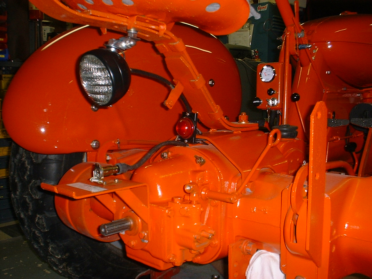

Post Options Post Options   Thanks (0) Thanks(0)   Quote Steve in NJ Quote  Post ReplyReply Direct Link To This Post Posted: 12 Jun 2024 at 9:09am
Years back when I had my IB, I used WD fenders as well. They needed quite a bit of work to make em' fit nice. I'm not a body man so I had my body guy change em' over for me. He had to weld in the center plate, fill some of the WD holes and drill some new holes. I gave him the old IB fenders to use as patterns and to take measurements off of them. They came out nice, but they weren't a "drop on".
