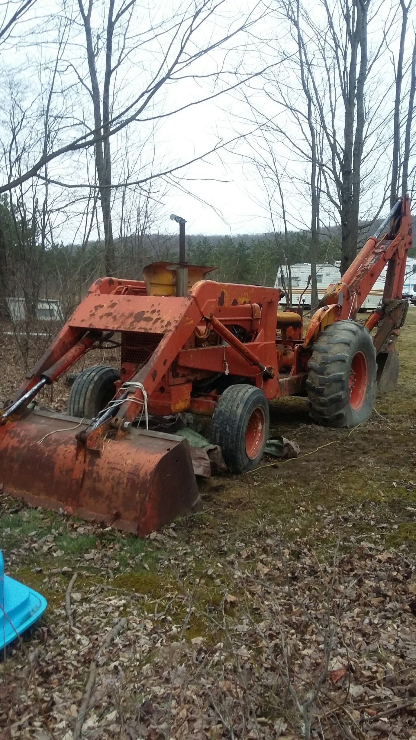

Here is a picture of the Backhoe.  Also I have not been able to locate a replacement manifold heater for this unit.  Any help would be appreciated.

Somebody had one of them air horn preheaters on here, of late...  That's an I-600.  If you want it to start easier, put a tank type recirculating preheater on it, and plug it in for a half hour prior to starting...  If you want to adjust the pump timing, obtain an engine manual for a D-15 diesel farm tractor, and it'll describe the procedure.  Involves loosening the pump, and turning it slightly...
