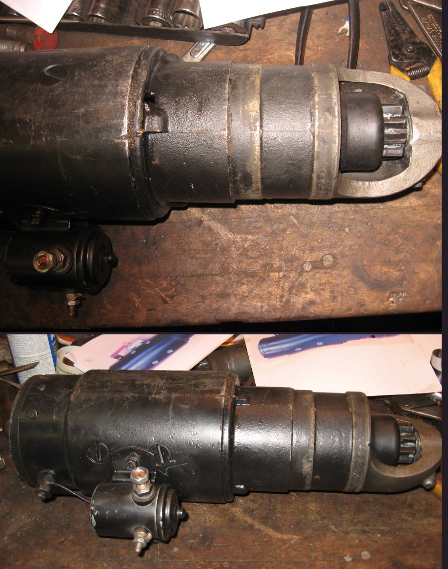

I do know that the rebuild shop worked on the starter drive unit on the front,
so I do not know if they put something back wrong or used a wrong part etc.
The drive gear on the starter remains in the "out position"
it is not retracted when I installed it, I can push the gear and it feels like a spring returns it to the out position
shouldn't it be retracted so it does not spin when the engine is running?

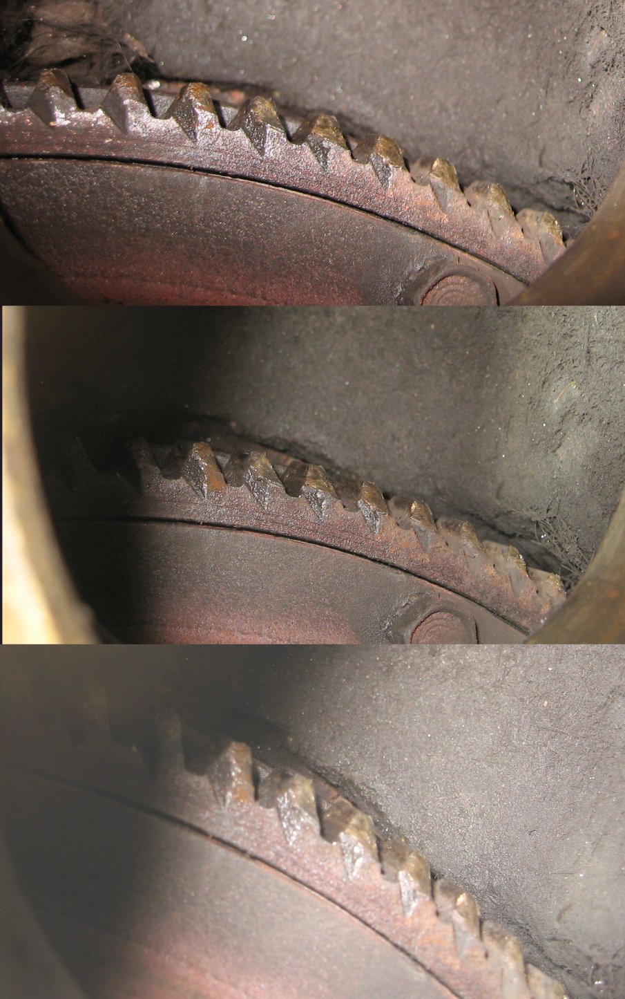

There is wear on the outer bevel of the ring gear and I am posting pictures of it below,
does this look like the problem? does the starter only engage the outer portion of the ring gear?

also, when installing the starter I noticed the hole in the side
that the tapered bolt goes in to hold it
keeps the starter about 3/8" - 1/2" away from seating tightly against the engine housing, should it be spaced away like this?
 (I am not sure if the shop re-used the old nose piece or if they replaced it)
any opinions would be appreciated!
are these teeth to worn looking to engage?
notice how the starter's drive gear is in the "out position"
should this gear be retracted when installed?

Ring gear is toast.  Never seen one wore that bad...Wink

If cannot find a ring gear have a engine shop gently remove the old one, rotate it about 1/8-1/3 turn in either direction and reinstall. Maybe have a welder tig the worst teeth then dress with a file. 4 cylinder engines will stop within a few teeth of two spots(either side of tdc) on the flywheel a six three and a v-8 four due to compression on opposing cylinders.

Thanks guys,
well it looks like I need to pull the engine
to deal with this ring gear
does it it seems to be the likely issue in the opinion of eveyone?
Do you all think the starter gear is in the correct position for install?
or should it be retracted
and then move out only when starting?
I still find it hard to believe that it does nothing (grind etc.) when installed
it looks to me like approx. the only outer 1/3 rd of the teeth are worn,
does the starter only engage to only 1/3 rd of the teeth?
is it possible that the "geometry" of the cone was changed when it was rebuilt
(wrong new parts etc)
so that it no longer makes contact with the ring gear?

Get the starter drive fixed - the ring gear should work - least i would not be splitting the tractor to replace UNLESS starter drive does not mesh at all .
 Your re-builder screwed up something as that  drive should be retracted and spin out when motor is energized

Try Sandy Lake equipment, they should be able to get you one.
Yes you can reverse it, but it's a lot of work, to back grind it by hand, and if one tooth is missed, guess where it will stick at...
Your old starter drive gear was prolly pretty worn, so it might have grabbed better, on the wore out teeth...

update:
I spent some time in my shop investigating the starter
and found that the "clutch Drive" / ratchet piece on the end is working wrong!
I can stop the gear from spinning with my fingers while the starter is running!
I think the starter is supposed to be a CCW (counter clock wise rotation)
and that the "clutch ratchet"
he installed must be for a "clock wise" running starter
or the starter is rotating backwards?
(anyone know which end / orientation you should look at to determine the rotation?
 ccw / cw
now I'm thinking I wont have to pull the motor!
................................I'm doing a happy dance!

Dozer,
the "wire" you see is actually an approx. 1/2" wide flat strip of metal
that the main battery power runs through ( it looks thin from the side)

The Ring gear looks good condition from my angle.

The starter mounts to the rear of the engine
I brought the starter back to the re-builder,
he never noticed that it is a ccw turning starter
(so it needs a different drive unit installed /backward ratchet mechanism)
hopefully the i60 will be up and running by the weeks end
