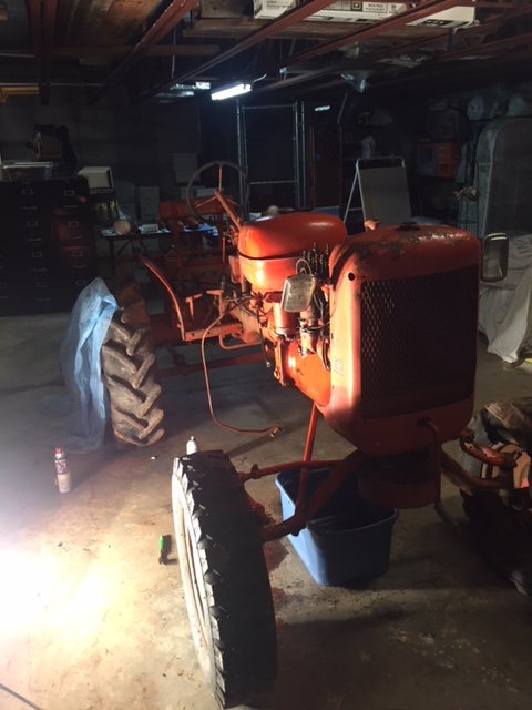

I've had my C for about a month or so, and have been working on it with the help of many posts here on "The Forum".  I'll try to get some pictures up and look forward to everyone's input...I think I've found the right place for answers and expertise. Thanks

Apologies in advance if the photo is huge, I suppose I'll learn as I go.

That is a very good looking C.  It has the axle of a B but looking at the rear wheels one can see it is for two rows cultivation - wider than a B.  You can be certain for looking at the other side.  You will find a steering connecting rod coming from the steering gear box that is usually longer and goes up.  The B Steering connecting rod goes down
In any event you have what I believe is the best looking tractor Allis Chalmers made.

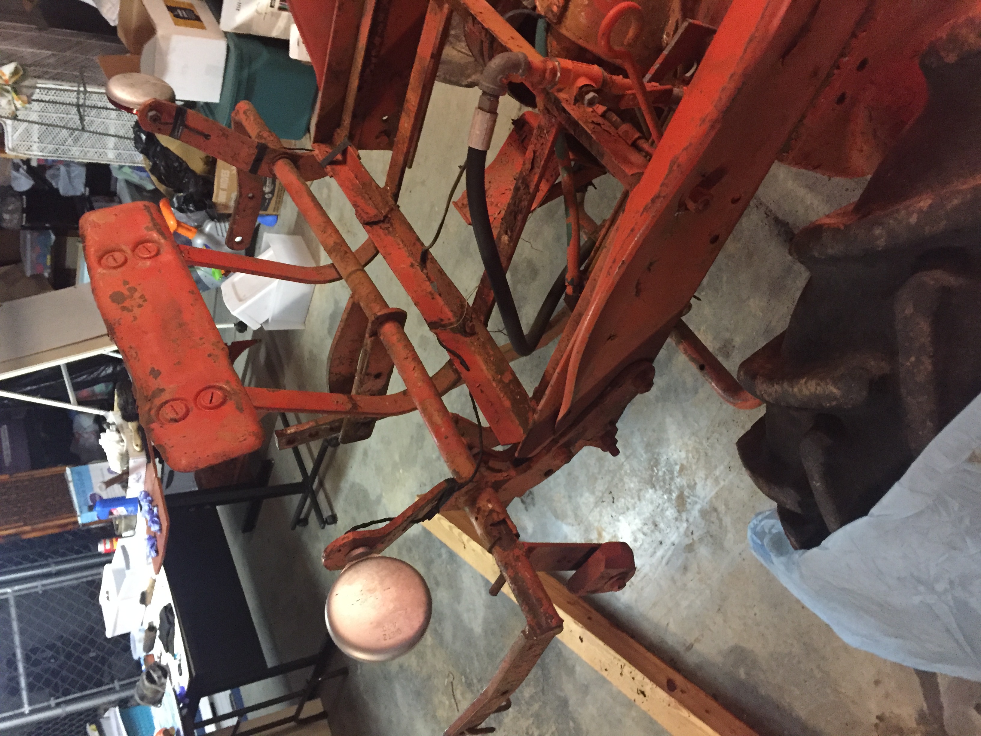

Thanks for the input already. I’d just like to hear it run then see where to take it from there. Here’s a pic of some of the back. Stock? Homemade?

Post Options Post Options   Thanks (0) Thanks(0)   Quote Ted J Quote  Post ReplyReply Direct Link To This Post Posted: 12 Mar 2018 at 6:30pm
WELCOME!!!  You've got a gem there and you will love it as much as I love my C.
I can't see well enough to help you on your starter issue.  You'll have to post a better pic.  That starter doesn't look at all like mine on my C.  Do a search and you will find a LOT of info on these starters and their problems.

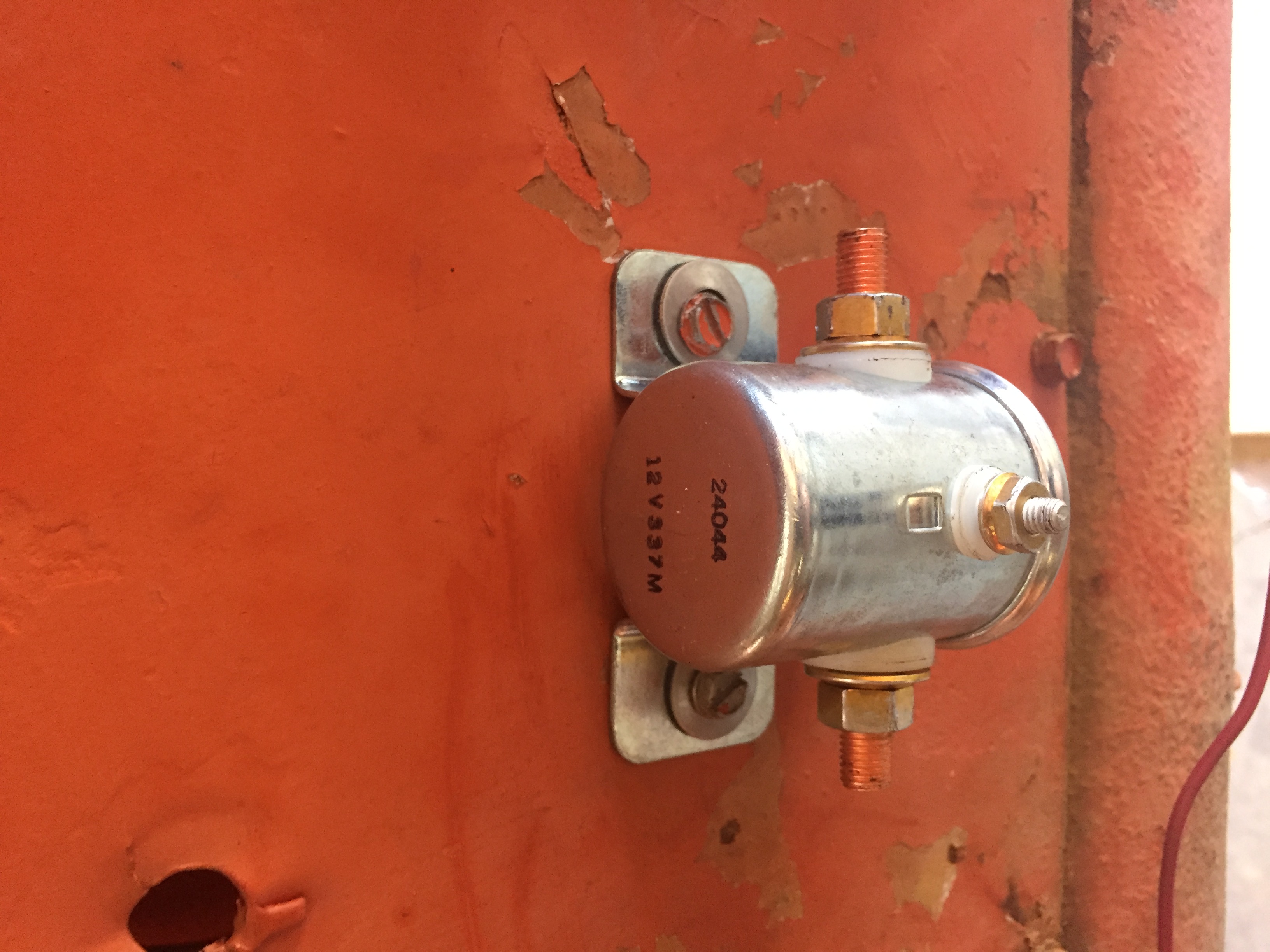

Points: 90804
Post Options Post Options   Thanks (0) Thanks(0)   Quote steve(ill) Quote  Post ReplyReply Direct Link To This Post Posted: 12 Mar 2018 at 7:40pm
redbird--- the ORIGINAL starters had a contact switch mounted to the starter. You pushed a rod inward and it made the contacts touch and the hot wire from the battery was then energized to the starter motor.
your motor seems to have the contact switch removed and a POST added in its place.. So YES, you should be able to use a remote solenoid with a wire to the starter.. Then a button or key switch to energize the solenoid... just like a car or riding lawn mower.

Post Options Post Options   Thanks (0) Thanks(0)   Quote redbirds Quote  Post ReplyReply Direct Link To This Post Posted: 12 Mar 2018 at 7:59pm
Great, Steve. Thanks for looking and commenting. That is how I think I’d like for it to operate, if possible. I found a diagram for wiring and will lay it out to see if I’m on track.

Post Options Post Options   Thanks (0) Thanks(0)   Quote redbirds Quote  Post ReplyReply Direct Link To This Post Posted: 12 Mar 2018 at 8:07pm
New 12v solenoid for this process.
