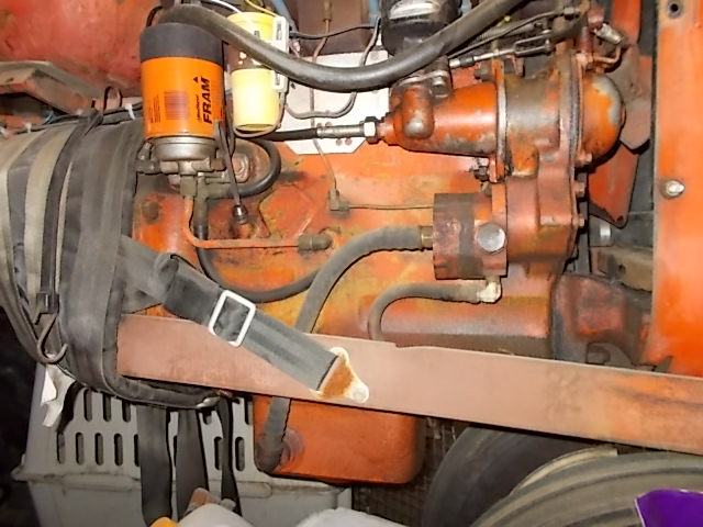

This is crazy and amazing!! Have I60 apparently same as D15. Got running after previous owner had sitting for 14 years. Changed all oils and checking out the top end have no oil getting pumped to head. Cleaned every line and fittings. And found the port in block that feeds the head has no hole to pump oil out of it ??? How could this have servived. And where is the hole supposed to be located in that port?? Any help would be greatly appreciated. Thank you.

Hey Joe(cmo). Yes has lots of oil pressure! Going off of the original gauge thats in the I60,but I want to check it with another gauge. When I was loosening connections to check flow it doesn't seem to be a high pressure system. As PaulB mentioned the oil isn't getting past the camshaft. There's no hole in the port ? That feeds the line going to the head to feed the rocker arm rail.

You may have either a cam bearing that wasn't lined up or even drilled out. This is a side right side view of the D10 with a turbo that I have, It has full flow oiling and except for the added oil lines at the filter should be the same as yours.
 The big line from the bottom of the filter feeds the engine. The smaller line above it feeds the top end and the governor.  If you remove both of these fittings and crank the engine , you should see the camshaft turn.
  Post a picture of the right side of your engine.

A turbo, that's awesome.yah it's the same configuration,the small port just has no hole in it,for oil to flow out of block?? I'm wondering where it's supposed to be located in that port?? I'll try and post short video of me digging in port.
