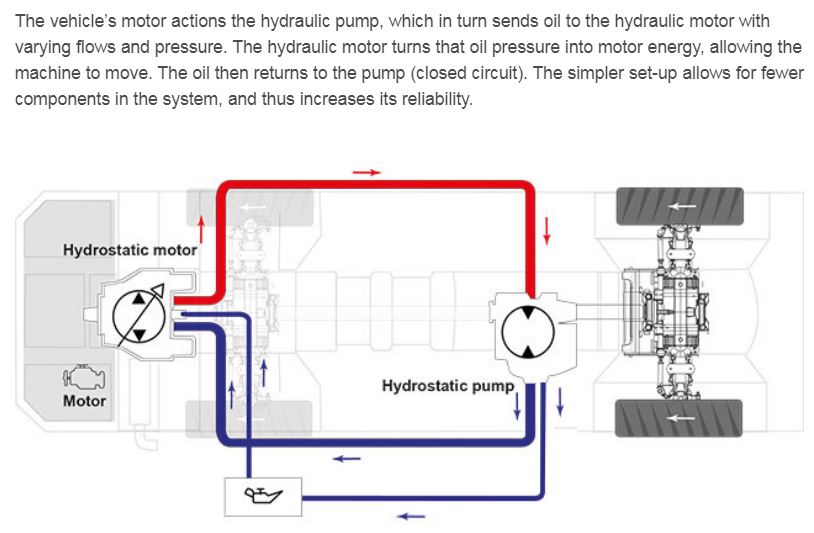

a hydro is normally a hydraulic motor connected to the gearbox / drive wheel... basically a hydraulic pump pushes oil thru a hydraulic motor ( basically a pump running backward) to get power..
CVT is continuous variable transmission... I can be as simple as a spring loaded pulley on the end of the motor that changes diameter as the engine speeds up ( more RPM) and there by changing the gearing to the rear axle or drive wheel.

Steve
In your hydraulic schematic, what is the difference between the 'Motor' and the 'Hydrostatic motor' above it ?

Originally posted by Gary Gary wrote:
Steve
Old Snowmobiles are a good example of Variable Speed Belt Drive.
G
Thinking "motor" is engine.

Gary, i think you caught on to something... The  GAS or ELECTRIC motor should drive a HYDRAULIC PUMP (  the picture is miss marked)... the PUMP should send high pressure oil to a HYDRAULIC MOTOR which might look something like the HYDRAULIC PUMP, but a motor is different that you put HIGH PRESSURE OIL INTO IT, and get Mechanical Drive Power out of it to the wheels..
The diagram paragraph explanation is correct, but the MISS MARKED the Hydra motor and hydra pump.

Post Options Post Options   Thanks (0) Thanks(0)   Quote Gary Quote  Post ReplyReply Direct Link To This Post Posted: 29 Apr 2021 at 4:28pm
Ya Steve, I'd agree. Some kind of Motor drives a Hydraulic Pump.
The pressured oil then drives the Hydrostatic Transmission.
