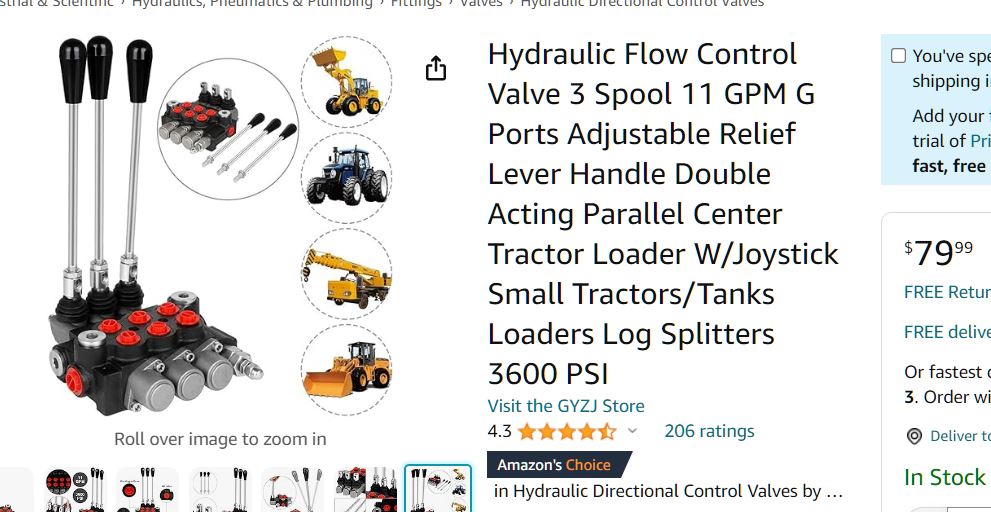

the simple way is to buy a NEW STACK VALVE that has 3 sections to run the loader lift, loader tilt, and rear implement... something like this.
