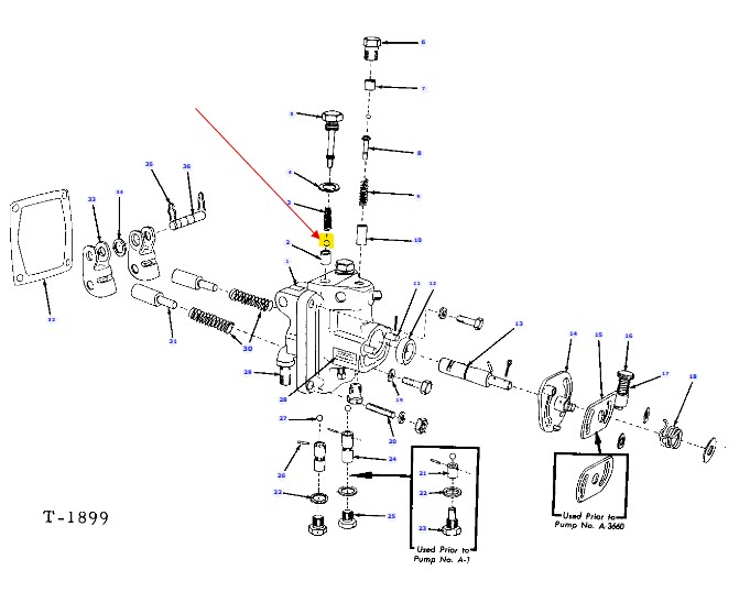

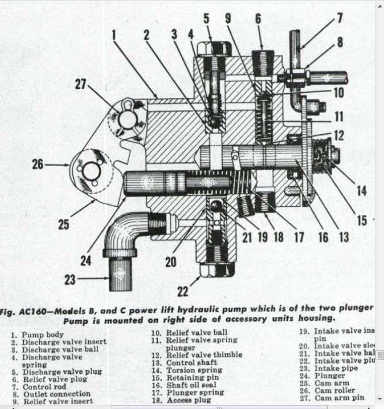

On the hydraulic pump of the model C ; there are 4 balls
- 2 balls for intake valve item 27 , ref number 70915904 , 5/16" , is it correct?
- Another one are the 2 discharge valve ball. Also 70915904 , 5/16" , is it correct?
- And the last, Releif Valve item N° 7 reference 70915906 . This should be smaller only 3/16" does this size correct ( the others are 5/16")

i think #3 and #21 ( intake and discharge) are the same size... #10 is smaller.. i dont remember the diameter.

Takes 4 70915904 Balls for intake and discharge 5/16 and 1 70915906  for relief valve 3/16
