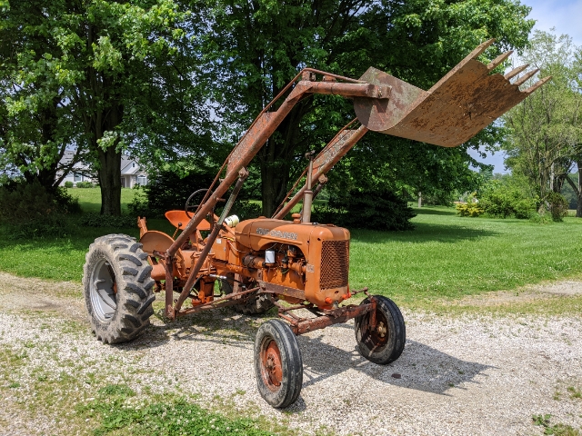

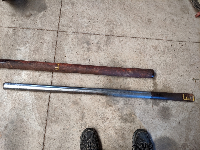

Alright, here's a couple pictures
I just want the right amount of hydraulic oil in system for these cylinders and I'm wanting to know the best method to do so...

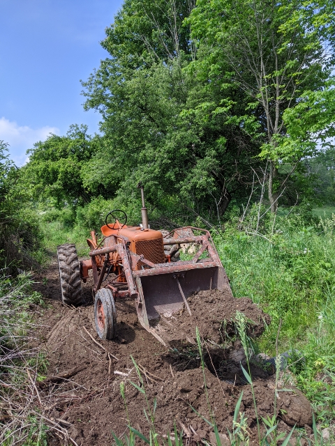

Got it completed and did it first little project on the farm (backfilled a new culvert)
It works even better than I had hoped!
Thanks to everyone for your information helping me get this done...
