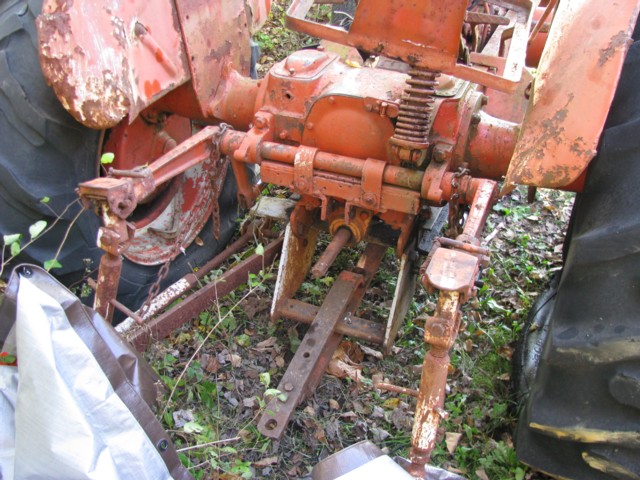

Both of my hydraulic cylinders on my tractor have bad seals/packing, so I'm looking for a place where I can get the kit and replace them my self. There is a place near me, but they are a little to expensive for my pocket. I know other places where I can get the whole rebuilt cylinder, but thats to rich for me also. Does any one know where I can find the parts? Thanks for the Help.

When the cylinders were on the tractor I could pull the ram in and out of the sleeve by hand. I tried to loosen the nuts, but they are rusted on I think. I am not to the hydraulic parts yet, but I thought I'd ask so I have an idea of where to go and what to do when I get there. For the hydraulic, anythin over $150 is a little to expensive.

My tractor is a 1956 WD45.
