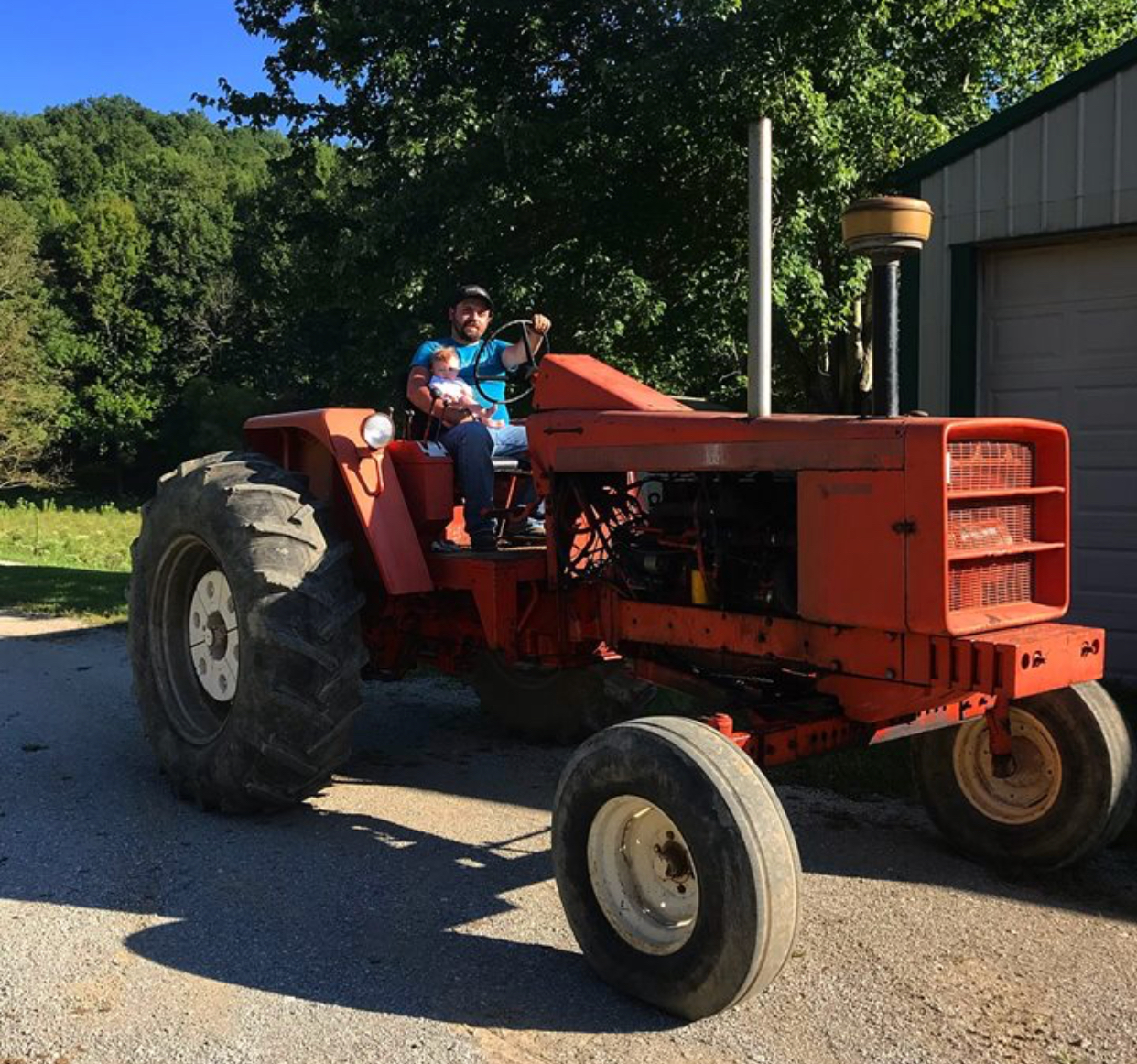

Hey guys! Long time no see. I recently acquired a 1967 190XT series 1 and am in the process of fixing it back into useable condition. I found that it has 2 holes in the turbo and will need to replace it. I found a HY35 off a Cummins ISB at a very good deal but will it fit under the hood without having to cut a hump?
Thanks guys and here’s a pic of the new ride and my 3 month old daughter.
