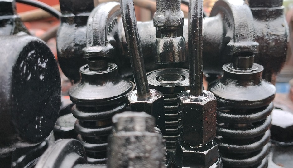

Looks like I'll be in for  learning curve on a 2-71.  Rack won't move, and a big gap between top of injector plunger and injector rocker arm on one injector. Don't think that is right.
 Injector plunger stuck
