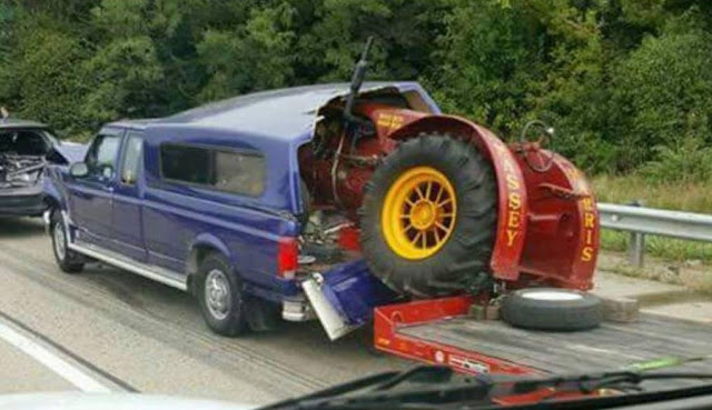

Why in the world he tried to load that tractor in that bed is beyond me! It seems rather obvious it wasn't going to fit in there and besides, looks like he had a perfectly good, and empty trailer to put it on anyhow!

Maybe it's Dimbulb or Trammy.Wink

This guy probably said, "I've always done it that way. it always worked before."

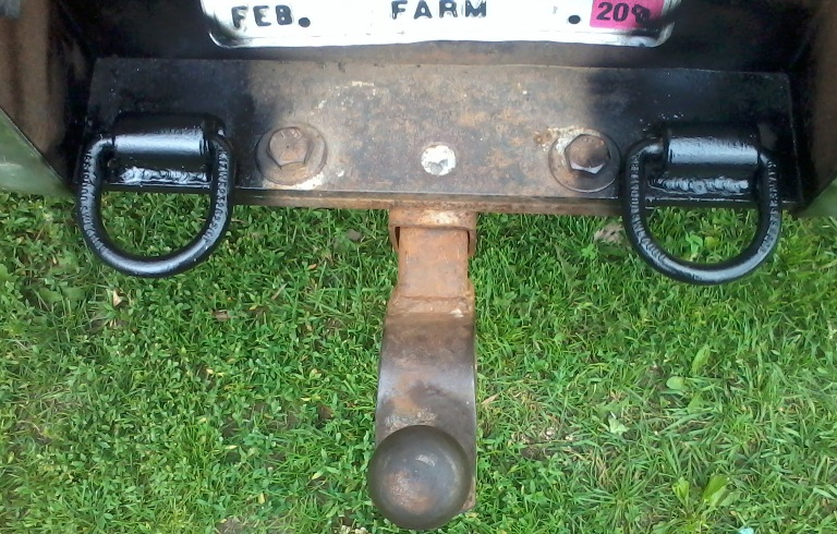

I have hauled tractors for years without a problem.
I tighten the chain that hooks toward the front of the trailer with the power of the tractor and lock down the brakes. I then chain bind the tractor with chains hooked to the rear of the trailer. I use a three foot cheater pipe on my binders and want to see tires squash when the binder locks over.
I thought I had a picture of the back end of a load that the chains were clear but I guess not.
The only picture of the back was one loaded to come back 1500 miles from Idabel Oklahoma.
