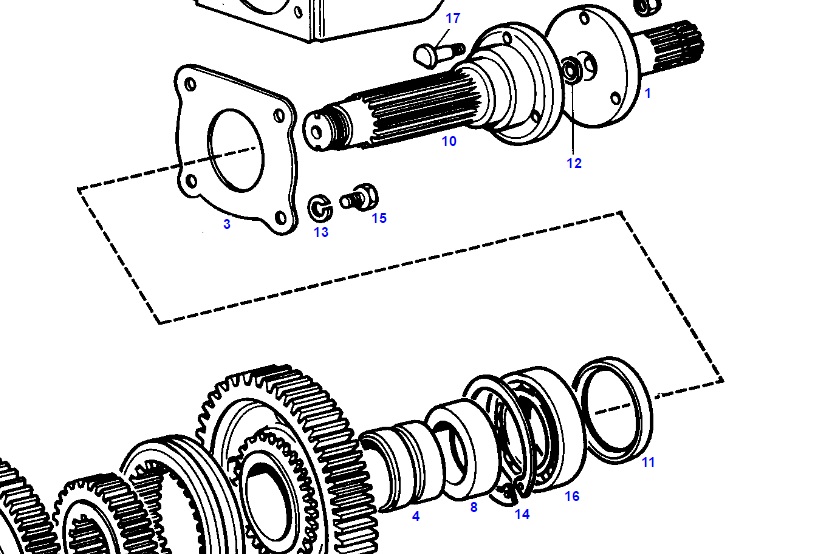

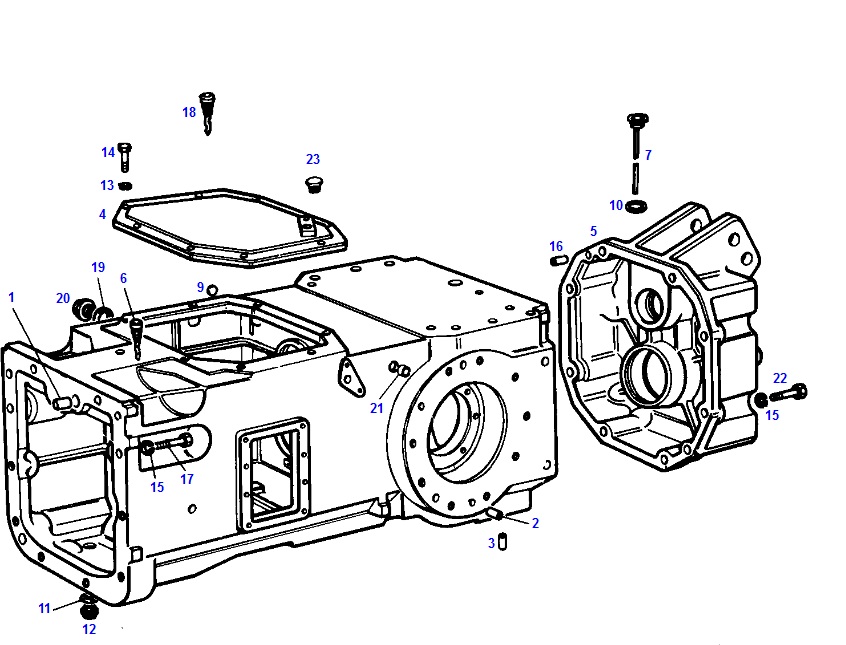

Okay so it looks like i just remove these 9 bolts.  There is no gasket listed between the cover and the case.  Is there a gasket there?  How does it not leak if there is no gasket?  Do i need to use rtv ultra black to make one?
Could someone give me a loose guideline on this?
1) Drain diff oil
2) remove rear cover
3) Is that #11 seal just right there?  Is it possible something else is the problem?

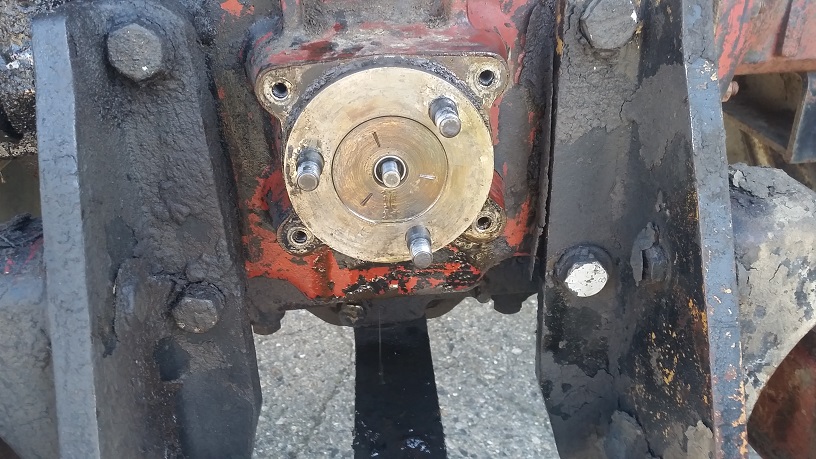

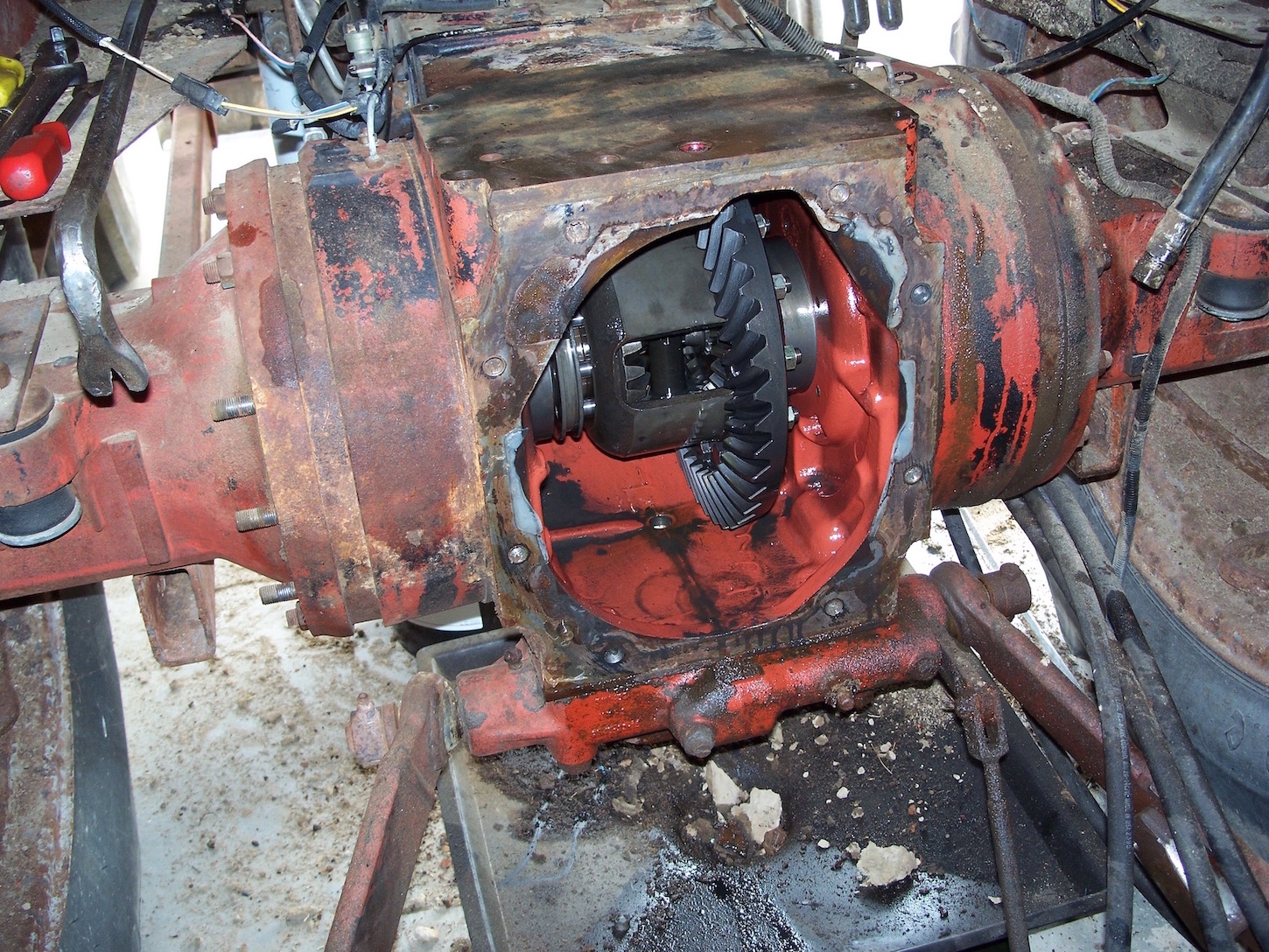

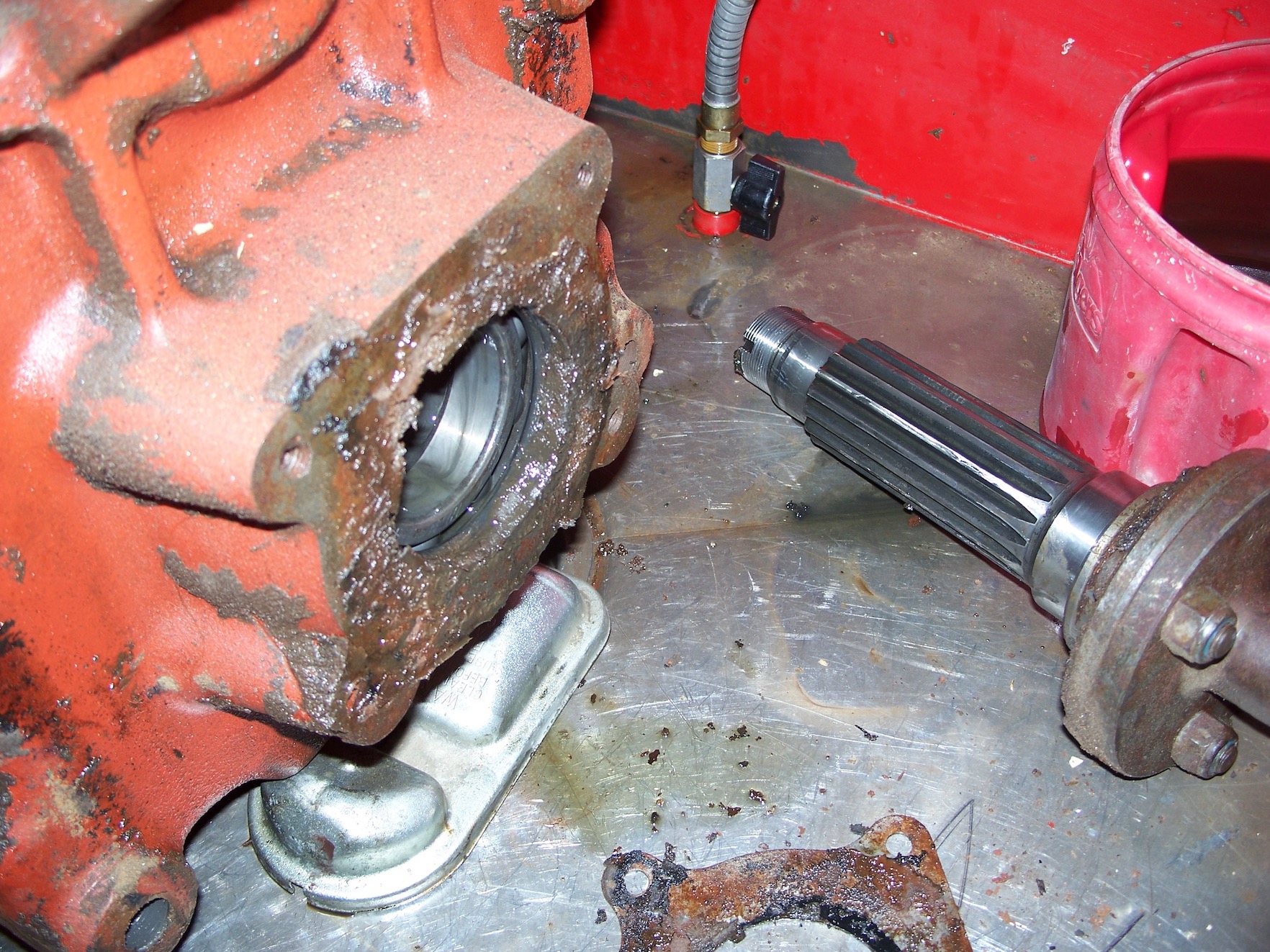

I had to do that little while ago on my 6080.  Lot of work for 1 seal.  Mine was slowly dripping even when shut off, so it had to be done.  Make sure the PTO disconnect (Left side by seat) is engaged.  That way the coupler won't fall down when you pull the rear assembly.  There is a long PTO shaft that goes over the top of the ring gear that will come out with the unit.  I only took a few pictures.  Here is what is left after you pull the rear unit.
It has silocone on it from the factory, you can see some of it left.  I use aerobic sealer, much better product, also a little more expensive.
This is what the shaft looks like when you get it out.  I didn't take any more pictures.

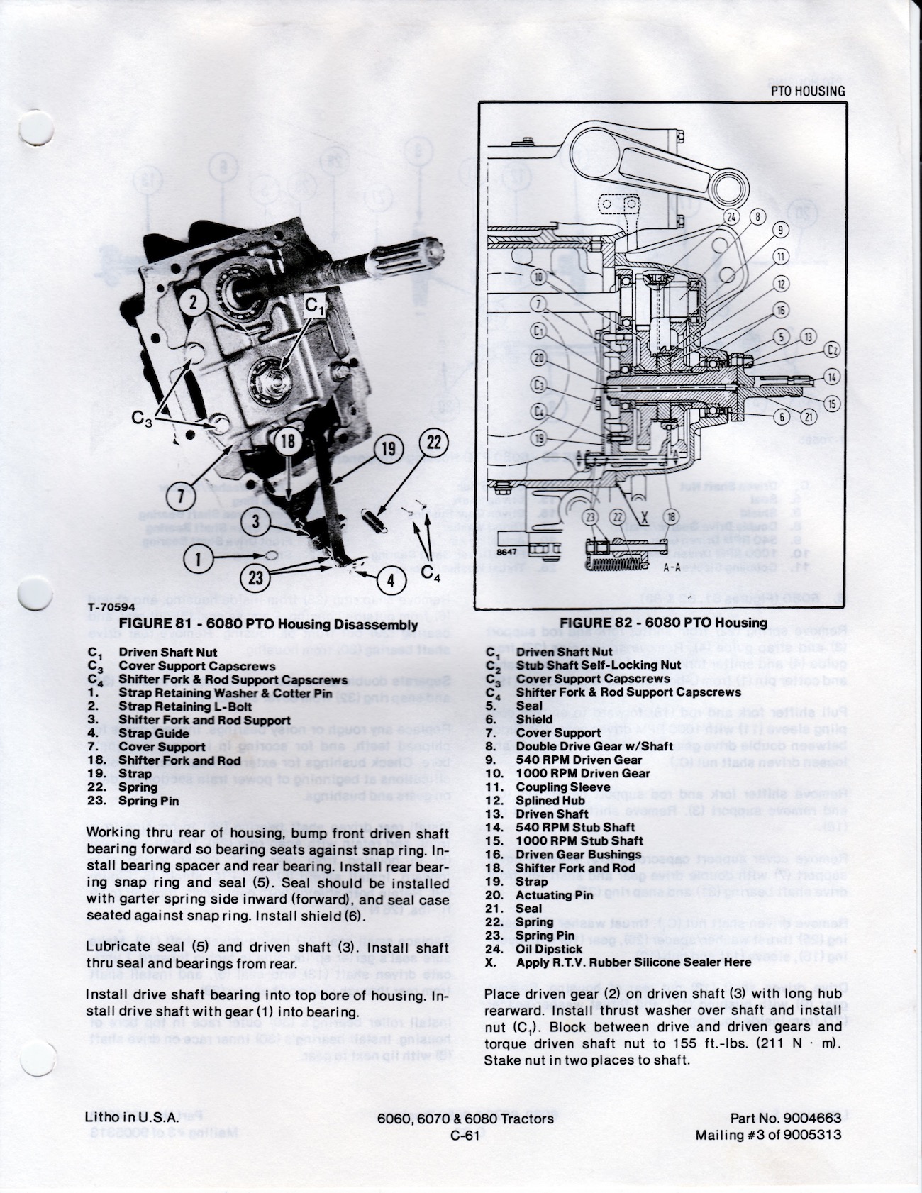

Here is a picture form the service manual that shows the backside with the long shaft sticking out. Once you get it off it is pretty straight forward to get at the seal.

I didn't spell it right or it could be that stupid auto correct.  Here is a picture of the sealer.
It goes on really thin, don't put it on heavy like RTV.  Seals very well on thick surfaces.  I use it on gaskets also for a little extra piece of mind.

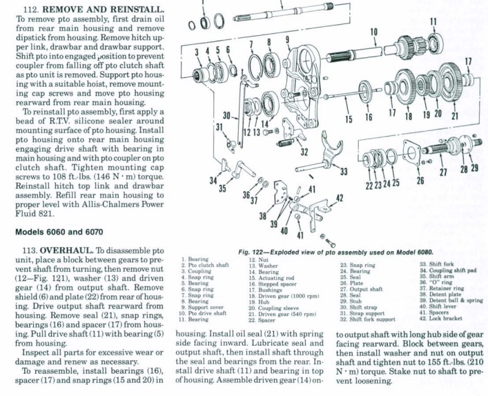

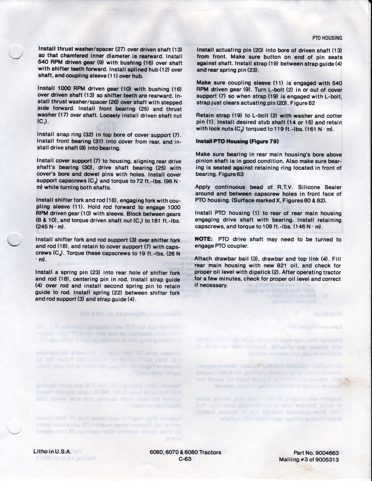

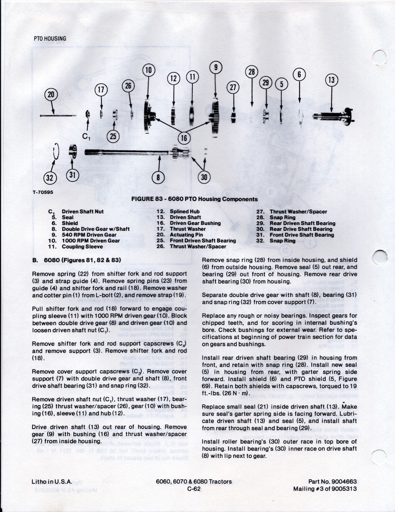

Here are the other 2 pages of the FSM regarding the PTO.  In case you need it.
