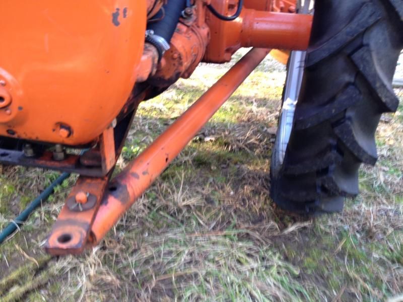

I'm looking for some pictures on how to install the disc plow on my 48 G. Specifically how it bolts by your feet and where on the draw bar. Thanks!

see if these help, if you need more just let me know -

Those are exactly what I needed! Thank you Joe!
