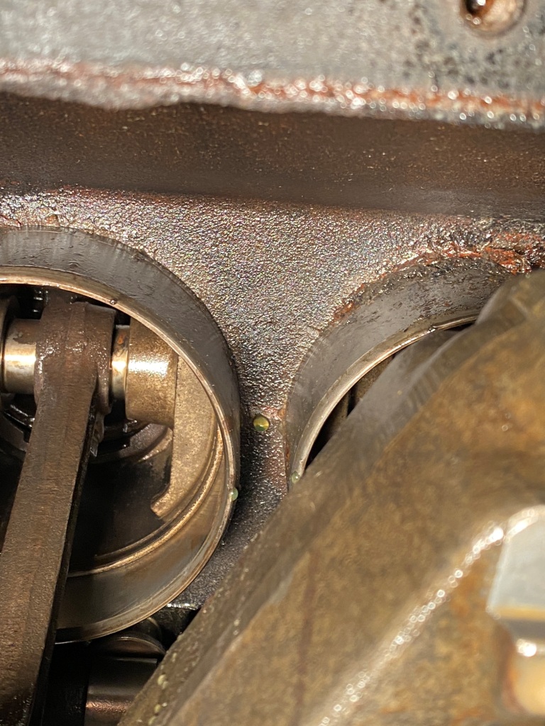

What are the chances that both sleeve rings have failed on sleeve 3 & 4 and the block is not cracked?

What are the odds that four Orings have failed on TWO sleeves exactly in the center of the block right where the blocks are known to crack ??

Yeah, that's what I was thinking.  This block is junk then correct?

Kinda looks like the one cylinder has been leaking for awhile according to the rust around the sleeve at the block. Did you pressure test it?

Probably junk.

Pressured up to 15psi and started dripping.  Lost pressure within 5 minutes.

It may be junk but the only way to know is to tear it apart. A few hours of work and you will know.

has anyone ever tried any BLOCK SEALER in this application... Either something like BARS that you pour into the antifreeze and run it... or a liquid you pour in around the liners and let it harden around the base ? ( when the block is empty and head is off )..

i would like to see bad the pitting is right around the orings  my series 4 engine  block my might be to bad to keep mine sealed  sealed up , dont know if any thing can be done down in the bottom of the counter bores

It sounds like your pressure test found the issue. Were you getting coolant in the oil? Gray foamy stuff under the valve cover?

Gray foam yes.  Looking for a new block that wouldn't too far of a drive.
