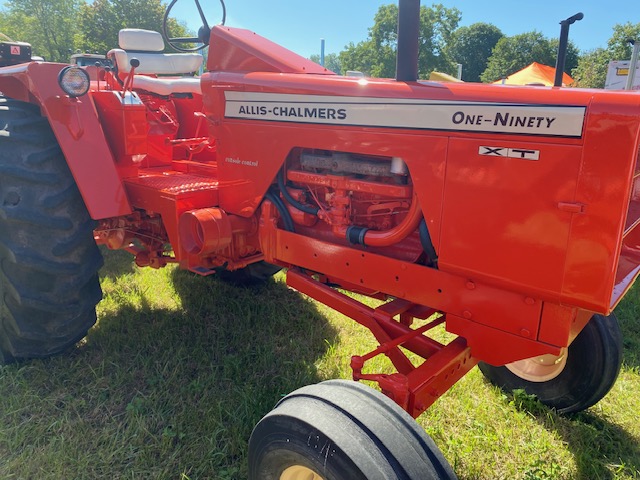

On the subject of rare, happened to see this feature on one of the tractors at Albert City.  I could only chuckle of mixing the past with the new for the times.  See if you can find what I'm talking about.

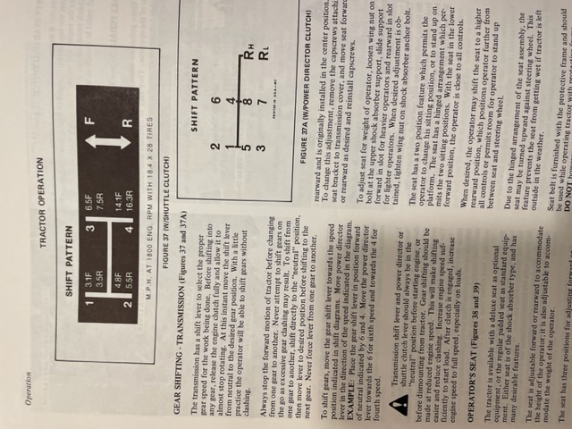

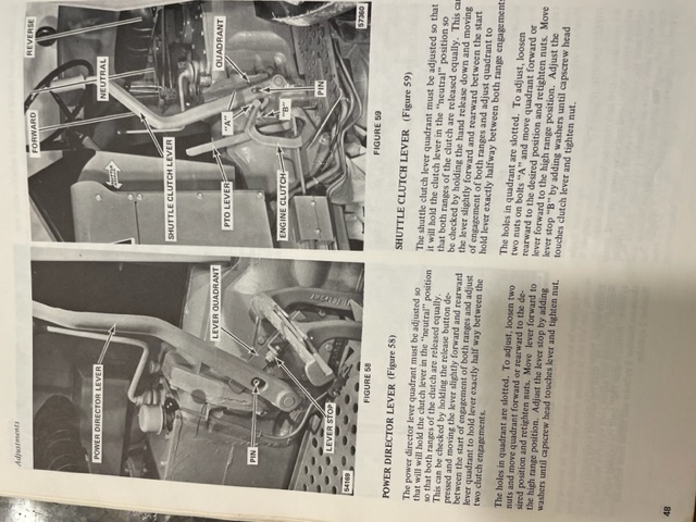

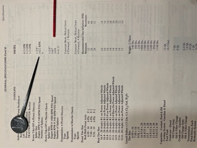

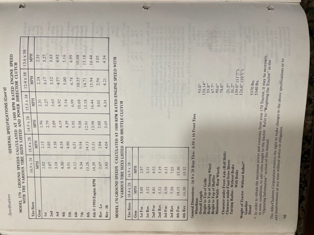

I have a 170 w/Shuttle with the dual PTO as Factory Installed at the factory.
>In Operator's Manual
YES, Reverse is FASTER!
1'st is fast enough, F or R
4th w/16.9x28.  F=13.30.  R=15.32

Belt Pulley

That XT has a belt pulley!Embarrassed

I have a NF OneNinety with a belt pulley from new. OneEighty and OneNinety belt pulleys have a 4" longer casting than the D series belt pulley. D Series will bolt on for looks. To add a belt pulley and have it functional, the tractor must have the internal gear and shifter. Snowman did you also notice the snap coupler and propane? Must have been Charlies tractor.

About like if you get a Deere tractor like a 4010/20 with slopped out shift linkage or the dash notched out to access the hidden 3rd reverse. That’ll get you out of the barn in a hurry!

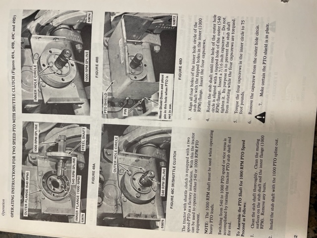

I’d like to see pictures of duel pto in 170.
Points: 22804
Post Options Post Options   Thanks (0) Thanks(0)   Quote DrAllis Quote  Post ReplyReply Direct Link To This Post Posted: 22 Aug 2023 at 12:48am
Looks just like a dual PTO in a 185. The speeds aren't a normal standard speed on a shuttle clutch tractor.

Hope this helps!   From Operator Manual 170 above 07500
I think the PTO speed is more constant with dual speed internal gearing.

Calvin, I did miss the snap coupler and propane.  Some of you guys really know who have the rare versions of tractors
