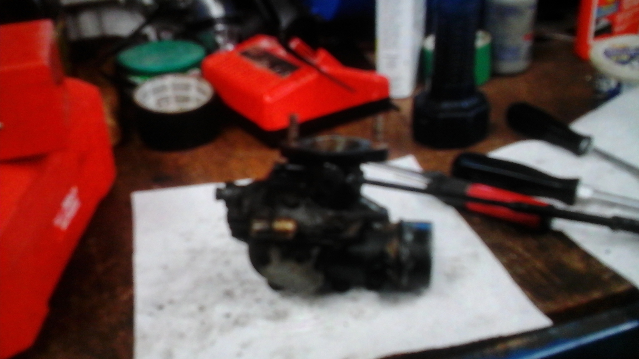

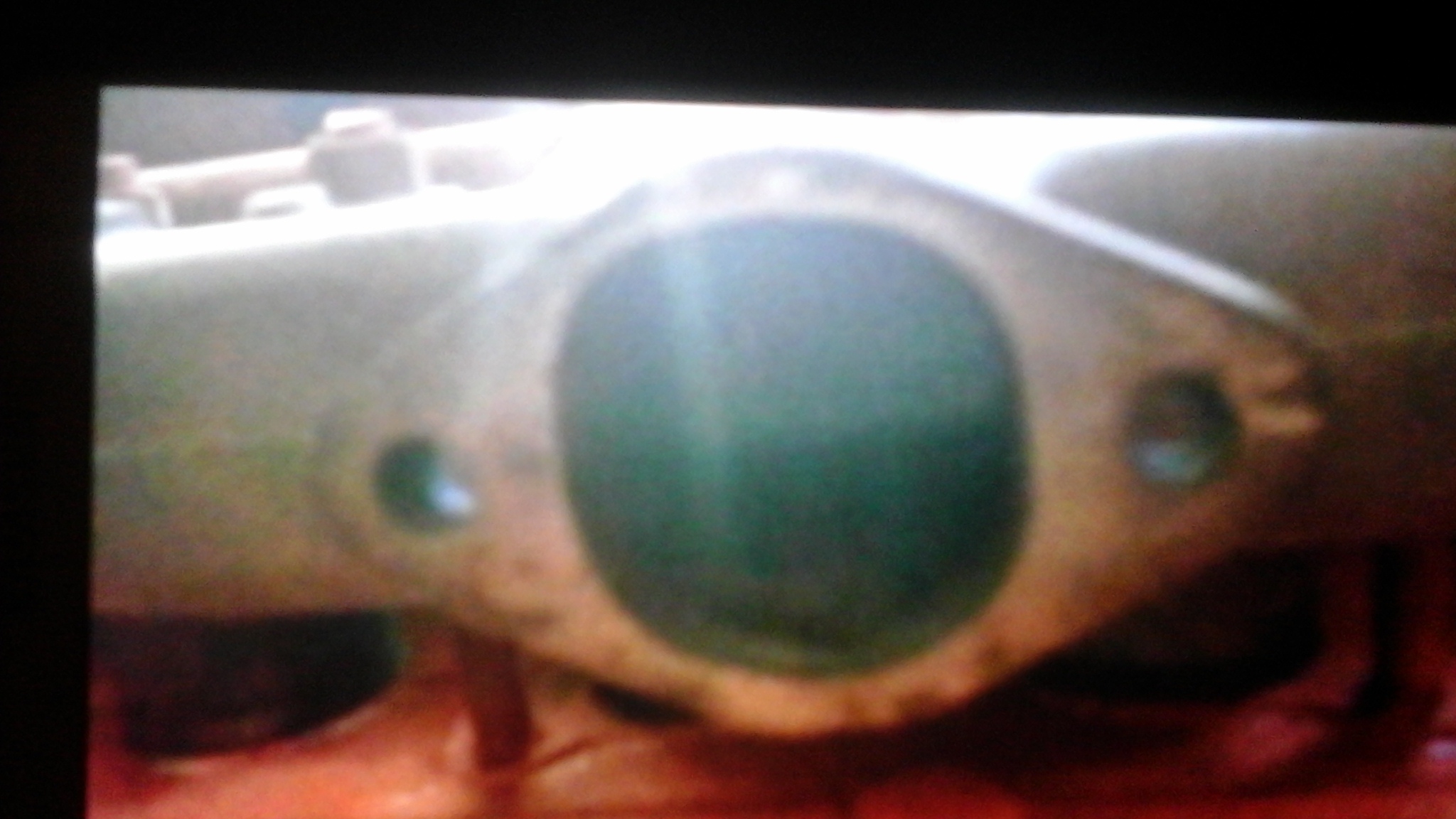

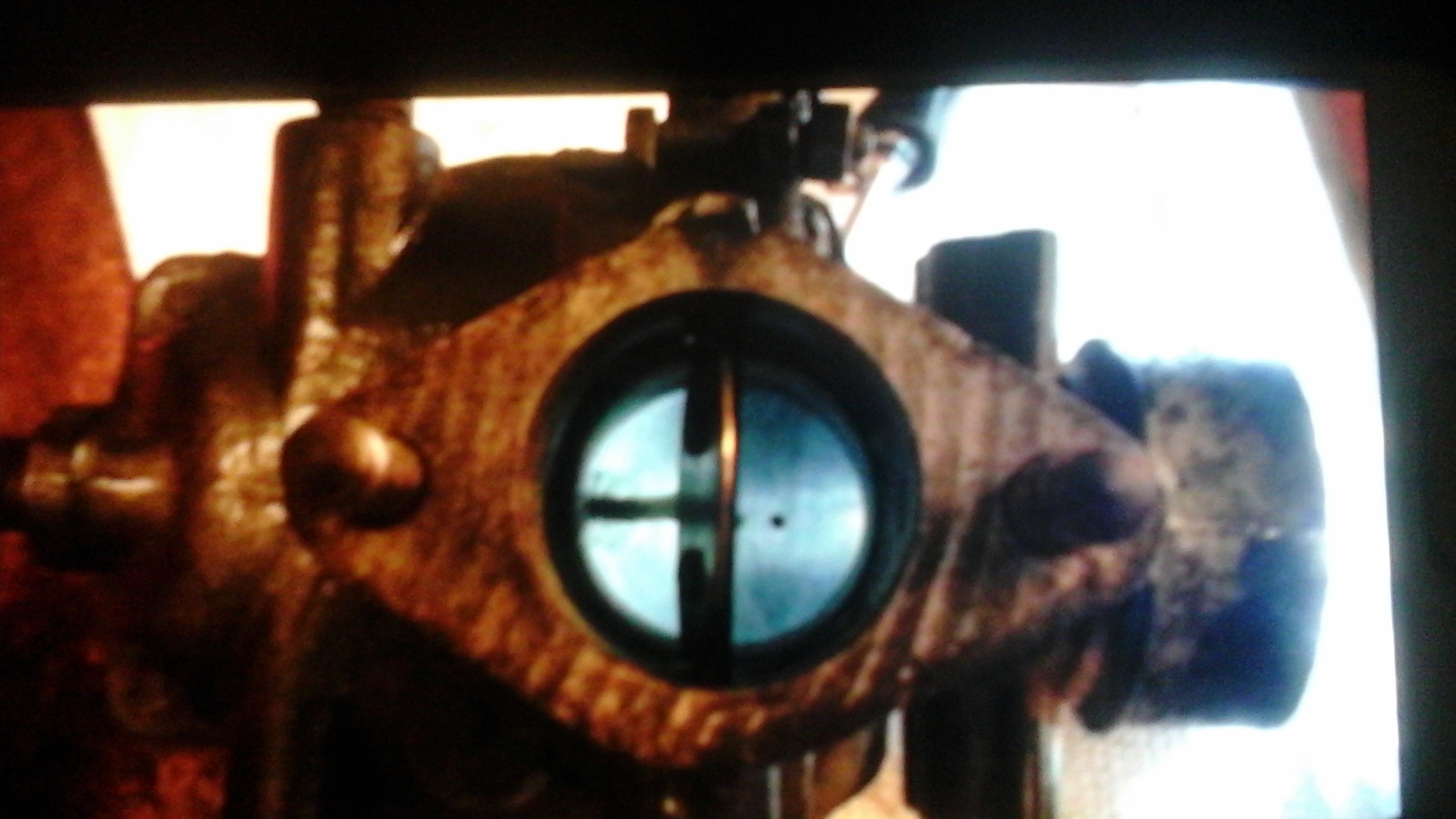

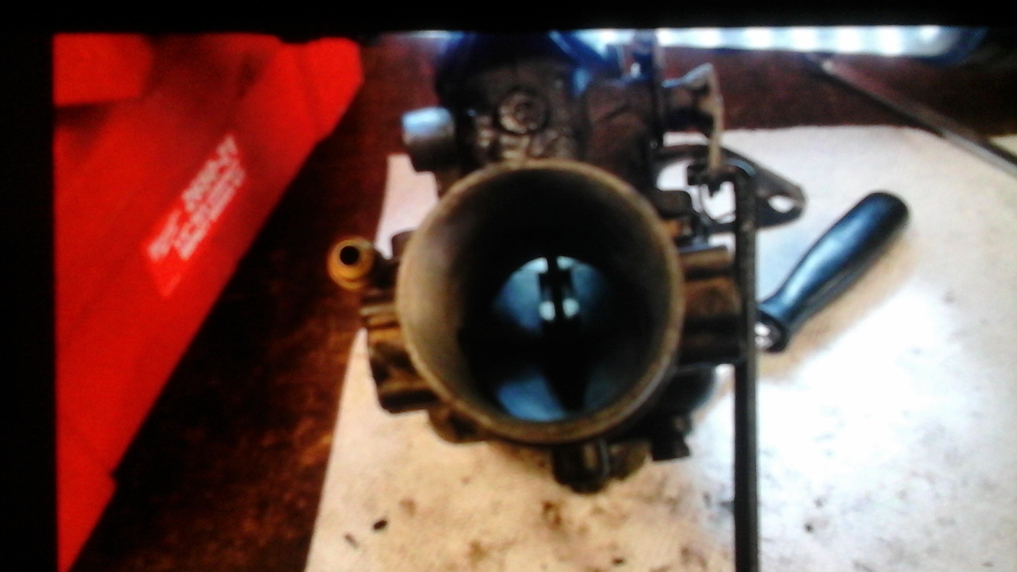

These r some pics of my carb and we're mounts to manifold
