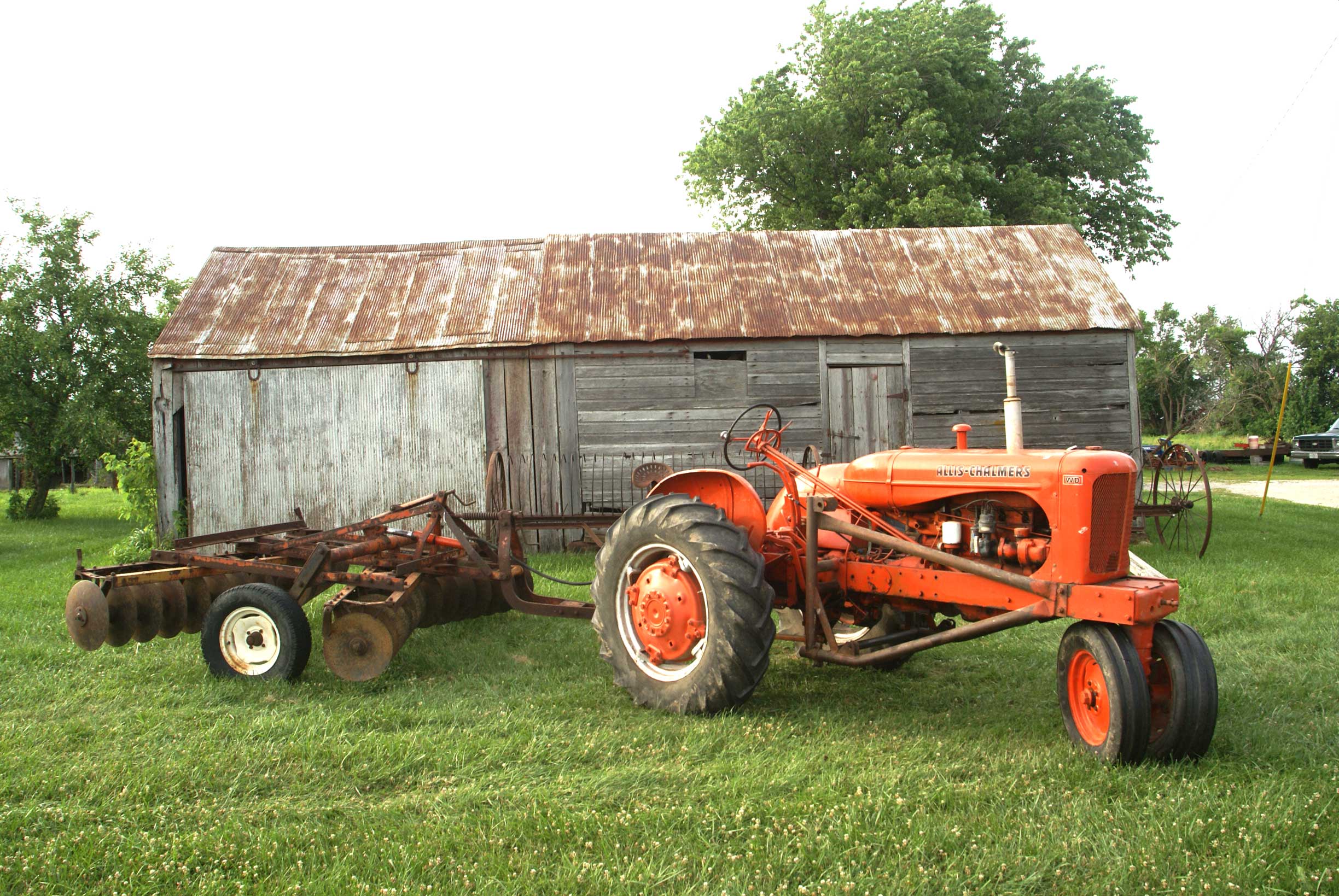

Here's a video of my "CA" pulling a model 20 8-1/2'' mounted disc with 16" blades.
 My "CA" puts out about 29hp.

I remember that day.  It was at Ted's AC Jamboree several (10?) years ago.
