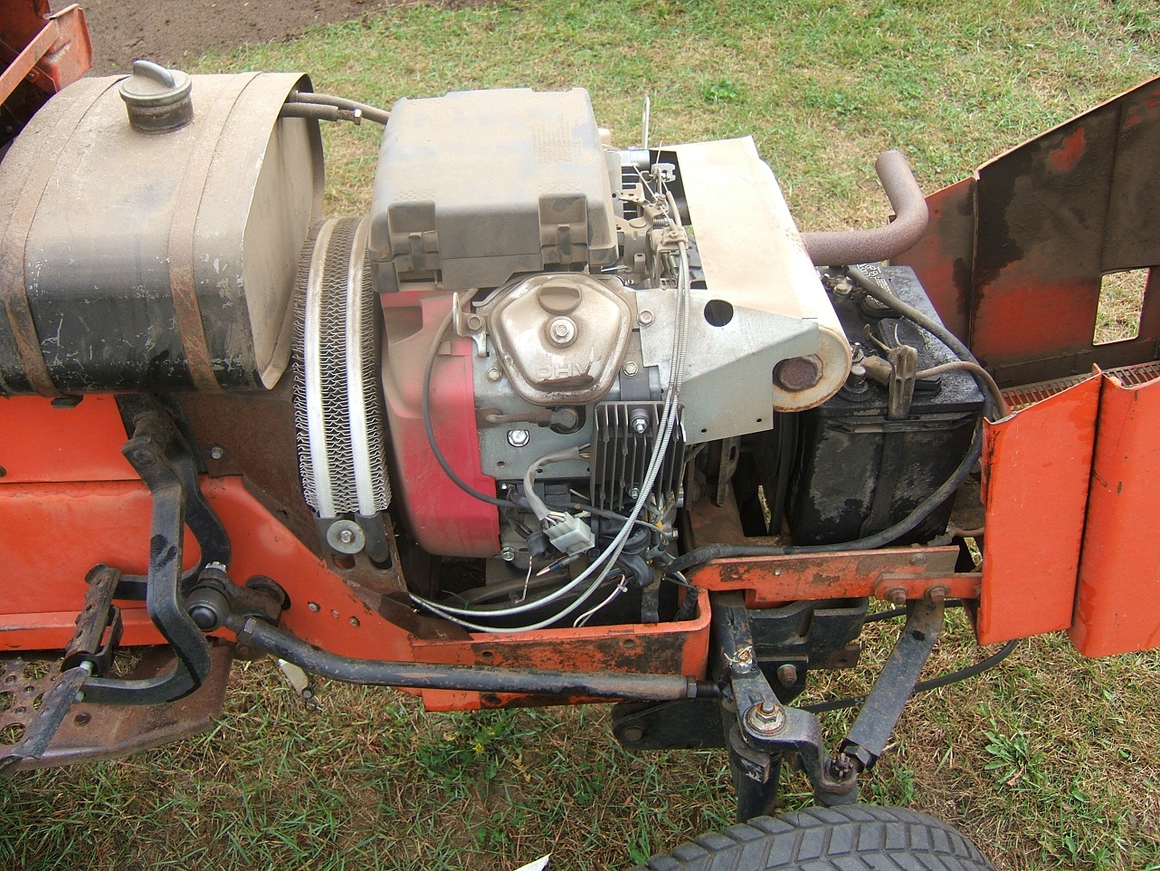

If you have a Honda engine in your 616-620 AC tractor, I have a question. What size is the PTO side of engine crankshaft? What size is driveline side?Are they the same as Onan engine? Thanks Tracy

My 24 hp was the same as the onan on the clutch side. The drive side had a spacer to adapt to the onan pulley. The spacer and motor mount plate are easy to make. Watch the exhaust. I would wrap it to try to keep heat off the battery. Mine got pretty warm but i did not cook it.

Fasstman, thanks for info. I was hoping someone would have pics of one being installed. Does anybody have a Briggs in one? Thanks Tracy

you can look at Dennis' post in this section to see the install of the Briggs
