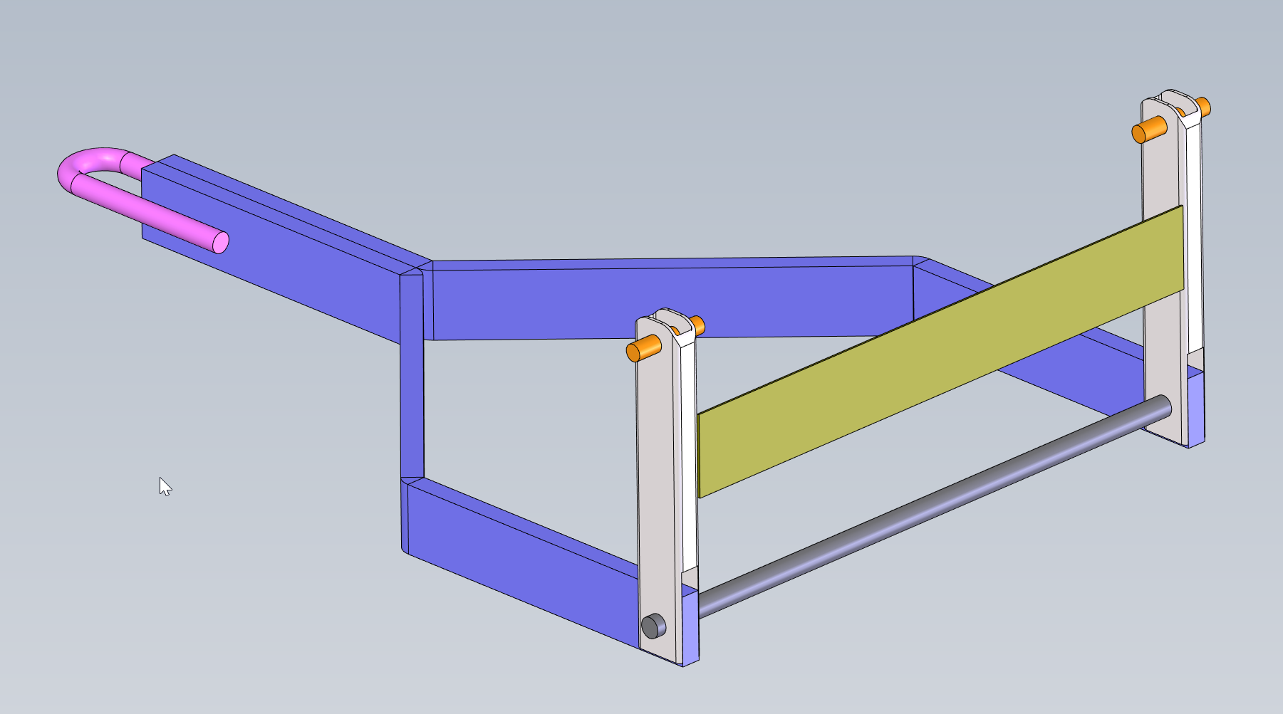

Something like this is what I'm thinking. None of the dimensions are figured, and the enigneering isn't done. I would the build a box to sit the tank on between the 3" x 3" tubes. The lift arms aren't adjustable, but not sure they would need to be.

With a slight modification, could put some hydraulic cylinder on it and the forks to make the forks levelable - wouldn't be self levelling like a 3 point. But if I really cared there would be options.

that should work OK.... The vertical bars dont have to adjust... but they have to pivot at both ends....
just realize that the "LIFT" is going to pivot on the front Bail hitch... so the back end of the tank is going to swing thru an arc as it raises... Not a big problem.... thats basically how all implements on the snap coupler work.
Nice drawing...... what program ? ..... part of your work/ job ?

that should work OK.... The vertical bars dont have to adjust... but they have to pivot at both ends....Nice drawing...... what program ? ..... part of your work/ job ?
I'll also probably add plates in an "X" shape between the vertical arms to stop it swinging left and right. My grader and cultivator do that.
SOLIDWORKS. I'm an ME in education and detailing engineer by trade. Play farmer on the weekends.

Rev 2 layout. I'm thinking the lower bar should be offset from the upper bar, so that when the lift is down with the forks on the fork tynes would be angled to parallel to the ground. The height of the top tyne carrier will need to be figured so that when the lift is all the way down, the tynes will be on the ground. Which may vary depending on the tynes used.
I used round bar on the bottom, because I'm thinking with a little modification of the layout you could adapt a universal skid steer connector to fit on this, with a couple hydraulic cylinders to control the pitch.

Got around to making a drawing. Anybody think this will work?
The 1/4" holes in item 5 are for washers and pins to hold the lift arms in the right place - may or may not be needed.
Very little welding, but I would probably need someone to do the bending - not sure how to get around that.
It *should* be able to go from all the way down - to touching the ground so the lift arms can pick it right up from the ground - to all the way up. On a D15 at least. Struggled to get it to avoid the pumpkin - but I will hopefully be building this in the next month or so.
With little modification to the 1" bar should be able to get a skid steer universal quick attach to work on it - maybe even with some hydraulics.

From a Welders point of view... I would not bend anything.. Cut and weld all the corners......... guess it depends on access to a bender, and you welding ability..
do the uprights #3 rotate with respect to the frame #1 ? .... what locks them together.
Welding ability is yet to be determined - I figured it'd be easier to find someone that could bend them while I wait, for cheaper, than I could find someone to weld the quality needed at the angles. Where the flats meet together there's a lot of space and a lot of weld I'm not too worried about sucking.
Yes they rotate. They are "locked" together by the 1" rod (5) going through them. Putting pins and washers on the outside of #3 to hold it together. There may need to be pins on the inside to stop the beams (1) from pinching together - but I don't think I'll need them.
