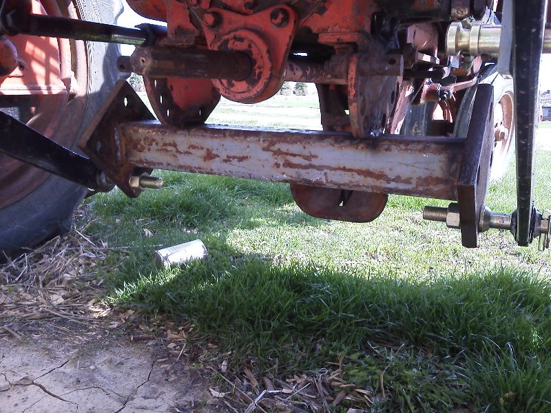

Here it is:

Originally posted by redline redline wrote:
I just took this part off of my forklift in order to change to a sideshift setup. Would something like this do you any good?
The forks are 36" IIRC. It could be bought pretty reasonably compared to buying forks by themselves. This is the backside of it.
I used a setup almost exactly like you have there, except mine used 48" forks, and the base wasn't quite as heavy. I added tabs to attach the three point lift to, and made an instant forklift out of it. The whole thing is mounted on a weird colored tractor, so I don't think I am going to post any pictures of it, unless someone really wants to see it.
Capacity is in excess of 2800 pounds, because that is the heaviest thing I have lifted that I knew what it weighed.

David- only thing wierder than the color of your tractor, is it's wheels...
That carriage face appears to have been fitted with a rotating hub to spin and dump a materials hopper, barrel clamp, or pallet. Having shaft-mounted forks AND that big steel plate face makes it substantially heavier than the common slide-on hanging forks... so there's lots of weight there that swallow up 3-point capacity rather quickly.
There are many instances where guys will take the entire mast off a small forklift, put 3-point pins and a hydraulic hose on it, and use it as-is, and they work... some even use a hydraulic top-link to give tilt, however, the masts are really heavy, so it takes a Category 3 tractor to make them work well. The other problems one runs into, is that the 3-point hardware may be strong enough to lift the mast, but not strong enough to withstand the forces generated when a load is lifted really high... and of course, the machine's footprint and counterweight is fine for lifting the load a few inches off the ground, but entirely insufficent for elevating it more than a few feet off the ground.
Not that the OP avertised any intention to do so, I'm just pointing out that the physics of going that route become very, very complicated, and as such, very dangerous... but using a nice light fork setup directly on the 3-point is incredibly handy. My D17 and WD move things around in places and ways that my Hyster and Clark could NEVER do...

If your lower wishbone-type setup doesn't pan out, here's how I did it on my WD and 17:
DaveKamp View Drop Down
Joined: 12 Apr 2010
Location: LeClaire, Ia
Points: 6036
Post Options Post Options   Thanks (0) Thanks(0)   Quote DaveKamp Quote  Post ReplyReply Direct Link To This Post Posted: 22 Jan 2015 at 8:57pm
and two more of what's underneath:
What I did here, was take the two lower brackets off, placed them in the mill, and mowed off flat and clean to suit the 4" square tube. That's 1/2" wall tubing, and the end plates are 3/4" thick. I welded the end plates onto the tubing while it was sitting on my welding table, then bolted the brackets to the tractor, lifted the square tubing into position with hydraulic jack, applied plenty of pressure, then tack-welded the brackets in place, released pressure, unbolted the assembly and moved it to the welding table, and finished the beads on both sides.
Original incarnation is on my D17, and in that one, I actually milled a 3/8" recess in those bottom brackets, then did same welding process, but on this one, I didn't think it all that necessary, considering the amount of liquid metal applied, and the intentions I had for the assembly... bolts would fail before my welds ever did.

With that set up are you no longer able to use the factory drawbar? If you can't have you ever had a situation where it would have been nice to have it?
About how long are the links from the upper to lower lift arms on your set up?
I had also thought of making some type of crane like that for mine but that would pivot (by hand)and could also be mounted on my truck.
For the most part I plan to/have been using my tractor for moving logs (I have a sawmill) and moving snow.  But I don't want to do anything to it now that will limit my options in the future. Which is part of the reason I set my three point up the way I did.  I wanted to still be able to use the drawbar and be able to remove it with or without the three point, also wanted to be able to go back to the factory set up incase I get any allis attachments and I wanted it to attach to the snap coupler so the drawbar control would still work.  If the three point and forks work well I plan to take the loader off unless it is needed for weight.
