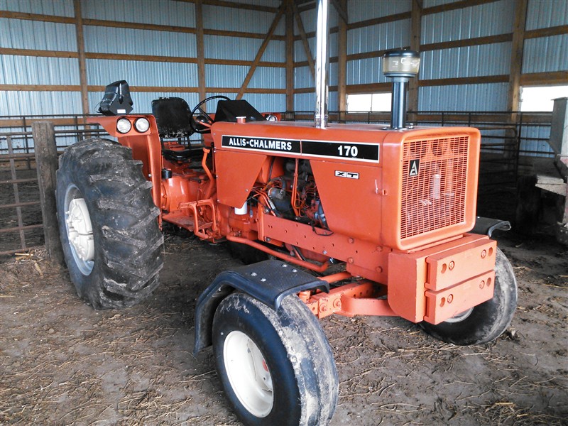

Nathan (SD) View Drop Down
Location: Day County SD
Points: 1289
Post Options Post Options   Thanks (0) Thanks(0)   Quote Nathan (SD) Quote  Post ReplyReply Direct Link To This Post Posted: 09 May 2017 at 12:35am
I agree. Just use the whole 170.
Points: 1289
Post Options Post Options   Thanks (0) Thanks(0)   Quote Nathan (SD) Quote  Post ReplyReply Direct Link To This Post Posted: 09 May 2017 at 10:22am
where did you find them fenders Nathan?
I just found this picture online. I don't know who owns it.
