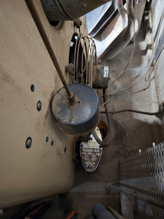

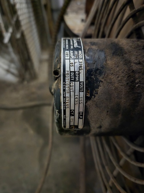

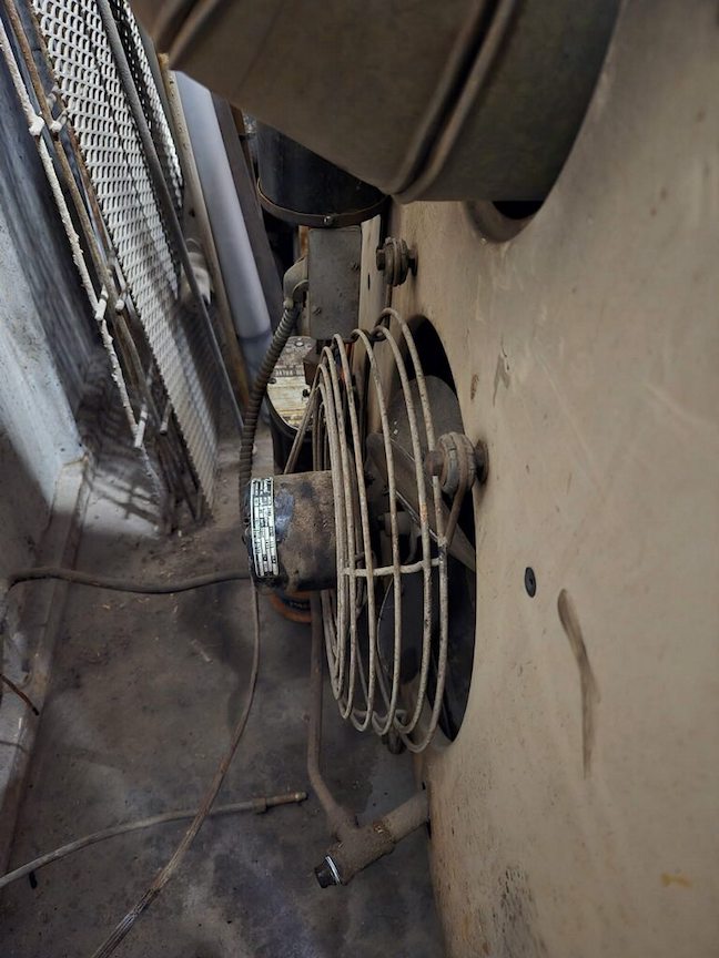

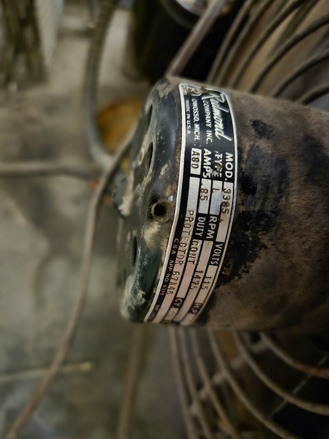

Wired up motor only. Ran full speed for about 50min then started slowing down. It kept dropping rpm and at about an hour run time it just died. temp was 180. Took it apart. Brushless. No sign of touching fields. Has a little fan on shaft end internally. It spun freely on motor shaft. Got things pressed apart to get to little fan mounting sleeve and applied red loctite. Will reassemble and try again. Find it hard to believe the loose internal fan is the problem. Will see. Otherwise a small pedestal fan on floor behind stove might do the trick.

Looking at picks, forced draft burner fan, had similar in Grandma’s house on coal burner converted to Gas. They defeated it for NG as was not needed as would have been for Oil or Coal. And Yes that little motor winding fan spinning on the shaft would be a major problem, as much as a Alternator fan is as needed. Has to pull air across windings where big fan pulls air around entire motor.
