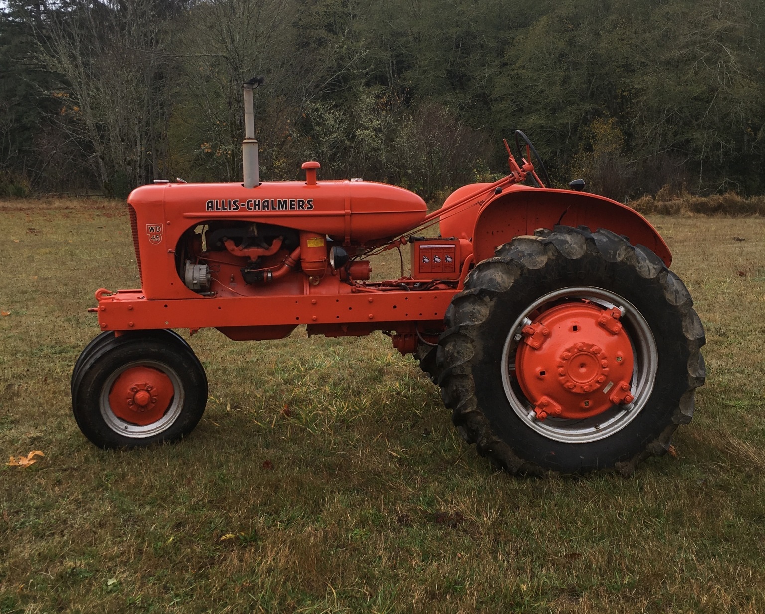

Post Options Post Options   Thanks (0) Thanks(0)   Quote Allis Wd45 Quote  Post ReplyReply Direct Link To This Post Posted: 20 Nov 2017 at 9:40pm
Thanks for the quick reply's here is a picture of my Wd45.

Post Options Post Options   Thanks (0) Thanks(0)   Quote Gary Quote  Post ReplyReply Direct Link To This Post Posted: 21 Nov 2017 at 4:03am
Nice looking WD-45.
You need to check the Power Shift rear wheel eccentrics.
Hard to tell in the picture - but it appears they are not turned all the way to the 'locked' position.
Gary

Post Options Post Options   Thanks (0) Thanks(0)   Quote Ted J Quote  Post ReplyReply Direct Link To This Post Posted: 21 Nov 2017 at 7:40am
Like Gary says, your eccentrics are NOT locked down.  That puts TOO much stress on the lock and you will probably shear it off.

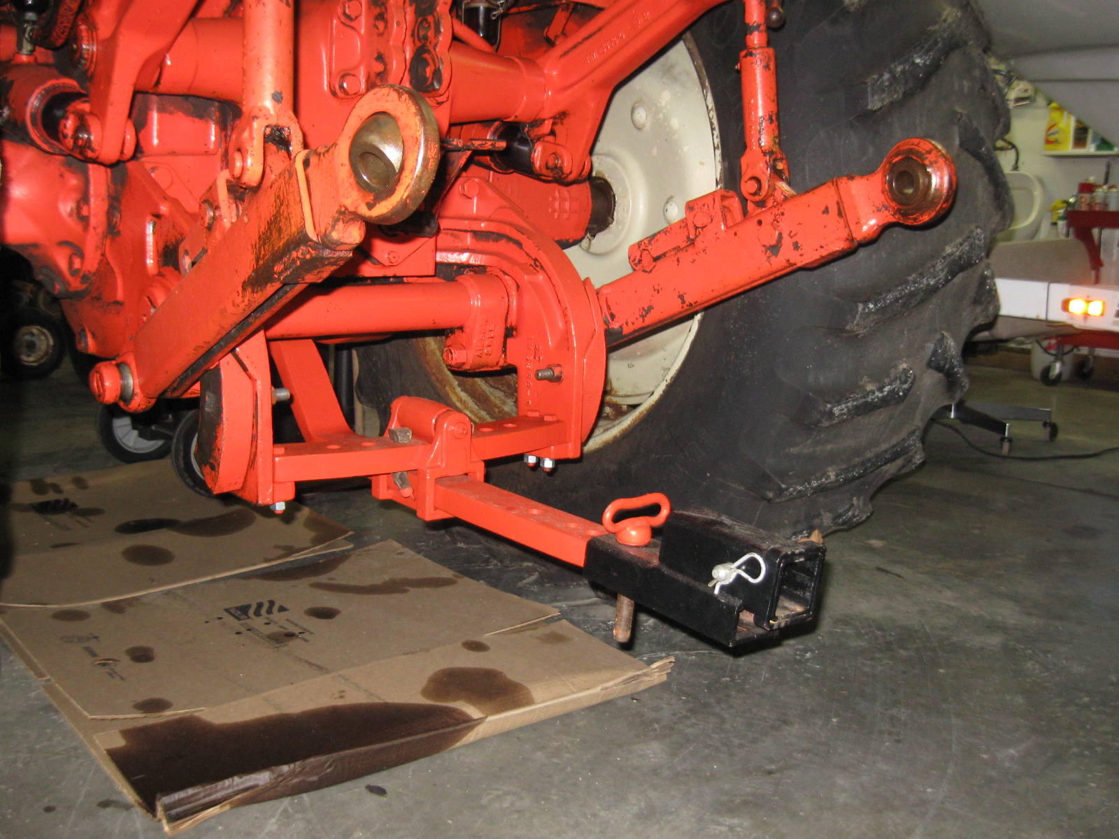

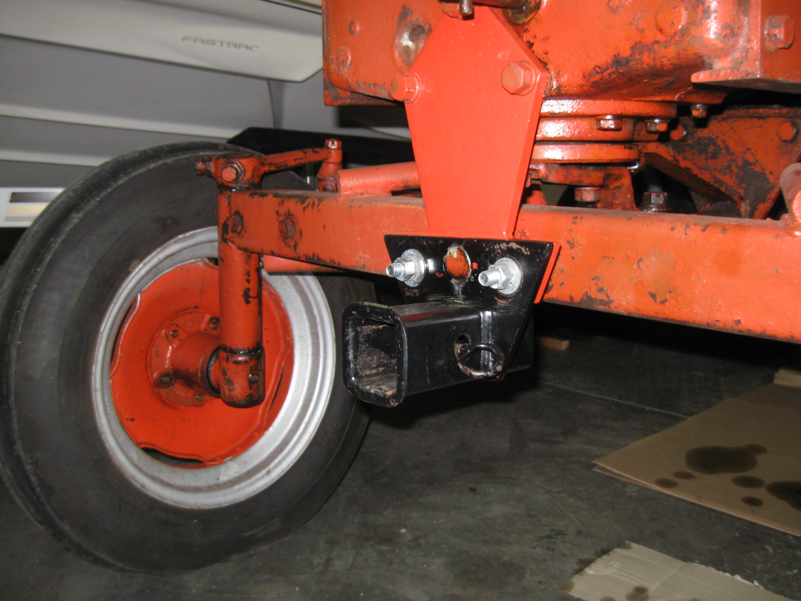

Like Jay I put a 2" receiver on the drawbar of my WD45 only I just bolted it to the drawbar rather than weld it.  Bought it at Harbor Freight.  Also bought the 3-ball insert from there also.  Got a H-F near you?  If not, sign up for their emails and you will get a flyer with coupons once or twice a month.  The receiver and the 3-ball hitch go on sale quite often and the shipping is only $5 for EVERYTHING that comes in that box.  I've gotta put one on my CA now too.  Works GREAT,,,,,,, HTH

Post Options Post Options   Thanks (0) Thanks(0)   Quote john(MI) Quote  Post ReplyReply Direct Link To This Post Posted: 21 Nov 2017 at 9:17am
Naw, them eccentrics are fine! Wink
If you ever need a replacement I have 8 for sale, plus two centers if one should get messed up!  Big smile
When you tighten them, start with the one that is at the lowest.then the next two lowest and then the top one.  At least that's how I did mine and they seem to work fine!  I have a 1/2" breaker bar that is about 2 1/2' long,  works great.

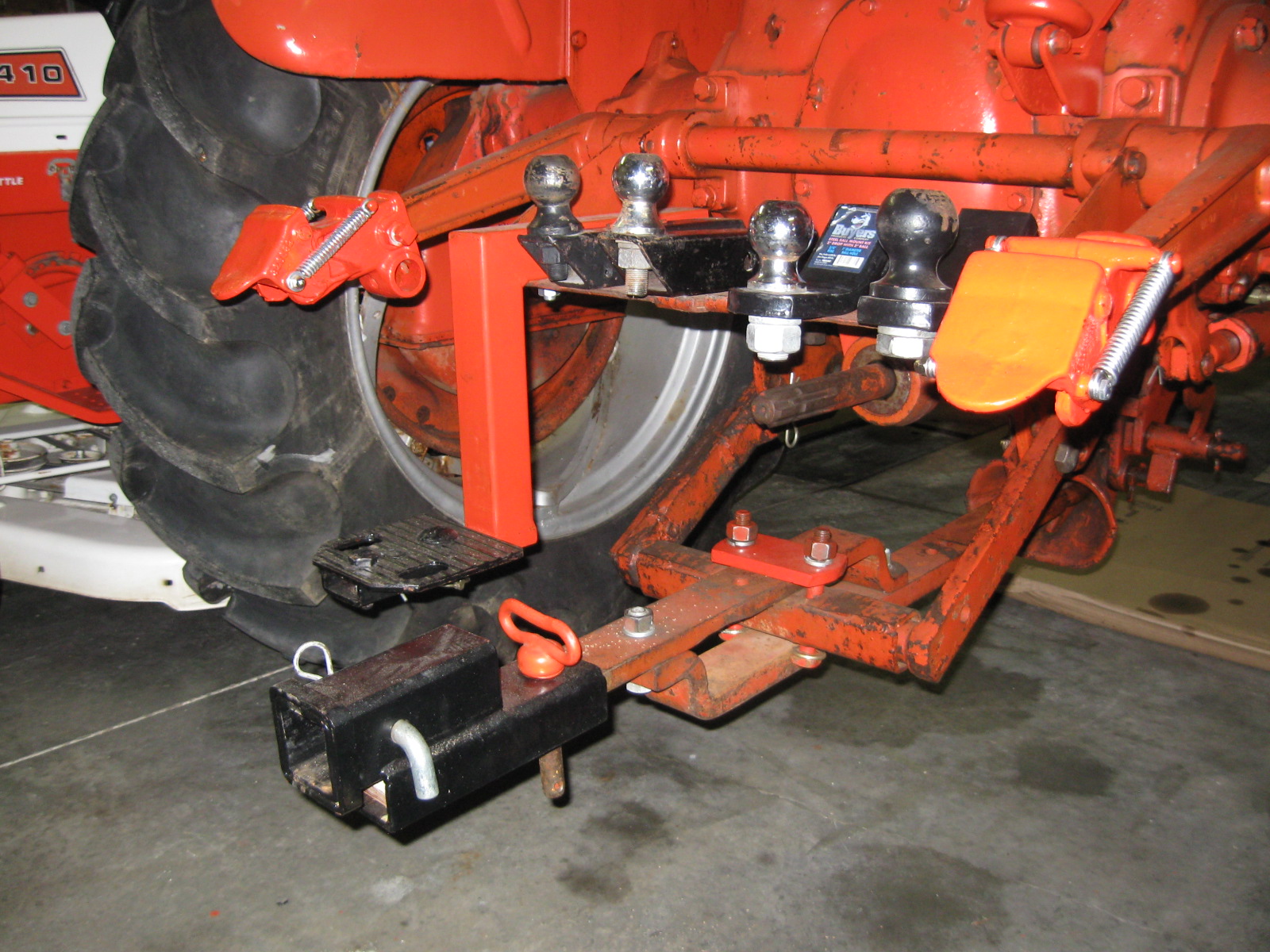

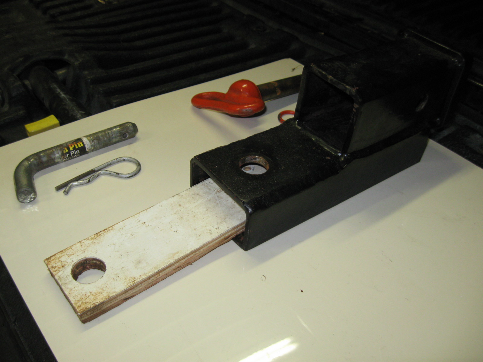

This setup and combination of receivers works great on my 190XP, WD 35/45, and the 'G'. It only takes a few moments to switch from one to the other. The front mount, on the WD, has to be switched to the G by moving the bolt-on backer plate. Inexpensive to make and flexible. Sorry if the sizing is too big. Ross

Ross D. I like your setup and I might have to build that in the future but I think for now we’re going to cut the shank off of a 2 5/16” ball and weld a bolt on that will fit the drawbar.

Post Options Post Options   Thanks (0) Thanks(0)   Quote Allis Wd45 Quote  Post ReplyReply Direct Link To This Post Posted: 21 Nov 2017 at 3:20pm
Thanks for mentioning the eccentrics they were not locked. Could any damage have happened?
Points: 18943
Post Options Post Options   Thanks (0) Thanks(0)   Quote Ted J Quote  Post ReplyReply Direct Link To This Post Posted: 21 Nov 2017 at 8:10pm
Not much damage could have happened I don't think.  But like I said, it puts TOO much stress on the lock and you will probably shear it off.  Could also swing back and forth and the eccentrics could get really stuck on the rails.  I've never seen it happen, but a rail could break off.
WORST thing is the sway of the tires COULD THROW YOU OFF the tractor and under it.  That HAS HAPPENED.
It's a good practice to once a year take the eccentrics loose and move the rims and then put them back again, starting at the bottom and work toward the top.  That way when you really HAVE to move them, it's pretty easy.  Otherwise they WILL rust in place!!  I KNOW!!

Post Options Post Options   Thanks (0) Thanks(0)   Quote Allis Wd45 Quote  Post ReplyReply Direct Link To This Post Posted: 21 Nov 2017 at 8:17pm
That makes sense when I drive it in road gear last weekend it had a pretty bad sway to it but that’s the first time I’ve drove it in road gear that far.

Love that adapter, will be building one of those this winter.
